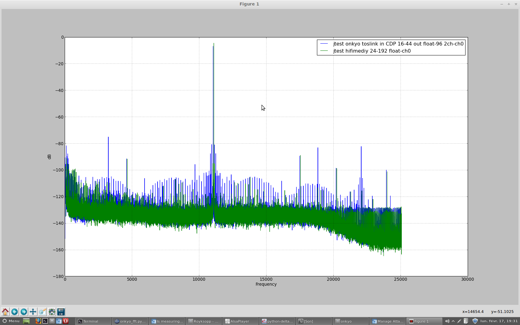

But the digital part is a huge steaming cow dung.
It is crap. In Bold.
I mean, they use no master clock, DAC MCK comes either from HDMI or from a CS43xx SPDIF receiver which is the worst, digital signal routing is crap, the DAC board layout is crap, no ground plane, no decoupling, mezzanined above a noisy DSP board, etc, etc. In the last 10-20 years digital audio has made lots of progress, and they basically ignored all this and got everything wrong. None of the digital inputs (including HDMI) produce good sound.
A $30 Hifimediy DAC with a $1 ES9023 inside sounds wayyyy better than this TXNR905 40kg beast.

I second Peufeu's findings. Lots of sidebands (also audible) when measuring digital in - line out. Btw, when prior to purchase asking Onkyo about more detailed distortion specs I got the answer that distortion spec is line in - speaker out. In other words, DA conversion distortion could be anything. Peufeu shows the garbage!

The hairy FFT above is from Onkyo TX NR 905 but the DACs seem similar between models.
A top of the range receiver with jitter products above -80dB, FFS. It is worse than a laptop sound chip.
