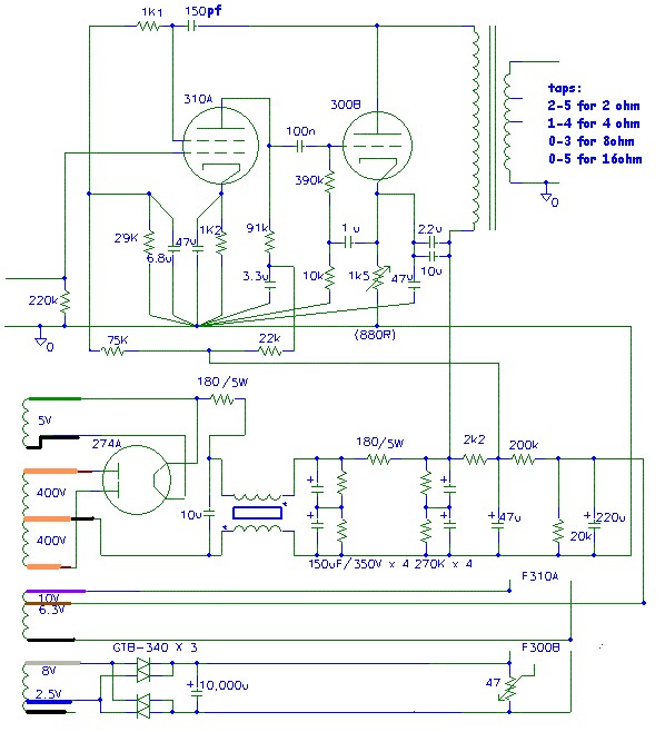

Hi jdrouin,
Have you seen Thorsten’s version? I attached the schema (was a kit amp over a decade ago).. I’m not sure though if lowering the heater voltage for the 6C6 is the only change needed since the design had a NOS 310A in mind.. I’m also wondering if one can change the 274A rectifier to a more common 5R4G would be feasible with a similar PSU arrangement, with only some adjustments to the dropper resistors. There are Chinese reproductions of the WE driver pentode and rectifier made these days, but I’m not sure about their reliability.

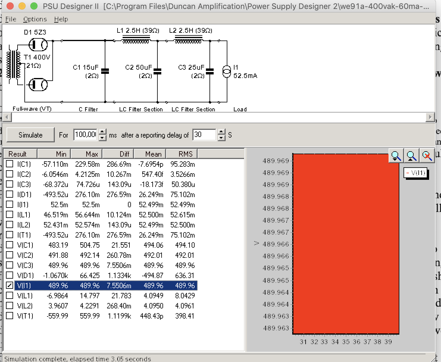

On PSUDII I've been playing around with power supply filters. Looks like I should be able to get to that op point with a CLCLC filter using two Hammond 159T chokes (2.5H, DCR = 39 ohm measured by my Klein DMM) in each channel. With caps at 15uF, 50uF, and 25uF, simulated ripple is 7mV, which should be pretty negligible considering the nearly 500V HT supply and then the step-down through the OPT.
What's the purpose of capacitors C2 (1uF) and C4 (20uF) that go from the bottom of the grid leak resistors to the cathodes? Local feedback? A shunt to circumvent internal Miller effect?
Reattaching my redraw of the original schematic for convenience.
jdrouin,
C4 is nothing more than a cathode bypass cap that is across the self bias resistor. You duplicated the WE drawing that drew the return sideways to the grid resistor lead that is going to ground, instead of drawing C4 direct to ground. Looks different, but it is the same at audio frequencies.
C2, your guess is as good as anybody else's. And so is the 10k Ohm resistor that it bypasses.
By the way, unless you are planning on using a crystal phono cartridge as the signal source, you need to use a grid leak resistor lower than 2.2 Meg Ohm for the input tube. 2.2 Meg Ohm, and old tubes may cause the total bias voltage to be anything that it wants to be. Very un-necesary when you have a cathode self bias resistor.
Oh, . . . another signal source that might need a 2.2 Meg Ohm resistor is a film projector that has a photo electric tube to drive audio signal into the input tube.
Actually, the 6C6 tube was designed for multiple applications, including as a grid leak detector; a 2.2 Meg Ohm grid resistor and No self bias resistor would apply to that kind of circuit. That application was used in AM radio receivers to take the modulated RF and convert it to the audio signal.
Any modern signal source that can not drive a 100k Ohm grid resistor needs to be replaced with another modern signal source.
And you can toss out R3 and R8, they do nothing. They may have originally been used as negative feedback nodes, but your schematic does not have negative feedback.

Ah, right. Good eyes on C4. And yes, I was probably just not going to bother with R3 and R8. I might also leave out C2, which isn't in the Sound Practices variant, though I can always breadboard it both ways just to see.
I think the 10K resistor below the 390K grid leak on the 300B is related to the ammeter, which isn't depicted in this drawing -- so that's also a candidate for removal.
Also left out of the drawing is the first 6C6, which picks up the optical sound track from early sound film, since there's no need for two gain stages.
I'll probably replace that 2.2Meg grid leak on the 6C6 with something like 100K. This will be driven by a line preamp, my clone of the Wright WLA-12. In fact, the WLA12 uses the same topology as the voltage amp/cathode follower stage of the WPA 3.5 power amp, which drives a 47K grid leak resistor on the 2A3. So maybe it would be at home with a 47K grid leak on the 6C6 of this WE91A.
jdrouin,
The cathode cap across the 880ohm is too small (16uf) which reduces the 300B gain at low freq. Remember high value cap is bulky and expensive back then and the system will only need to be flat to 80hz. The 1uf bypassing 10k + 880r//16uf act as a dead short between the grid leak to 300b cathode. Around 16hz which is 5T below 80hz. The added bonus is you can use a good quality 1uf cap as compare to high value cathode bypass.
I tends to agree to some practical level that if you ditch all the design principle of 91 amp then it’s your own amp instead. The circuitry, the component values, the freq limited high insertion lost opt all play a big part. And the last thing is, if you will need western electric 300B to know what it’s all about.

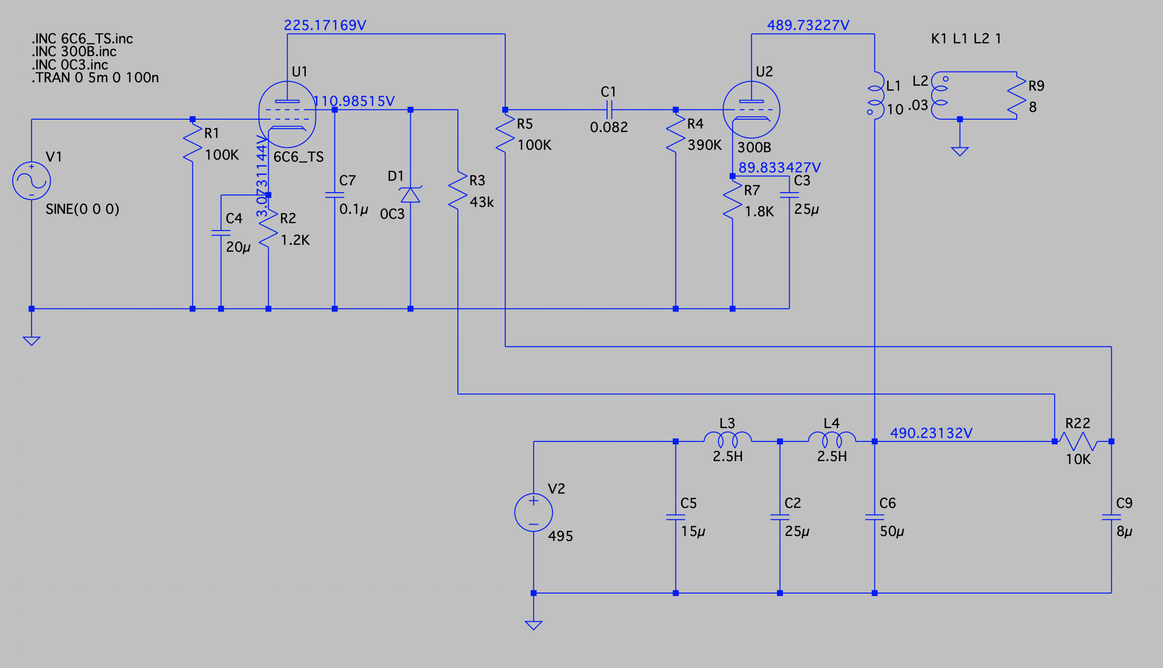

OK, after focusing on cabinetry skills for speaker building for a few months, I'm coming back to this project. I decided to simulate a first iteration of a slightly modified WE91A circuit, incorporating some of the suggestions above, with 6C6 regulated by a 0C3. The sim voltages and current check out pretty well.
In the attached screenshot, the 0C3 appears as a Zener diode because that was the model I adopted from the Spice thread.
My one question is -- Do I risk damaging or destroying the 6C6 by putting a gas regulator on the screen?
A builder who does not participate on this forum cautioned me against putting a 0C3 on the 6C6 screen, because the screen has a max current of 0.5mA and the 0C3 requires minimum 5mA to start. I used R25 to set the 0C3 at 140V & 8mA. The sim has about 0.25mA on the 6C6 screen whether or not the 0C3 is connected.
No one in this thread has cautioned me so far but I wanted to double check before I breadboard it.
The large cap in parallel with a gas tube is likely to oscillate.
IMHO, the 0.5mA Ig2 is reasonably steady and uncritical. A divider with 5mA of current is PLENTY stable. It's only audio, not a radar pulse amplifier.
Or is the idea "glow"? Then leave R25=35k, remove R26 and C10. There may be hash from the gas tube into the screen. Then _I_ would fall back to a simple R-R-C divider for screen, leave the gas tube for glow.

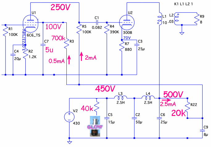

Oh right, thanks! Forgot about the need for a maximum 0.1uF bypass cap on the 0C3. I've got a 0.1uF PIO and a 0.0625uF film cap I can try there.
Here's a modified version taking PRRs suggestions into account.
Part of the reason for using VR tubes is to show off the glow. As you note, VR regulation is not really advantageous in the circuit as shown. However, I'm considering running the 300Bs at 400Vak/50mA, which will require a B+ of around 500V. So I thought a VR tube could be a way to keep the proper screen voltage on the 6C6 without a super large resistor there causing sag.
And . . . Swap the capacitors that are in C2 and C6. C2, 50uF, put it in the C6 spot. C6, 25uF, put it in the C2 spot. Now . . .
50uF (now in the C6 spot) has a capacitive reactance of 159 Ohms at 20Hz. That is 159 Ohms in series with the impedance of L1 Primary. If L1 primary is 3000 Ohms, that is in series with 159 Ohms of 50uF. ~ 5% At 40 Hz, it is less than 2.5%.
If L1 primary is 3000 Ohms, that is in series with 318 Ohms of 25uf (what is on your schematic now). The B+ impedance of 318 Ohms is over 10% of the L1 primary impedance AT 20Hz. At 40 Hz, 25uF is ~ 5% of L1 primary impedance.
I'm just sayin'.
And yes, I too have used a gas regulator tube and a resistor just to get the glow. I used a 150V OD3 for a nice purple glow.
I'm just sayin'.

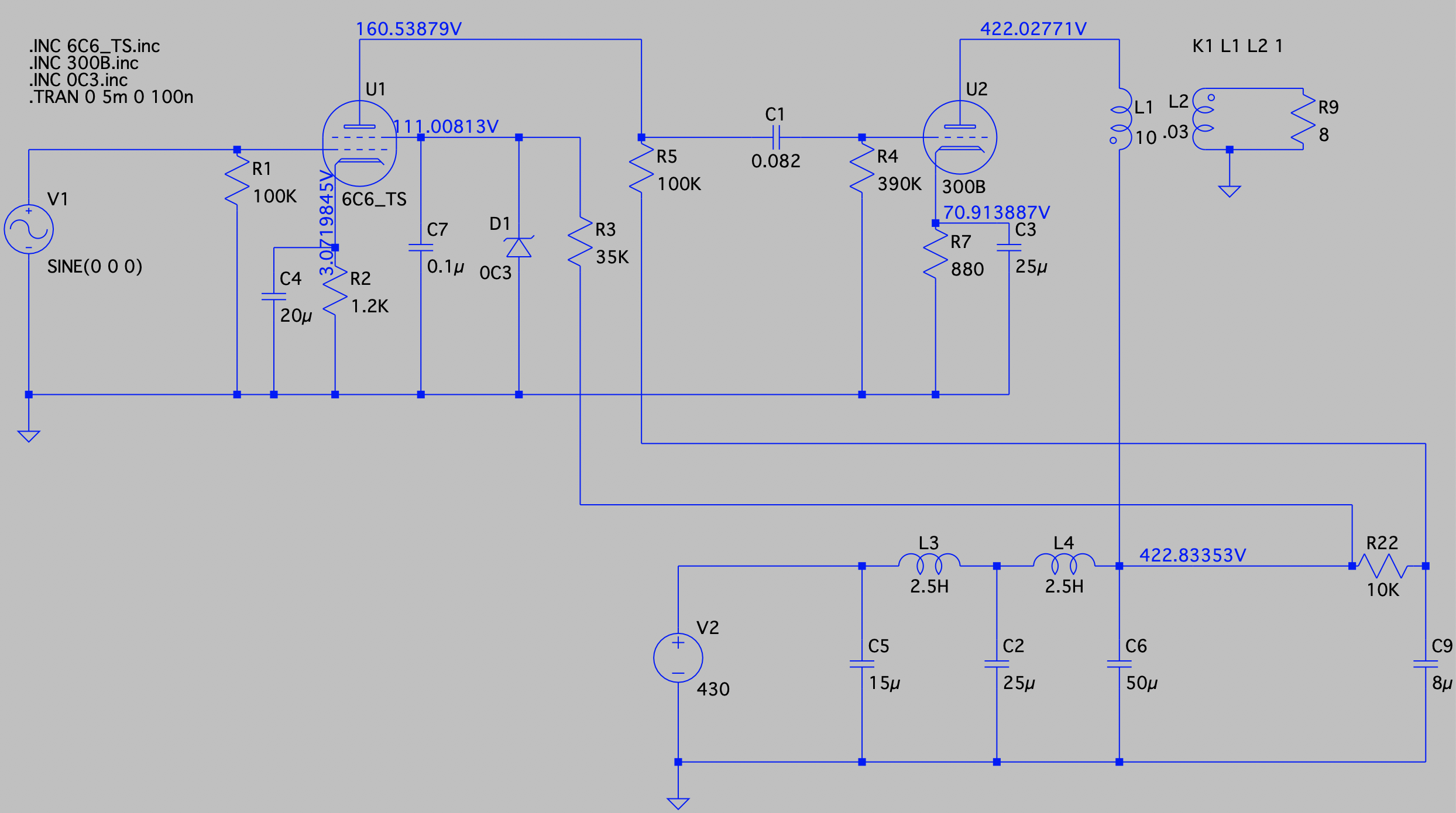

The original schematic has 150V on the 6C6 plate. The 134V is just what happened when I changed the sim. I didn't do anything beyond that at that point but on the breadboard I would definitely tweak to give it more voltage.The 300 needs a lot of drive. The 6C6 can take a lot more than 134V. Why starve it?
Thanks for the suggested edits to the schemo. I love the glow graphic! 🙂 Would that 700K resistor on the 6C6 screen be likely to cause sag or other issues?
6A3Summer: thanks for the suggestion on PS cap order. Forgive the newbie question, but are you suggesting those changes for the sake of low frequency response? I just wasn't sure what your considerations were aimed at. My PS design has so far been limited to ripple reduction, following the guide available at diyaudioprojects.com, and not other factors, so it's time to read more thorough material on this.

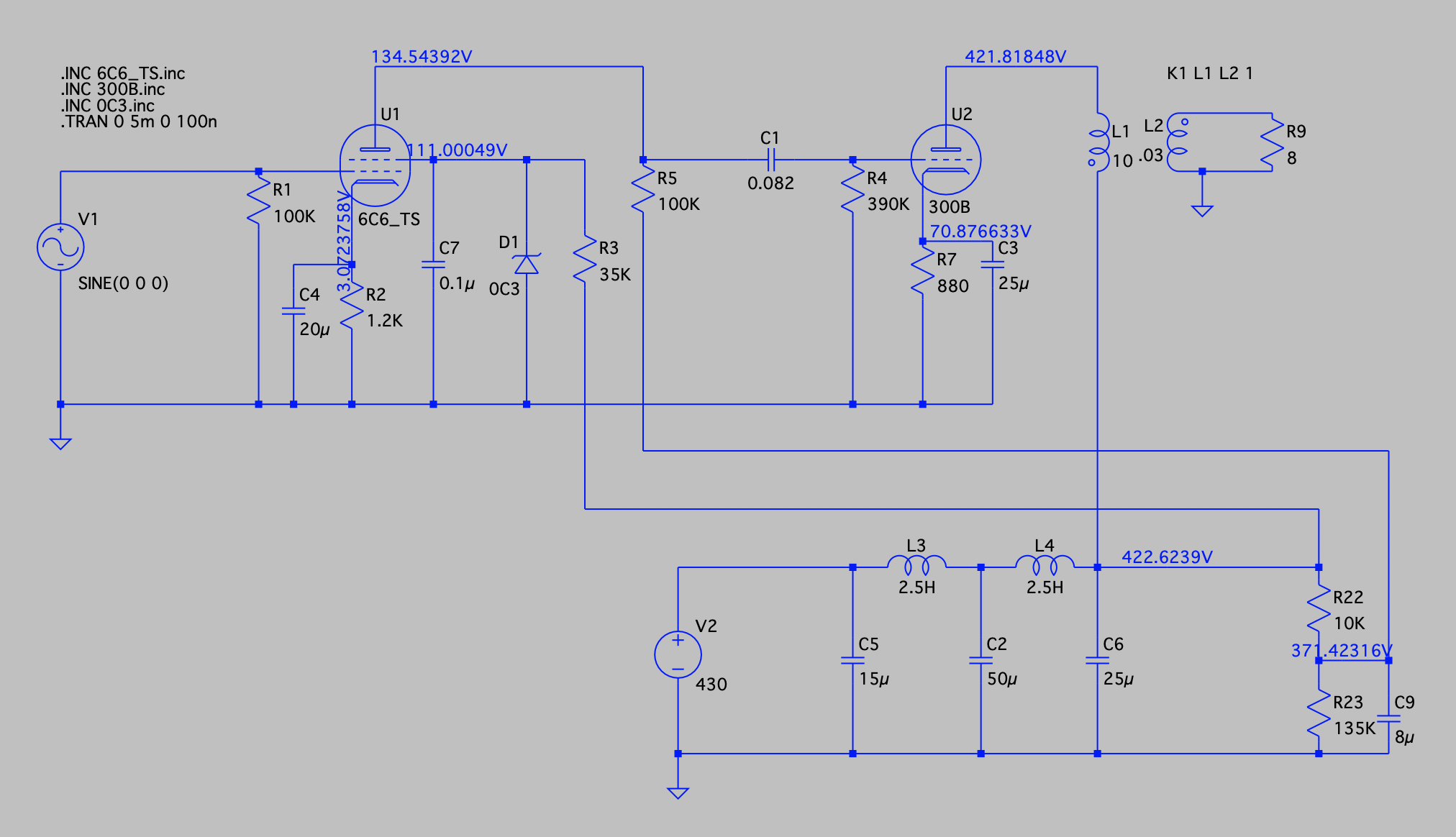

Here are two more versions, incorporating some of PRR and 6A3sUMMER's suggestions.
The 80mA version removing the 135K resistor at R23 results in 160V on the 6C6 plate, just 10V above the 150V in the original WE schematic. Of course, other resistor values can be tweaked for higher plate voltage.
The 400Vak/50mA version, with a supply voltage of 495V and keeping a 0C3 on the 6C6 grid, nets 225V on the 6C6 plate, close to PRRs recommended 250V. A 43K resistor sets the 0C3 at 140V/8mA.
Is this a Heavy Metal guitar amp? If not, SE circuits in un-clipped speech/music work don't "bounce/sag". Built it, put a meter on points, push it, the bias points hardly vary.
jdrouin,
You will get almost identical ripple voltage reduction with C2 and C6 swapped.
Ripple is at 2X the mains frequency.
50Hz = 100 Hz ripple
60Hz = 120 Hz ripple
But . . .
The lowest note you might want to play through your amp might be:
83 Hz lead guitar
41.5 Hz bass guitar
32.7 Hz organ Pedal C
16 to 25Hz Thunder drum
The impedance of a capacitor is higher as you go to a lower frequency. You want a stiff capacitor at low frequencies that supplies current to the 300B and output transformer.
When the capacitor impedance is 10% of the output transformers impedance, you are about 1 dB down. If the RC coupling is also 1 dB down at the frequency, and if one of the bypass caps is 1 dB down at that frequency, You are now -1 dB + -1 dB + -1 dB = -3dB down at that frequency.
A little rolloff here, a little rolloff there, and pretty soon you are talking about 1/2 power (-3dB).
Most speakers will not go that low, but add the -1, -3, or -6dB frequency of the speaker to the amp rolloff.
