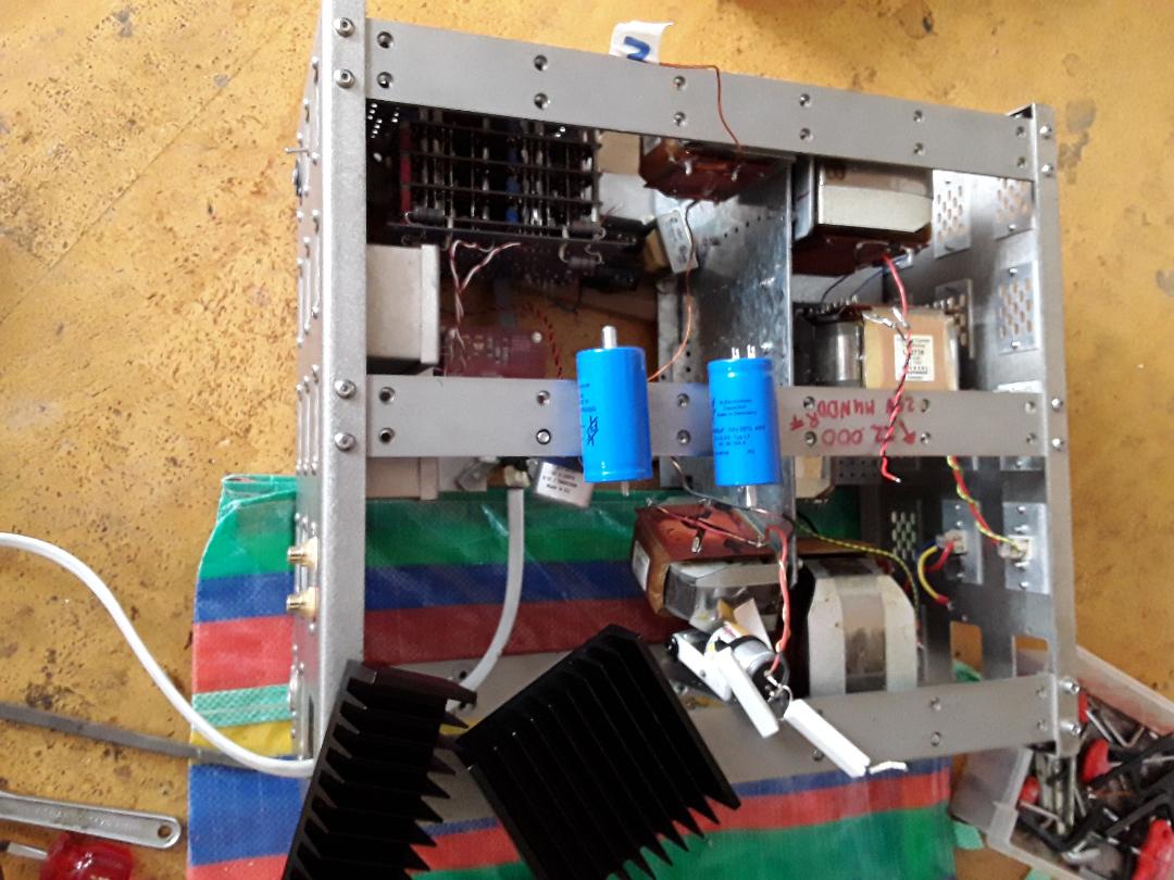

Hello,
Parts starts coming in and i expect the last parcel before the end of next week.
Without proper CAD/CAM software it is rather time consuming to '' redesign '' and also do the works in real life without have everything available. Most metal frame work inside the chassis is steel or aluminium and all ready have some holes that can be made bigger or threaded. ONCE the chassis is heavily populated bolts and nuts can be hard because you cannot reach both of them with a tool. I have lots of special tools to make threaded holes.
Doede ( DDDAC) made a short of redesign of his power supply so it will be a lot easier to use when there is limited space.
I will use one for the lifepo4 board and one for the Etherregen which will be attached to the outside of the DDDAC chassis.. The lifepo4 board will stay until i will find a way to use the supercaps with the lifepo4 cells.
Last week a company that collects old metal picked up some old big radiators at my house. He saw my pile of transformers and he told me he recently ran across a wooden crate filled with chokes made my Siemens. They have an instruction how to adjust the airgap. If i take them he doesnt have to take the copper and iron apart so it could be a win win situation.
Greetiings, eduard
