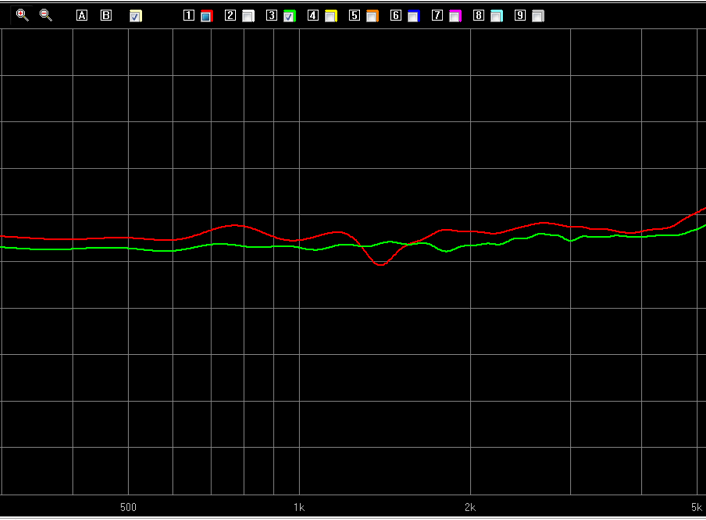

Looks like Troels may have found a simpler way to deal with smoothing response, using glue at the inner edge of the surround, as explained in his latest piece...
By adding a proper amount of glue with proper elasticity and resilience* and in the right place on the inner side of the surround, the energy coming from the cone can better be absorbed and the result is a more linear frequency response - and hopefully, more fidelity.

A trick Bud figured out a decade ago. All my Fostex get treated that way.

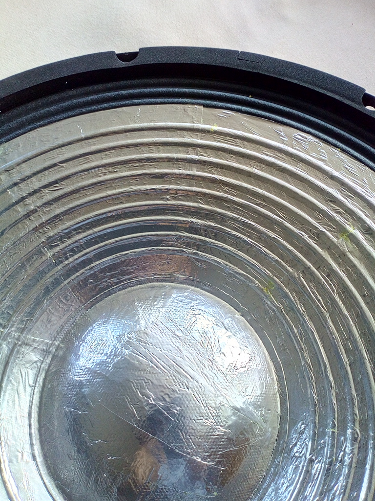

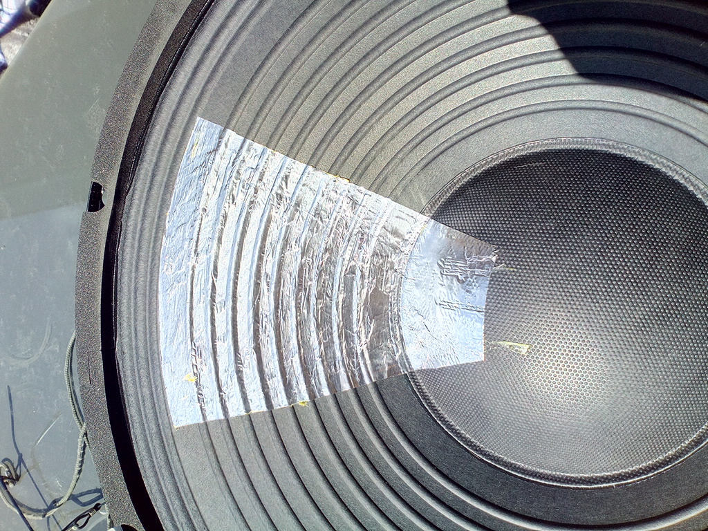

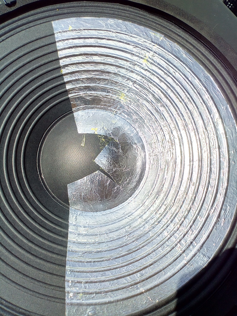

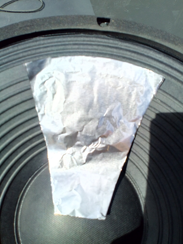

Hello,
description of how it is done - you can find here:
https://www.diyaudio.com/forums/pa-systems/375464-tuning-tweaking-bp-115-a.html#post6745386
Aluminium foil on an 15 inch paper bass driver
