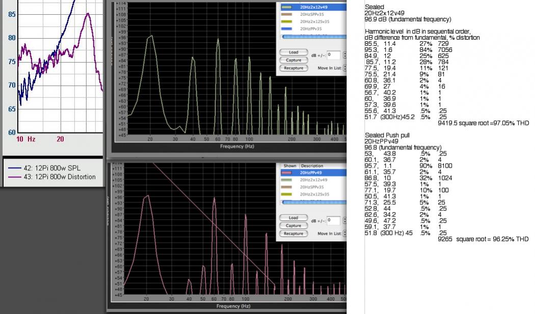

Art I look forward to seeing your results. I may do a quick push pull versus standard mounting distortion test myself. I have a common chamber, dual opposed, sealed enclosure that I could use. Since it is sealed and a common chamber the air volume seen will be the same and it will be a simple test to do. I won't get to it for a couple of weeks though.
Wayne, it is generally held that push pull works for the even harmonics but not the odd. Do you have any public data for the harmonic make-up of the 12pi distortion? Is it predominantly 3rd? I would expect the odd order harmonics to still be present in roughly the same level as with standard driver orientation, or does push pull also work to reduce the odd harmonics? The subs that I have tested extensively with push pull driver mounting are Danley DTS10's. They exhibit the usual skyrocket below cutoff of any other non sealed subwoofer. Obviously the 12pi has a sealed chamber on the drivers which keeps excursion under control below the horn loading where the tapped horn behaves more like a vented enclosure below loading but the distortion shown in the 12pi test below loading still seems remarkable given the 15-20 db of harmonic amplification the horn provides. The 3rd harmonic of 15-20hz puts it right in the horns wheelhouse. A harmonic -40 db down representing 1% distortion being amplified by 15db to -25db from the fundamental would raise the distortion to 5.62%.
Since there is so much hair splitting going on, isn't the 12pi 26" wide versus 22.5" for the Labhorn? That would make it a >13% larger subwoofer and provide a small performance advantage as well. Larger horns covering the same operating bandwidth usually have smoother response and slightly higher sensitivity.
That's right, actually, it's 45"x45"x28", which is 5-1/2" wider than the LABhorn. One of my goals was to smooth the response curve, especially its large dip right above cutoff. So I used a slightly larger mouth and different front and rear chamber sizes to make response smoother. I wanted a horn that could be used in fewer numbers and still get good response. It still fits through all doors (even doors in homes are 30" wide), and is a nice truck pack dimension.
Right again, push-pull only cancels even harmonics. The odd harmonics are still there, but you're right, the sealed rear chamber helps excursion not rise as much. Still does rise though, and quite a bit. My measurements are all THD+N, mostly because of time constraints, but I would assume as you have, that the distortion that's there is predominantly third harmonics. Higher harmonics are getting shifted far enough out of the passband to be attenuated by the bandpass nature of the horn.
It is remarkable, thanks. There is a large and obvious difference in the amount of distortion produced by the 12Pi hornsub and all the other subs we measured at each of the Prosound Shootouts.
But even given those large differences, it isn't really unexpected. The 800 watt THD level of the 12Pi hornsub at cutoff is about 15%, which is undoubtedly mostly the third harmonic. The rear chamber is sealed, so excursion doesn't rise nearly as much as a BR or TL/TH box below cutoff. Excursion still rises though, which definitely causes the bottom end distortion to start coming up. One would expect the third harmonic of the woofer at ~30Hz in a 20 liter sealed chamber to be somewhere in the vicinity of -25dB to -30dB, so with the horn acting upon this level, it would probably rise to -20dB to -15dB, which is exactly what we're seeing.
Above 35Hz or so, excursion is reduced by horn loading, and we also have push-pull drive to further reduce even harmonics. An octave above that, excursion is even lower, and we start seeing distortion fall even more. Towards the top of the passband, distortion is lowest, because we have several things in play: Horn loading, push-pull drive, the acoustic low-pass of the front chamber and horn folds and the natural tendency of excursion to be reduced as frequency rises.
Compared with other systems, we see some of the same issues, but some are different. The excursion of a vented box or a transmission line remains low through the passband, but rises dramatically below cutoff. Systems like that lose control fast. Tapped horns have an additional difficulty, in that they tend to amplify the harmonics below cutoff. They also seem to have a lot of artifacts just above the band of interest - still in the "passband", but unwanted. I think that probably contributes to some additional distortion, if you view them with THD+N rather than a series of H2, H3, H4 harmonics. I haven't studied them in great detail, but I am not entirely sure if those high frequency artifacts are harmonically related. If not, they would show up on a THD+N measurement, but maybe not on a chart of harmonic series.
In any case, push-pull drive reduces even harmonics. Some may argue that even-harmonics are more euphonic than odd-harmonics, and that may be true. It's another discussion. But I think if I can reduce harmonics, it's probably a good thing. With two drivers, it seems worthwhile. In my case, in the 12Pi hornsub, the difference was remarkable, especially at low frequencies. It is kind of weird to hear the thing go dead quiet down low, when you're used to hearing sweep after sweep of other horns that don't do that.
The results of my testing of Lab 12 in ported and sealed cabinets , normal front load and push pull are interesting. Had a perfect day for testing,(other than smoke from all the nearby fires) noise was very low, never had to wait for wind to die as in most testing here.
Although 1st, 3rd, 5th (odd order) harmonics were greatly reduced by push pull loading, the second harmonic sometimes increased, resulting in the THD not signifigantly changing, as can be seen in the 20 Hz 49 volt test results below.
It appears the 12Pi has similar THD approaching 100% around 20 Hz to the PP or standard loaded Lab 12 in a sealed enclosure, so I’d expect the harmonic structure to be similar.
Since the frequency response and output of both the PP and standard cabinets were almost identical, an A/B listening test was simple, just swap the speaker cord and short out the unused cabinet.
At lower power levels, where the Lab12 is quite clean, no difference could be detected. When pushed at a power level where distortion could be noticed, the most distracting artifact was the audible vent noise from the reversed cone of the PP.
The lack of the second harmonic, an octave, made the now predominant third harmonic distortion more apparent in the PP cabinet. This is music related thing, the third harmonic , being a perfect fifth, may sound OK with some compositions, while sounding “wrong” with others.
Although the technical side of me says reduction of distortion of any sort is a good thing as far as a reproduction system is concerned, both my old ears, and a college freshman apprentice thought the push pull cabinet sounded less “musical” when pushed hard.
And Wayne, please don't take what I have written here out of context, at levels equivalent to your tests, and at what any reasonable user would use the 12Pi at in it's passband, distortion simply would not be audible.
Art Welter

You can clearly see the reduction of the even harmonics in Art's measurements. The fundamental is 20Hz, and the even harmonics are 40Hz, 80Hz, and so on. I can see a 30dB reduction in the second harmonic, for example. That's what push-pull does for you.
What's nice about a hornsub with push-pull drive is the natural bandpass nature of the system tends to reduce the third harmonic and higher. For example, the third harmonic of 30Hz is 90Hz, which is still in the passband, but by the time you get to 50Hz, the third harmonic is moving outside the band. So the third harmonic is attenuated for about half the range the 12Pi basshorn is used in. All the higher harmonics are too. Basically, when you deal with the second harmonic in a hornsub, you've got most of the distortion beat.
