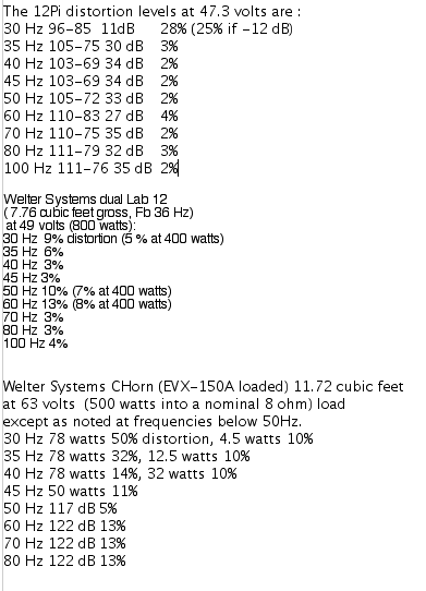

I have no disagreement that where it counts, in the passband, the 12Pi has less distortion...
I'm still not comfortable with the distortion values you state. I think your stated value for the vented box is too low, and the value you quote for my 12Pi is too high.
At the very least, I think you have "rounded-down" the 30Hz distortion value of your reflex box, and "rounded-up" the distortion value of my 12Pi hornsub. When I look at the 10-meter 800 watt chart of the 12Pi, I see the THD value is at a peak level, 85dB. The fundamental is falling fast, of course, since it is heading into cutoff. It's somewhere between 98dB-100dB, making it 13dB to 15dB above the harmonics. That puts total harmonic distortion in the 15% to 20% range, not 28%.
To expound a little further, one reason I think it is optimistic to state ~10% distortion at 30Hz from the 36Hz reflex alignment is it has exceeded xmax by that point. All of its operating parameters are on the edge - it is maxxed out on thermal capacity, excursion and magnetic flux modulation. All these things conspire to cause distortion to be rapidly climbing at 30Hz and below.

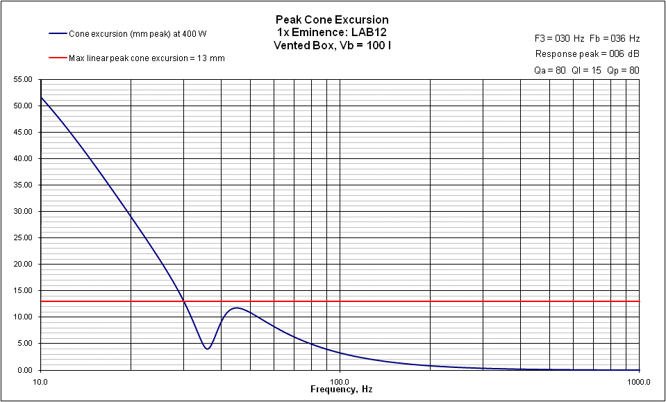

The attached chart (below) shows a LAB12 in a 3.5ft3 box tuned to 36Hz. At 400 watts, the 13mm excursion limit is exceeded at 30Hz, so I would expect distortion to be rising rapidly, in the double digits at least.
This alignment gives a 6dB bump at 36Hz, and reduces excursion in this region. So I think that's a pretty decent alignment for a light-duty prosound "club-sub" box, because it prevents 400 watt excursion from being exceeded in the passband. But it does run out of steam fast at 30Hz, and can't keep excursion (and distortion) from skyrocketing. That's OK though, I mean, everything has limits. Use it with high-pass at 30Hz, no problem.

Looking closely, I see a >12 dB level difference at 30 Hz for the 12 Pi, a 12 dB difference is 25.12%, 11 dB difference is 28.18% distortion.
So lets say the 12Pi distortion at 30 Hz is 25 % at 30 Hz instead of 28%.

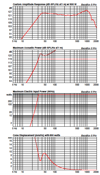

The vented alignment you show does hit Xmax at 30 Hz, but my dual ported dual Lab 12 does not exceed Xmax at 800 watts at 30 Hz, and does not have as much distortion as the 12Pi at 30 Hz. It happens to do well at low frequencies, where the design was optimized for.
I did not use programs to design it, years ago I empirically tested dozens of real cabinets with real speakers to arrive at the alignment. The Bass box Pro simulation does correlate well with my real world tests regarding excursion.
At 30 Hz, according to the simulation, my ported cabinet can do about 118 dB (one meter) with 49 V input, the 12Pi is almost identical there (98 +20 to reduce 10 meters to one =118 dB).
My tests don’t agree with the simulation exactly, I’d say the the Bass box Pro sim may be about 4 dB high at 30 Hz, so I won’t be betting on my ported cabinet to win, place or show in a one to one comparison to the 12Pi, other than having less distortion at 30 Hz.

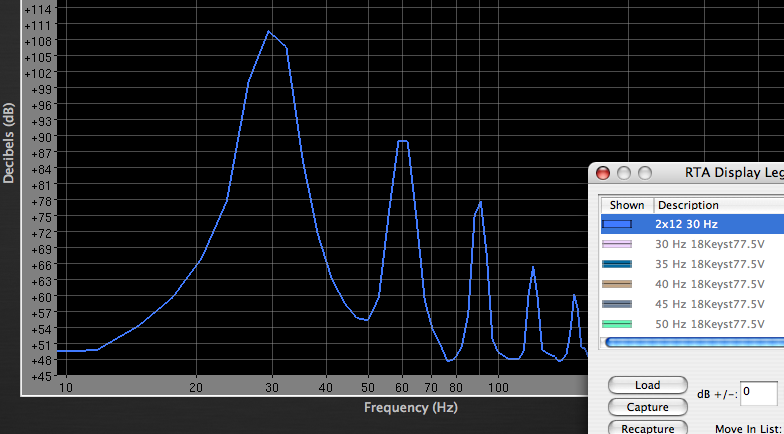

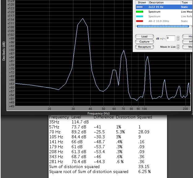

As I have also previously posted (and you ignored again), to figure THD, you sum the squares of the distortion, then take the square root of the sum. If you bother to do all the math, you find the addition of the lesser volume harmonics has little effect on the THD compared to the value of the highest single harmonic.
Just to please you, I went through the math (again, posted previously) on my 35 Hz distortion figures, in the case of the 35 Hz distortion, my “loosy goosy” reported distortion was 6% instead of 6.25%.
And in the spirit of full disclosure, here is the math for the 30 Hz distortion figure you seem so upset about:
30 Hz 109.6 dB
60 Hz 89.1 dB -20.5 dB 9.5% 9.5 x9.5 +90.25
90 Hz 77.6 dB -32 dB 3% 3x3=9
120 Hz 65.4 dB -44.2 .6% .6x.6=.36
150 Hz 60.1 dB -49.5 .4% .4x.4=.16
Sum of distortion squares to the fourth harmonic, 99.77, square root =9.99% distortion.
I have also previously posted that my distortion figures are accurate to within about 1%, the math says they are.
The THD 30 Hz amount is 9.99% instead of 9% as I reported, better call the distortion police...

So to specifically answer your two questions, sub A does have bragging rights to lower distortion if the distortion percentage is lower with the same input voltage than sub B, though that brag is of little consequence my (or Wayne's) world.

In post #29, on June 21, 20011, you wrote:
“The fact that my hornsub is only 28% below cutoff is excellent evidence that the push-pull drive reduces distortion a significant amount.”
Now you seem to want to take that back, but whether it is 28%, or 25% at 30 Hz is no big deal to me, but it is not 15%, which requires harmonics to be about 16.5 dB below the fundamental.
No way can you stretch my Dual lab 12 distortion to have it come up to even 15% at 30 Hz.
I gave you the numbers, test my math, if you want I can give you all the harmonic figures until they fall below the noise threshold.
The microphone I used for testing my ported Lab 12s is a B&K 4004 using a 130 volt phantom power supply, rated for <1% THD at 148 dB.
Of course, any microphone distortion would be added to the speaker under test’s distortion with my set up.
As far as “calibration” I never claimed the output of my ported dual Lab 12 was higher than the 12Pi, and a calibrated SPL is not needed to figure distortion percentages.
