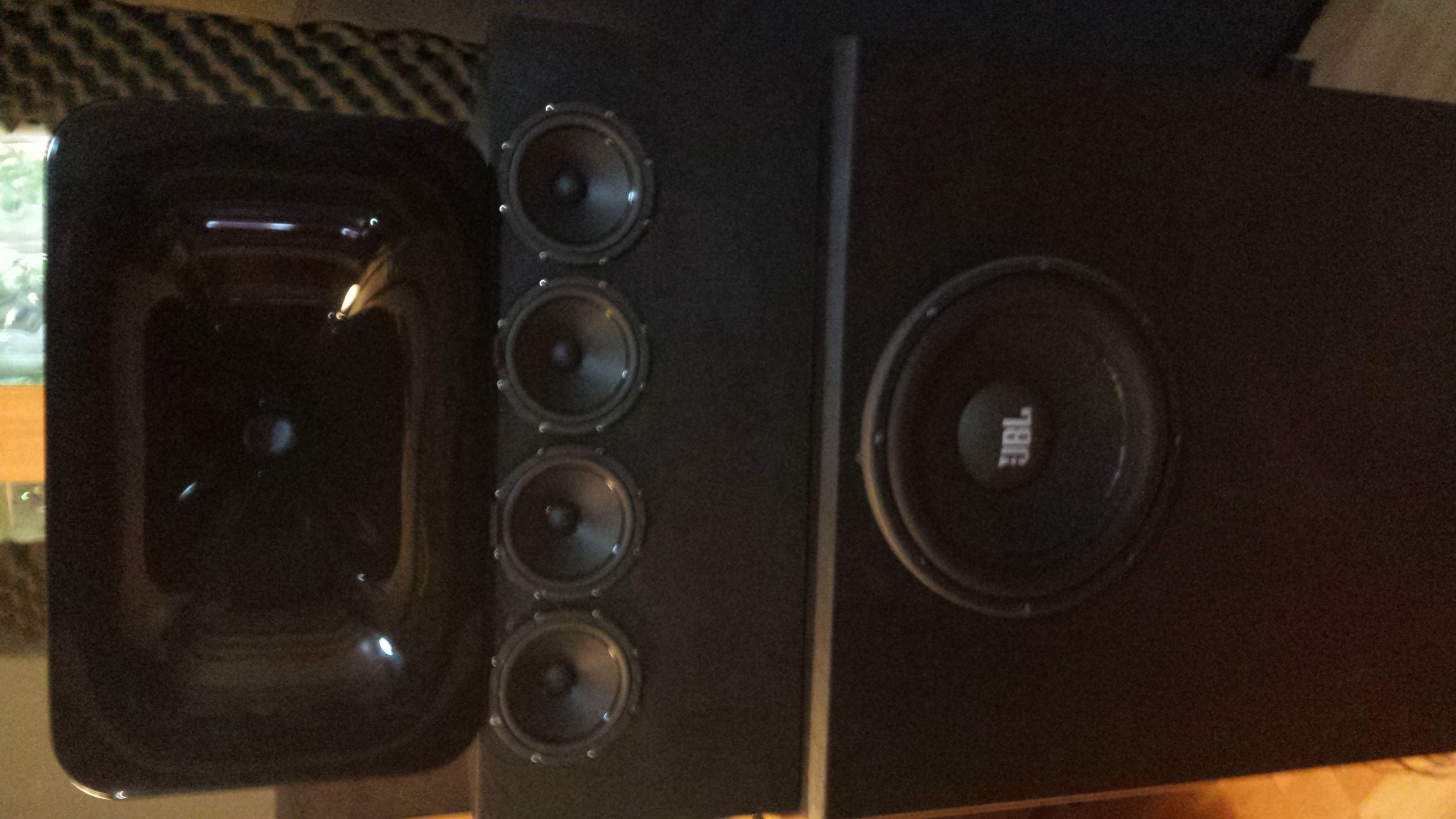

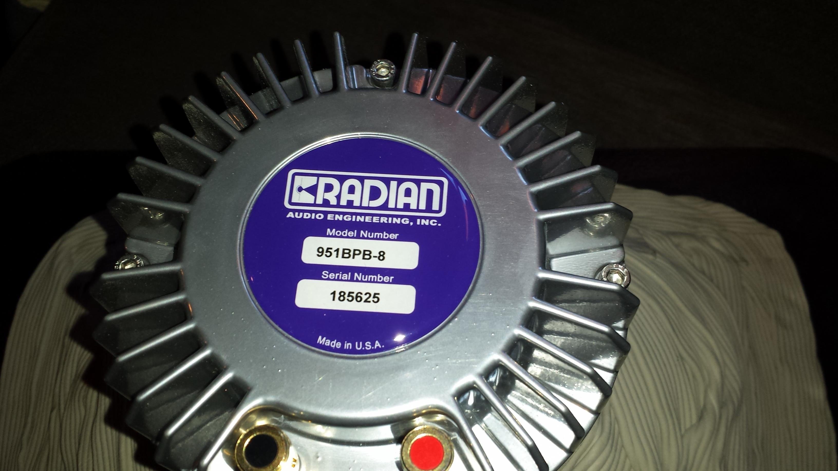

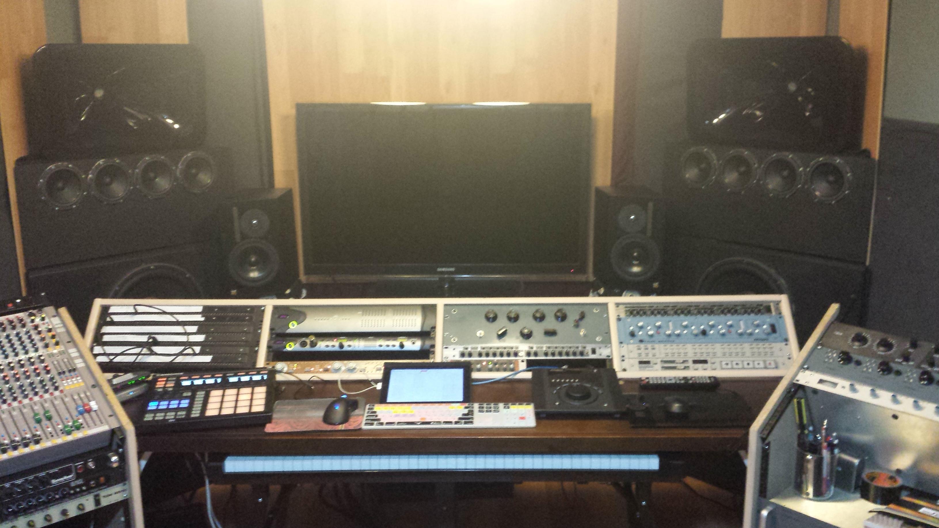

Here are some SEOS24's with Radian 951pb-Be, or 951BPB as it's labeled on back (shipped with the truextants Be frams from uss speaker)-
Ultimately I'm working toward a CNC'd Phenolic resin baffle with a pair of AE TD10m's under the seos. The Subs are sealed JBL W15gti's. They are XO'd active at ~380 as of now, might move up just a little as distortion creeps up under 4ish.
Very good stuff! The NS6's are getting their butts kicked right now...
