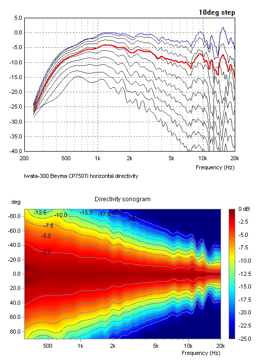

Hello,
The shape of the Iwata 300 is not chosen in order to look good.
It is simply the result of the effect of the oblate strain of the equidistant wavefronts ( = parallel wavefronts) the area of which follows an hypex law (T = 0.5 or 0.7) according to a linear variation -from throat to mouth- of the ratio between the curvilinear horizontal width and the curvilinear vertical height of the wavefronts (ratio variation from 1 to 4 from throat to mouth according to Iwata San for a medium frequency horn).
No additional hypothesis on the shape is used to calculate the horn.
It looks good and sounds good! (and no need for any bloody foam insert!)

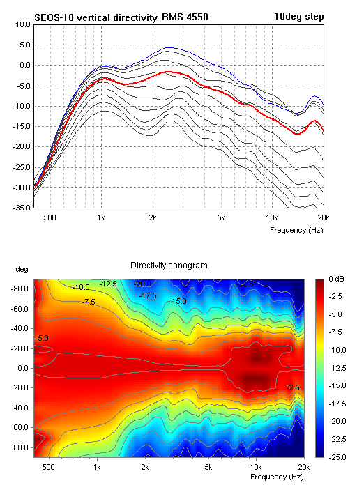

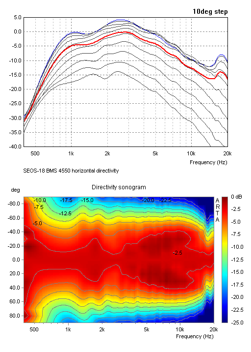

SEOS-18 horizontal directivity, 10deg step.
Could you guys help me out for a minute. I see a disconnect between the measurements and the Directivity Sonogram on the SEOS-18 Horizontal plots. The color polars can't be from the posted data in the plots. If you look at the on axis response there is a peak at about 2.5K where it is +5 and at 10K it's 10db down, so we have a 15db spread.
That's not what is in the Directivity Sonogram. So what's up?? Is the Sonogram a plot of an equalized set-up with a crossover or is that from a different horn?? How much smoothing is used in the Sonograms??
Thanks Rob🙂

Thanks!
I have 3 IWATAs now also 2 JBL CDs, 2 BMS 4590p CDs and just found some TAD TD-4001s that will be here this week..I should have some fun measurements and listening tests. Im curious to hear all the differences.
Also will compare the IWATA against the QSC HPR152i + BMS 4550 design.
