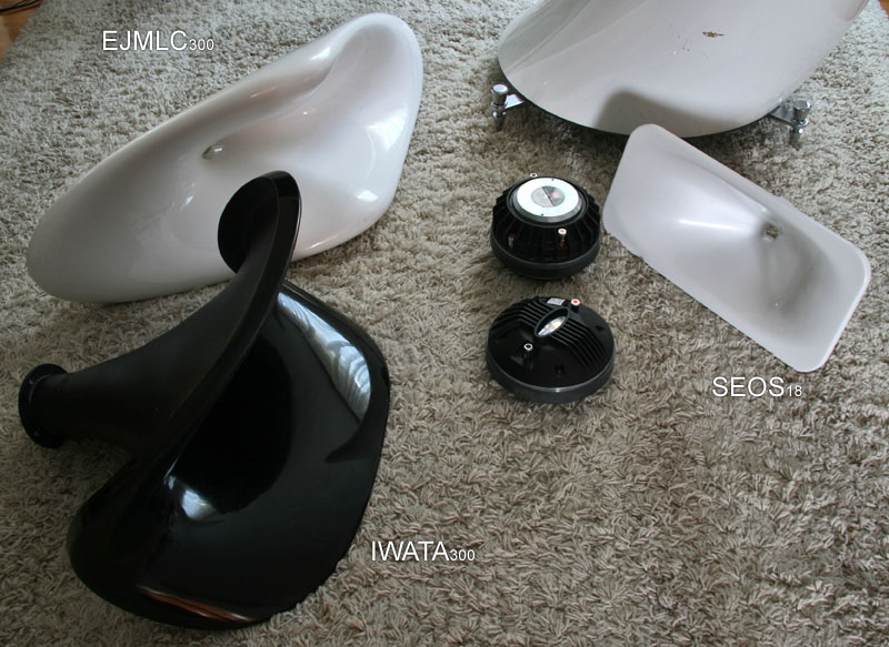

SEOS-18, black Iwata-300 and white EJMLC-300 to be installed on Universe. Measurements in a couple of days.
