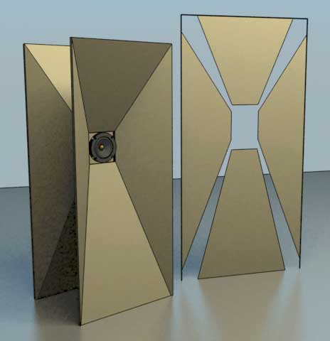

For integrated reproduction I would suggest not 'subs', but light coned woofers or mid-bass...
Also a pair of inner back-of-waveguide edge side triangles from below the top driver to level with the lower ones, to create an inverted bipole BIB with the rear LF exiting from the top of the cabinet...

Construction suggestion: a scaffold/skeleton of plywood. like a boat hull.
a layer of ply over the top. plane edges to fit.
Are you thinking about 3 feet high?

Very smart. With the central placement in an 18" wide baffle you compensate the rise of a typical 8" fullrange driver between 500Hz and 2kHz, and with the loading you compensate the baffle loss between 200Hz and 300Hz.

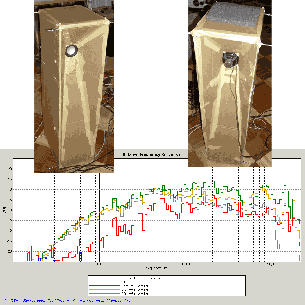

I've already started cutting and taping cardboard pieces. I hope first prototype box will be finished in a few days.
ok, here are first measurements. red curve is 3ft from baffle edge.
all others are taken from 8in distance. there is huge dip at 5khz, any ideas why it's there? 🙂 it flattens as you move farther away from speaker. and 12khz dip unfortunately remains there. Overall I'm very impressed, I think this design has potential. it sounds so natural and defenitely better than straight open baffle. I have few other drivers to try fe127, fr125 and neo8. especially I'm looking forward to neo8 test.
maybe I should have made waveguide on wide side of speaker.

Graham Maynard, I was thinking about it too. But, if I make BIB, horn, or br on the back, speaker will loose that magical dipole sound.
I think it's better to build these without side walls.
It would make them look much smaller and non obstructive.
for example my 15in wide dipole speaker, seems much smaller than 9in wide floorstanding speaker. it even appears to be smaller and lighter than this cardboard box.

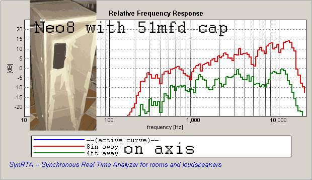

new neo8 measurement. I used 51mfd capacitor.
this waveguide is too small, I'm going to construct another one, for fr125. it will be approx 18in wide and 4ft tall. that's as far as size can go, for aestetical reasons. no sidewalls this time. just front and back baffle. I'll post 3d rendering next week.

you can use cad software to calculate cutout angles( I use 3dsmax).
I just detached sides of modeled enclosure and projected them on flat surface 2x4'(size of mdf sheet) ,see right side of the image.
I know, it's extremely difficult to make it out of thick mdf. That's why I'm using thin 1/8 in sheets.
I haven't started building yet. I'll post pictures when start making some progress.
I plan to use hot glue to hold pieces together, then add stronger wood glue.
This geometry should be quite ridgid,if not, I'll add ribs to the sides.
