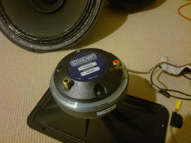

I have some Radian 475PB drivers coming if you would like to test them
