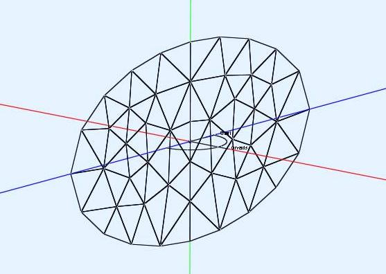

Thank you for the links. Have been trying to get some good reading material on the design process.
Does anyone happen to know what depth the interface should have compared to the horn?My infinite baffle is at the mouth of the horn. From the help section I understand that interface is used to couple two subdomains. It can be used to simulate elements behind the infinite baffle. How far behind should it go? What is the importance of shape of the interface? The HORN 400 example also says that it can be used to avoid modeling the mouth exterior. I find this very confusing.
Well, I'm not entirely clear on the concept as well, i.e. the point I do not see is a rational for the depth (50mm) of the 'interface-box' in front of the finite baffle (=horn flange).
I simply varied the depth in the nodes script...

Ok. I understand the approximation now. However, I see changes in the directivity with change in depth just like you said. I also see changes in directivity with usage of different interface shapes. Do you think the interface has to have a similar shape to the horn mouth? The built-in SHELL shapes are not working well for me(Eg. Ellipse). They appear in the drawing but vanish during the meshing! The regular shapes work fine. I guess drawing the interface along with the horn is the best way to go about it (Though changing the depth each time is going to be a pain!).
Sorry for being late here wildsteve. Due to lots of other commitments I haven´t been able to respond to anything for a while.
One hypothesis regarding the "off" radiation pattern at lower frequencies might be that when you use an infinite baffle setup ABEC doesn´t "see" the rear of the horn at all. In ABEC is´t perfectly possible to have a one-sided wall. I find this difficult to grasp myself, so sorry if my explanation/hypothesis is way off. If you were to make the horn itself "solid" where you make both the inside and the outside, the sound waves would wrap around at lower frequencies properly.
Another thing that could happen is leaks. I have not seen your model, but if your model has leaks between the subdomains it will cause strange effects - sometimes making ABEC use all the memory you have and stopping the solving.
I was also given a tip in my ABEC synergy horn thread http://www.diyaudio.com/forums/multi-way/267083-synergy-horn-3d-printing-entry-31.html about assigning damping factors to the various elements. Elements without damping factors in ABEC are assumed to be "rock hard and fully reflective", which tends to overestimate peaks and throughs, standing waves etc.
CAD imports to ABEC can be both easy and difficult. Easy: If you have a model which is solid one solid piece. Difficult: The opposite. I made a (not to scale, not realistic) dummy model of a paraline, and it was a lot of work assigning the different polygons the the correct subdomain and ensuring all the normals were correct.
In my synergy model I included a quadratic square throat to transition from the DE250 exit to the square synergy horn. If I meshed that too finely before importing, ABEC would override my settings for meshing, making the whole thing mesh at a too fine mesh size. MeshLab is a good tool to reduce mesh complexity before importing. 20k needs a very fine mesh size though, and unless you have a very high specced computer you´ll probably need to use symmetries. If your waveguide is symmetric (which I assume) you´ll save a lot by making your model of the waveguide, then chopping it so you have one quadrant before making a .mesh file and importing it to abec. If you also use meshlab to reduce the number of polygons it will make it even better. Of course, if you make it too coarse, it will have an acoustic effect...
Hope some of this helps. You can also post your model here and I can have a look. The whole synergy model is also posted in the thread mentioned above. Perhaps it can be useful, and more likely you´ll find improvement potential.. :)

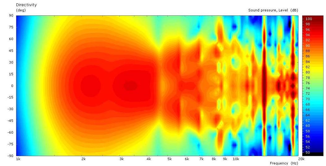

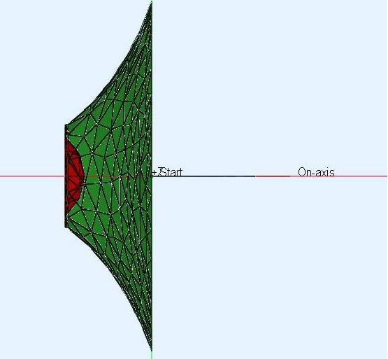

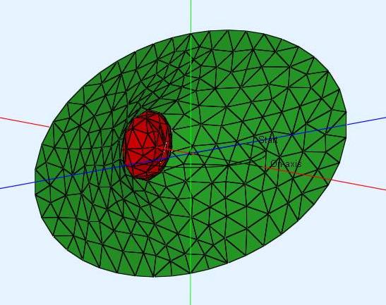

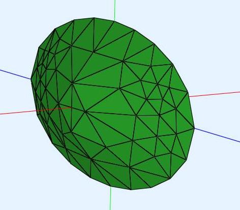

Hi all. With all of your help I have been able to run simulations of a waveguide. I have not used an infinite baffle. Instead, I followed Cookiemonster's suggestion to model the rear. To make it simple(because I am lazy), I closed the rear with a simple cover(shown in 4th attachment). I have used a filter frequency of 1800Hz for the tweeter. I should be getting fairly constant directivity(+/- 60 degrees) starting right from 2000Hz upto 10KHz but as you can see, the plot shows otherwise. I also found that changing the meshing frequency in ABEC greatly changes the directivity pattern. Is this because I have meshed parts using different mesh-sizes?
Most of you might be knowing how to translate websites but in case anyone wants to read Gaga's thread in English: Google Translate
The thread also explains how to group many elements together during the meshing stage.It will help me A LOT! A tip: Direction of normals can be inverted by using a negative sign for the respective surface while assigning physical groups.If you are using gmsh, It can be done in 'edit file' under geometry.
Is that the shape of the enclosure you are going to use? The sharp lip will introduce significant diffraction effects.
It means you have not used enough elements for the solution to approach "grid independence" where adding more elements will not significantly change the solution. The minimum number of elements to achieve this is often quoted as a number of elements per wavelength. Alternatively you can find it yourself by performing a sequence of simulations of the same problem with progressively finer grids and looking for when the solution stops changing.
Actually no. I am planning on using a rectangular box for the enclosure. I wish to simulate only the waveguide's directivity at the moment. The reason why I chose to use such a simple enclosure for the simulation was to reduce the computation time. My idea was to assign the enclosure with a very high damping value. Despite using a high damping value, I still get diffraction effects as you said. So I am back to using the box enclosure again but this time with a smoother transition to the waveguide. I see a better response now. Thank you for pointing that out.
I understand the concept of "grid independence" but since I have to mesh the geometry once before importing(in gmsh) and once after(in ABEC), I am trying to find a balanced meshing method. ABEC suggests on using coarse mesh in gmsh but doing so affects the high frequency response.
