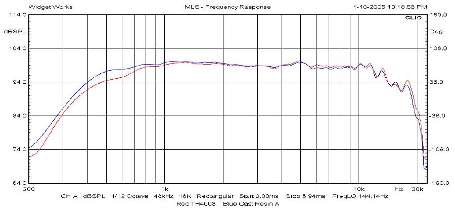

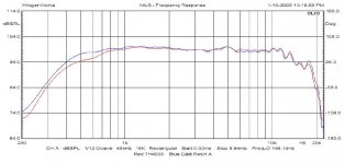

Show me an example of a horn/compression driver system that has no peaks when there is no electrical modification.
Below you'll find a pretty good example. It's a TAD compression driver on one of their radial horns of a decade ago.
You can find lots of other examples like this. I myself used a radial horn for quite some time that was really smooth on-axis and had pretty good horizontals too.
Yes, it doesn't do the top octave but is a good example of a horn that is ripple-free down low and midband. With decent acoustic loading, the amplitude response is smooth. Plenty of other examples like that out there too.
While I might question the details of that system, I'll give you that it might be possible, but it is the exception, not the norm. Most systems will not be over-damped with extremely low cutoffs like that one and those will always exhibit a peak. A peak which is easily and effectively flattened with a LRC circuit.
