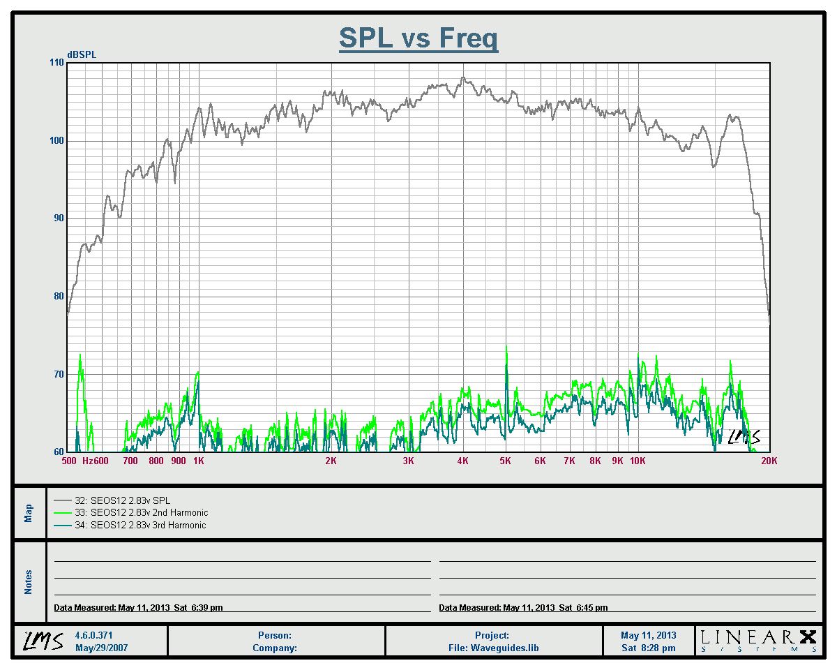

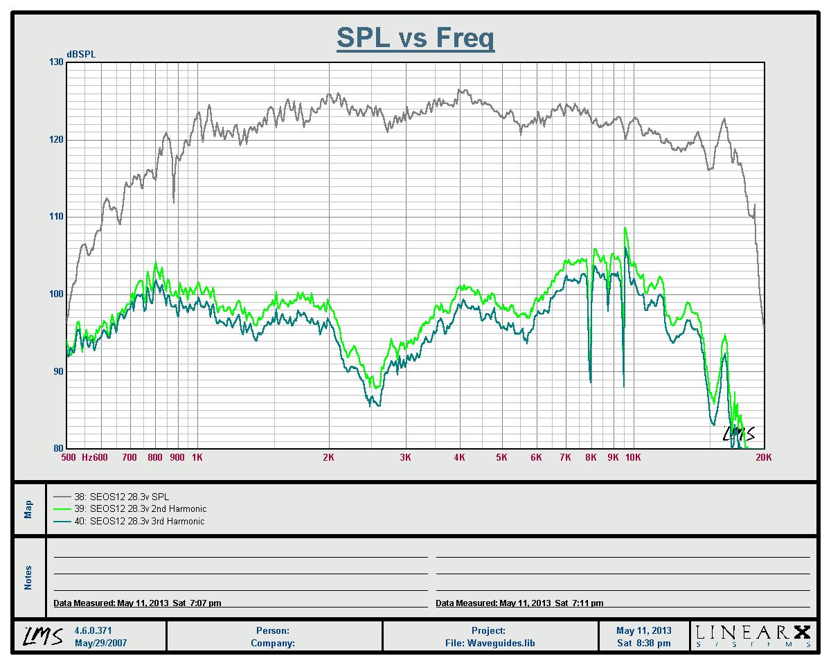

As for electrical parameter shifts, they are most definitely real, and fairly significant. It strikes me a bit odd that you would be concerned about thermal modulation, yet dismiss the effects on response.
Some systems shift greatly as voice coil resistance changes at higher temperature. Others shift less. In general, I find the shifts in woofers to be larger than compression drivers, but I do find the response shift quite detectable in compression drivers too.
Here's an example. Look at the two response charts below, the ones showing a compression driver on a horn. Download them to your computer and click between them rapidly so you can see how the shape of the ripple changes at higher power levels. Then look at the two charts of a basshorn below that. It shows what I'm talking about even more.
Compression driver on a horn:
Cone driver in a basshorn:
Please explain to me how a temperature change will change the frequency of a resonance. There will be a slight change in the level from thermal effects as the coil resistance changes or the magnetic field drops, but these are fairly small changes and the tank circuits are still "tuned" to the correct frequency.
I have done these power tests (frequency response as a function of power level) on my speakers - remember they were originally designed for Pro applications - and found that while there were some changes they were only a few dB - at peak power levels! The greatest changes were actually in the passive circuits themselves where the coils would sometimes melt. Larger coils would, of course have prevented this, as would an active crossover, but the point is that at its absolute worst it is not a problem that would make the use of tank circuits ill advised.
This is in line with the measurements I posted. We see a few decibels change in the ripple at high power levels compared to low. Some cases are worse than others, with just a couple decibels difference in the best cases and as much as six decibels in some of the more "shifty" worst-case systems. But in all cases, there is thermal shift.
And I might add, this is an instantaneous condition. It doesn't require heat soak at all. The peaks are there instantaneously, or at least within a few cycles. This may be part of the thermal modulation we were talking about earlier.
