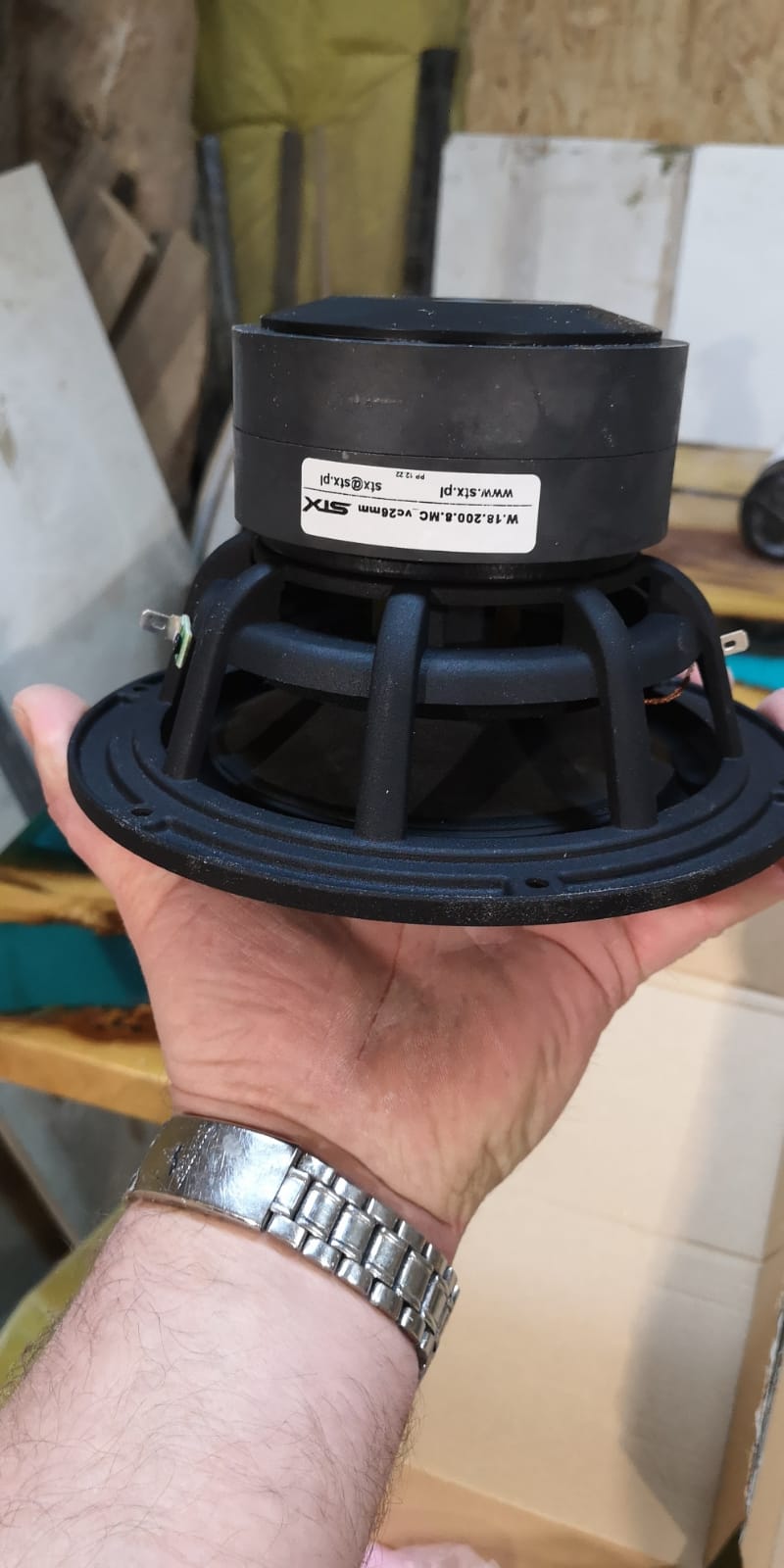

It was a good driver (v2) but they've changed the spec (lower Qms): https://stx.pl/w-18-200-8-mcx.html
They also made double xmax version for me for a given T/S in two weeks! I told Vance Dickason to test some.
