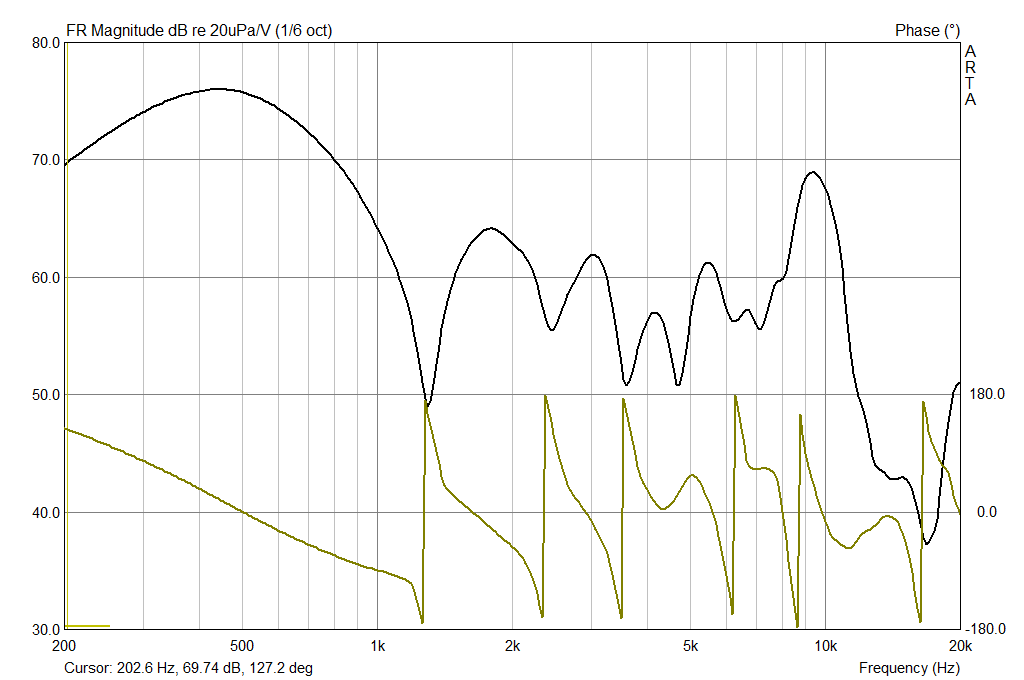

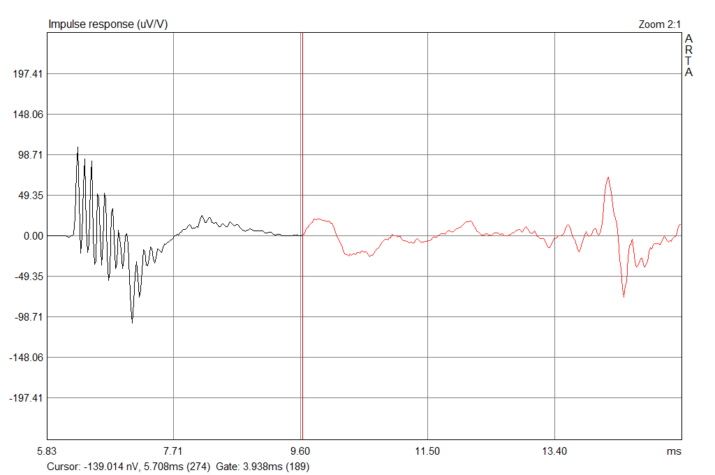

Because the impulse of my straight line array looks pretty normal to me:
By the way, that flying line at the top is the STEP response. Wiggles are probably comb filtering, as that is very real. Distance between speakers for this array: 85.5 mm, 25 drivers.
Time difference between out most driver arrival at ear vs the driver at ear height 0.6 ms.
21.6 cm time difference to ear at 3 meter distance.

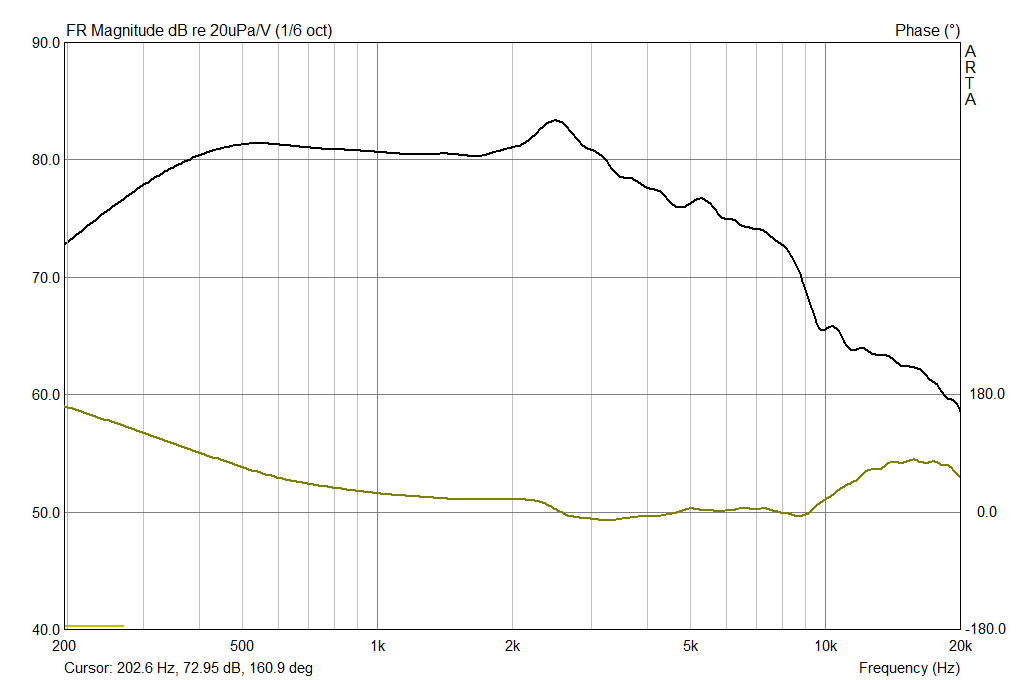

Here's an example of a sloping high pass response:
Ignore the stuff above 20 khz.
Here's the associated impulse response:

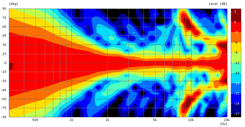

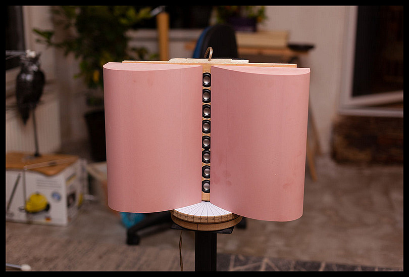

A line array is only minimum phase at 0°. Under higher vertical angles where the side lobes occur (caused by driver distance) there is no minimum phase behaviour anymore.
attachment.php
0°:
attachment.php
attachment.php
60° vertical:
attachment.php
attachment.php
There are 8 impulses (from 8 drivers) caused by the side lobes above 10 kHz. The phase response shows a completely different behaviour than at 0°. So it is not minimum phase overall.

Vertical Directivity:
attachment.php

FoLLgoTT, what is it about the spectrum and impulse of the short line array at 60 degrees that makes you think it's not minimum phase? Those nulls in the frequency response don't actually hit 0 (-inf on log scale).
I don't see anything about them that makes me think they're not minimum phase. I ran a matlab/octave simulation to check, and performed a minimum phase reconstruction on the impulse and found that it matched the original.
A system can be minimum phase and still create a time smear (though the frequency response wont be flat) . These issues are separate, and we ought to discuss them as such.
Hmm, maybe you are right. Every angle may be minimum phase for its own. Although the phase response differ much between all angles.
If this is true, forget my last post. ;)

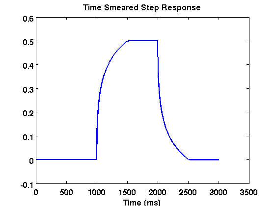

Earlier you said you could run some simulations. I'd love for you to do that. Would you please show the impulse response of a near-ideal array (with infinite or very long length and with densely packed point-sources), both with and without 3dB/oct. highpass? I'd also very much like to see what the effects of an increase in driver spacing are. I doubt he impulse response of a real-world line-array such as my own can be fixed by means of a simple high-pass filter.
bbutterfield, my own floor-to-ceiling array constitutes of thirty 3" full-range drivers. I've EQ'ed it as best I can, but the step response nevertheless is similar to the one you posted earlier.
If what you've posted is a step response, rather than an impulse response, I think the onset looks very nice, with no sign of time smearing. Band limited step responses tend to look like what you've posted, with a jump up, and then a decay back down. If you had a system with flat response down to 0 hz, then it wouldn't decay.
If you had a time smeared step response, it wouldn't jump up all at once, it would slew up as the more distant drivers added their pressure after some delay.

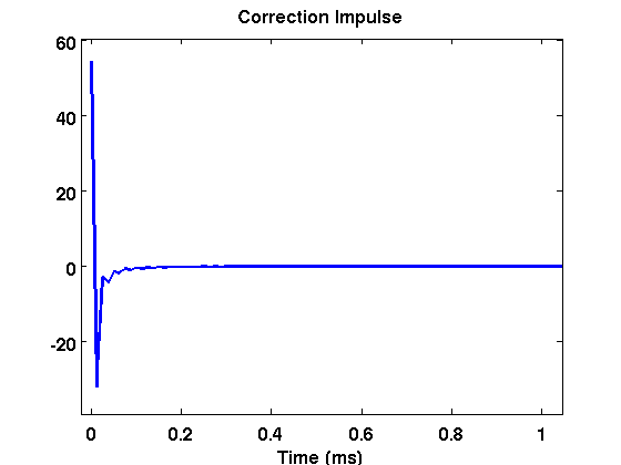

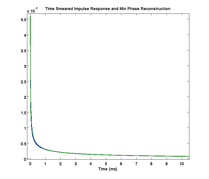

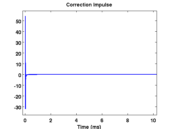

I have created 4 pictures that I am attaching below relating to a very tall, very densely packed line array.
I have included the impulse response (with minimum phase reconstructed impulse overlay), the step response, and the correction impulse response at 2 different zoom levels. If I convolve the impulse response with the correction impulse, I get a perfect dirac.
I hope these are informative.

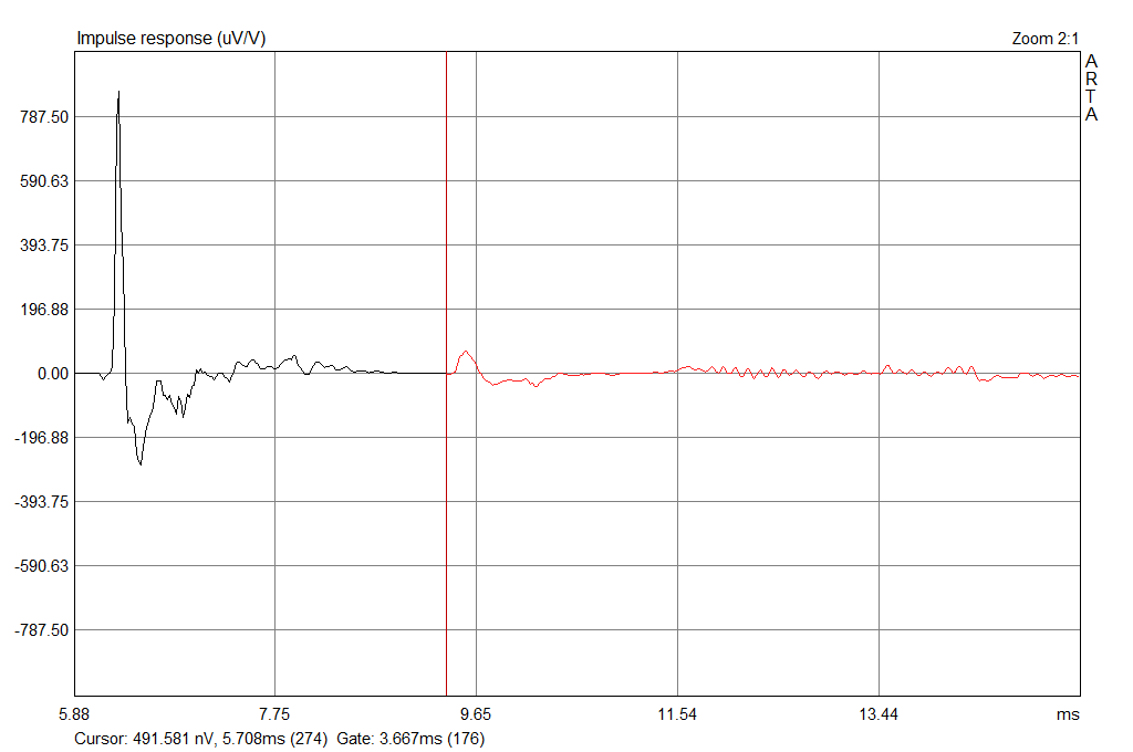

This is the in-room impulse response of my line-arrays:
Very! Thank you very much. I'm assuming the smeared impulse response of my line-arrays is caused by real-world limitations such as non-infinitesimal driver spacing and a not perfectly reflecting floor and ceiling. Do you agree?
