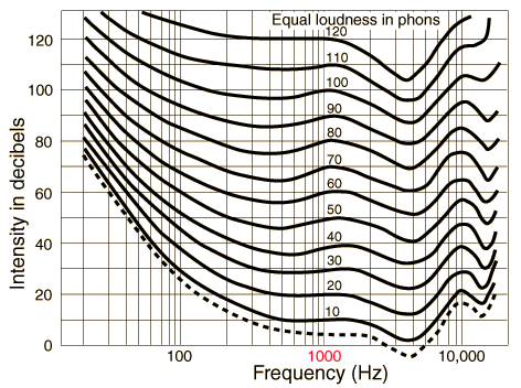

Are human ears most sensitive to the ‘mids,’ the region where I guess voices are usually? I have noticed in my car that running speakers from the head unit, a similar phenomenon occurs. When running them from an external amp (no sub) it seems less. I have no idea of the actual dB we're talking, but I'd guess all are well below 75.
yes
the lowest curve, "Hörschwelle" is the sensitivity
