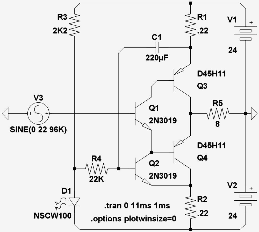

Completely dizzy: Muntzing round the SRPP totem...
I've never seen or drawn nothing like this before. Dunno how I come to it?
I think the tin foil helmet is becoming less and less effective over time...
Anyways, what exactly is this strange topology? And why does it seem
to be working? What more would it take to get this thing fireball worthy?
Needs a JFET up front, or something to provide the initial base current.
Its another unity gain wonder. Wonder how to get some voltage gain
out of it???
  • osid.zip
    osid.zip
Q1 never seems to shut completely off, but 100ohms across the
emitter of Q3 might draw a few extra milliamps just to be sure...
Its not in the drawing above, but probably should add it.
The sum of voltage across R1+R2, or maybe its the average...
Is held sorta constant by the series regulated thingie goin on
at the emitter of Q4 (does that makes it an SRPP?)
But then you got Q1 emitter down, Q4 emitter up, so sorta
halfways a diamond buffer too. Or one of them error correcting
something or others. I don't really know if thats how it works?
If the base currents required to drive Q3 and Q4 were equal
and opposite, the current in Q4 would be constant. But both
bases require a nonlinear swing of current, so Q4 is always
adjusting the sum of drive currents to keep the outputs in
proper balance.
Agh... Turns out its just another White Cathode Follower variant!
Only thing worse than a circuit that don't work, is one that DOES
but you can't explain why... Makin me even more nutz than usual.
Hopefully I got it figured now, we'll see what RBagger has to say?
Imagine the emitter of Q1 tied directly to the load, So's you can
see its actually behaving as a Sziklai Pair in conjuntion with Q3...
All of this sits atop an identical Sziklai Pair, Q2 Q4. Driven in
paraphase by the summation of errors detected.
For those reading, but not familiar: See Broskie's TubeCAD for
tech and background history on "White Cathode Follower".
The way I got it miswired, half Diamond Buffer style: Luckily
doesn't seem to ruin the WCF function. Q1 - Q4 does cancel
out an emitter voltage offset! I think the diamond buffer is
synergistic, but largely swamped out by the WCF effect.
Whatever... You got a new way to abuse four transistors.

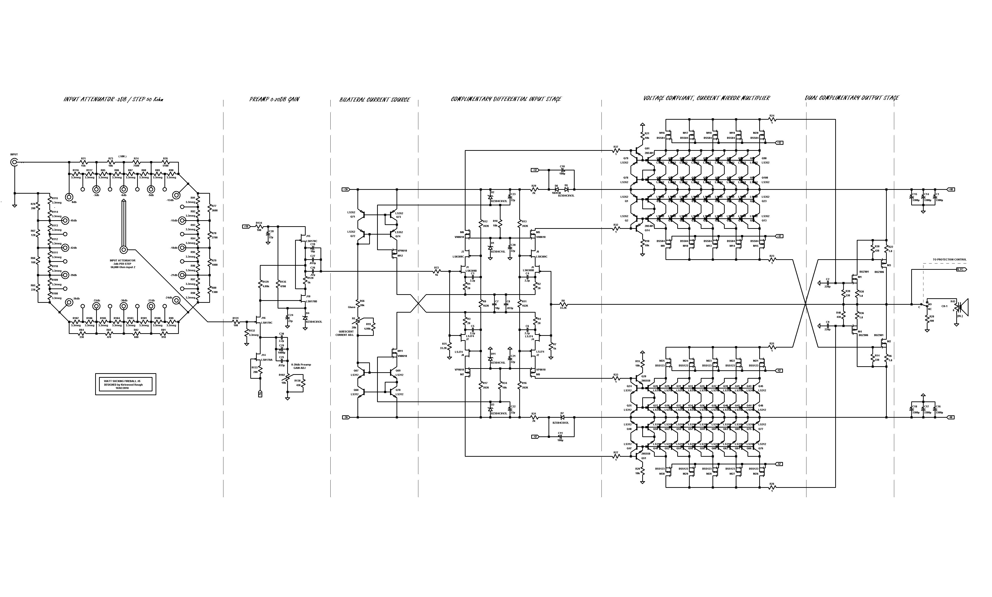

I am excited to say one of these days there will be a post here with my own watt sucking fireball amp. 300 watts in makes maybe 25 out...oh boy!😀
WattSuckingFireball#5
Finishing the construction and testing of the WattSuckingFireball#5. Were that all will go as theory and practice would incline, then P-Channel JFets and a new form of complimentary output stage will be in presentation this year. The hardest part of course being the stereo input step attenuator...........90 resistors.........It's Input stage features LSK389's LSK170's and LSJ74's this year

Linear Systems will be sampling the LSJ74's at the show. The WSF #5 is a design example of an Amp built around a John Curl-esque front end using these parts

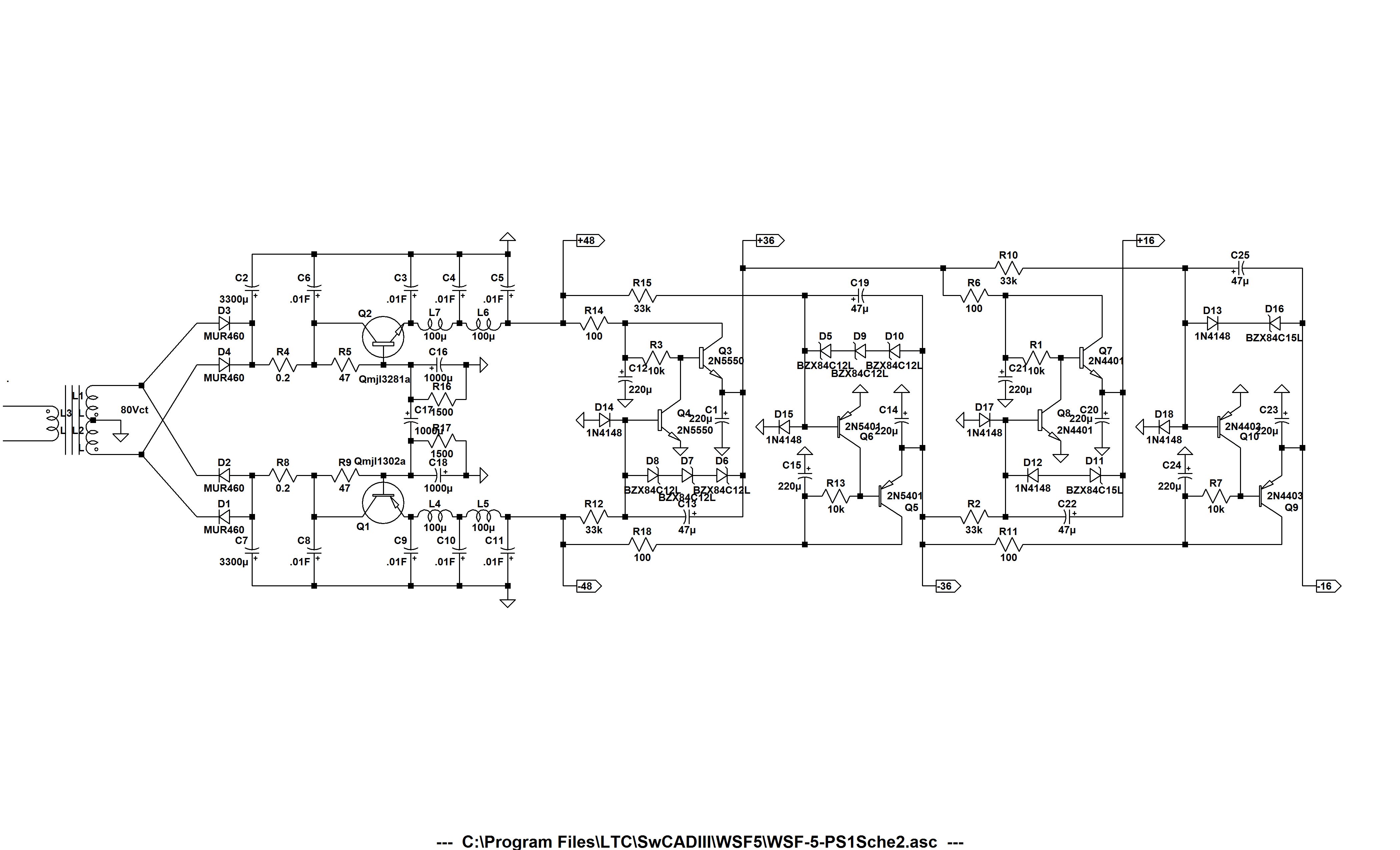

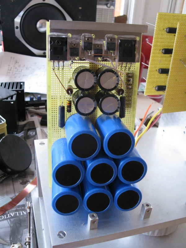

To run this Amp a fair amount of filter capacity is provided in its power supply producing little low frequency load distortion at high peaks. The power supply design is borrowed from last years amp but with additional stepped regulation for the preamp and front end drive. Liberal use of LS duals are in place strictly to minimize non-linearities in the audio current gain path. Though excessive, the TIM is much improved over a simpler Gm stage. Parts used in this Amplifier design are in current manufacture unlike some that were used in the 2009 WSF#4............As usual.................Kirkwood
