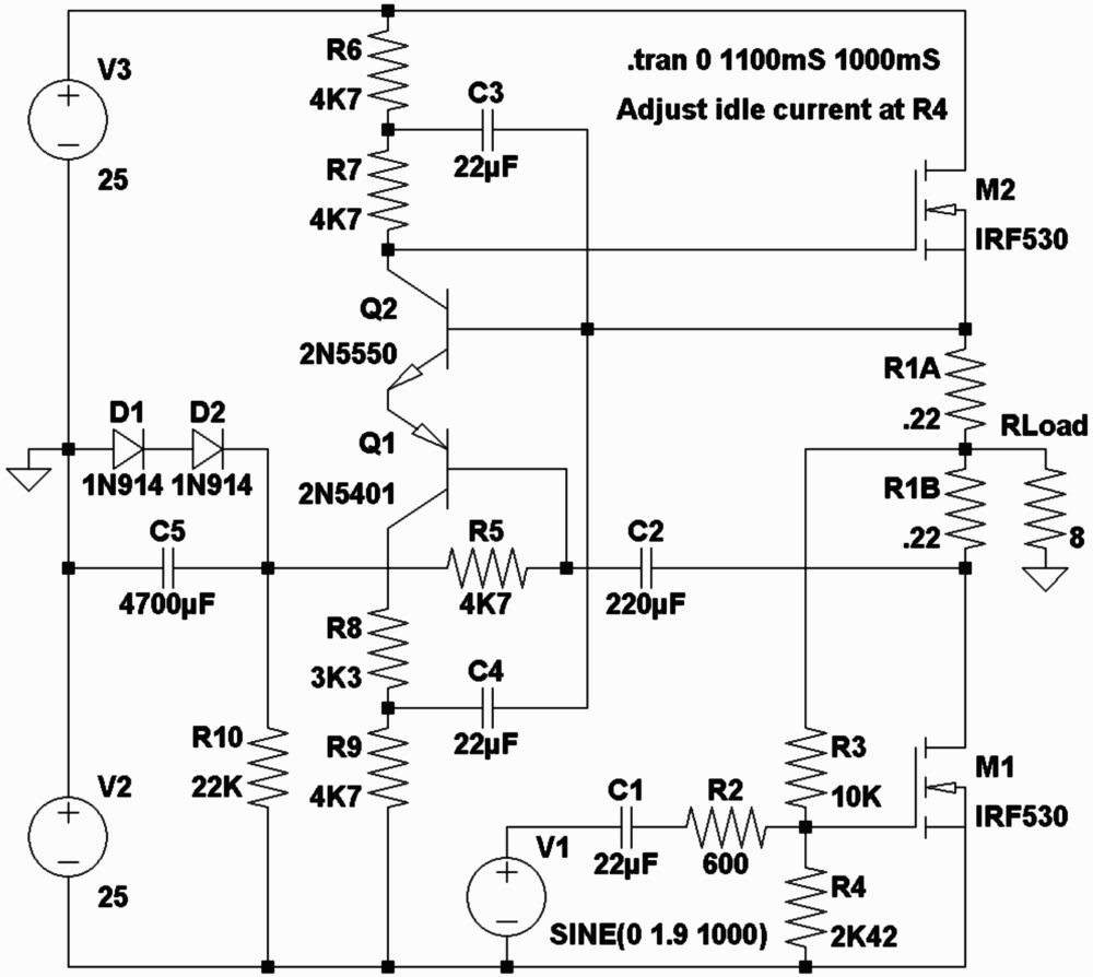

Well, an emulated triode created by a Zen or Schade external
feedback maybe a bit compromised by external phase shift.
But this network theoretically has only one Mu, and therefore
tries to make parallelishy triodelike curves.
But a real triode is never perfect sharp cutoff of one Mu and
Gm. Multiple semi-parallel paths of widely differing Mu and Gm.
"Remote cutoff" is always the reality. Smoking-Amp pointed
this out to me some time ago. I think he was right.
Examine four "perfect" triode curves (diode curve + Mu gain)
all slightly different. But individually each having parallel diode
shaped curves, that none by itself ever "leans to the right".
Four "perfect but different" triodes averaged in parallel, now
begin to lean over more like one might expect of a "real but
imperfect" triode... Representing if you will, multiple internal
paths with differing cutoffs.
Anyways, seems you are pushing more toward the perfect
parallel model with RFeedback. A lower internally averaged
Mu of itself wouldn't necessarily achieve the same thing.
Am I now randomizing you correctly???

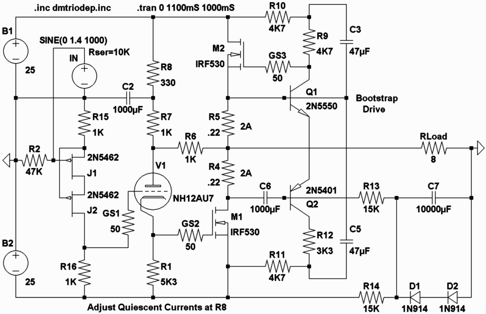

Let me ask the question another way...
If RFeedback is preferred for its linearity over internal
Mu in the lower end of this SRPP, then why choose a
Triode for this duty?
Why perhaps could an FET + BJT cascode in place of
this high Mu triode have not given a superior result?
RFeedback/RInput and not Mu sets gain and linearity
in both cases, does it not? Wouldn't a high Gm and
low Miller seem the more relevant figures of merit?
What other magical property could a Triode contain
(besides slow warmup and microphonics) to find good
abuse in this circuit where Mu doesn't seem to be
called upon to do anything?
Not arguing against it, just asking the thought process?
I definately possibly maybe woulda gone for Triode too,
just because... Now you know my logic, whats yours?

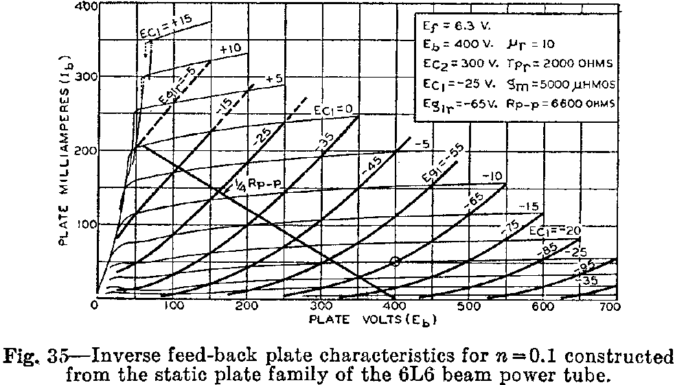

A triode wants to be a vacuum FET and behave like a Pentode. Only the
influence of space charge, an additional unseen control surface, is what
prevents it from being flat as sand.
According to OHSchade(BeamPowerTubesRCA1938) a screened Pentode
can be tricked to have the triode curves by application of a feedback
from plate to grid such as yours. Rather than the ordinary strapping of
screen directly to plate, as that simply re-connects internal Mu feedback.
But such an external path is sometimes difficult to DC couple, and if coupled
reactively, subject to phase shifts. Even if DC coupled, any externally wired
path that may replace or augment the function of Mu is longer and exposed
to more strays.
Does the presence of an external RFeedback path that overwhelms and
possibly even defeats the function of Mu take away from the "most linear
gain device" argument? Or is it simply averaging a "theoretically perfect"
(except for external path noise) Schade emulated triode of lower Mu in
parallel with the real one?
Pushing more toward an emulated device with parallel internal 300Bish
curves that look like multiple copies of a vacuum diode than the leaning
over set more typical of unequal internal paths (the set in your avatar).
But again, what is the cost in exposing this feedback to the longer
journey outside the gain device's internal fields? And does this partially
negate the primary advantage of the triode?
Document referenced above can be found at Pete Millet's site.
If isn't obvious what I'm driving at in that last rant.
You have stated that a minimal feedback is applied.
Yet this statement has ignored something important.
I see in your circuit very strong, fast, and slightly
non-linear internal triode feedback. In parallel with
slower, but more linear external resistor feedback.
But one way or the other, this circuit is linear due
to LOTS and LOTS of local feedback.
It ain't linear just because. A triode would otherwise
act just like a Pentode with the same Gm. Internal
feedback is feedback too, just more difficult to see.
I'm not entirely sure that sand linearized by similar
DC coupled local feedback wouldn't be just as good
or better. Probably boils down to how Gm is curved?
Any triode is lots of parallel triode paths of slightly
random statistical spread. Hard to fake that with just
one RFeedback wrapped around one whittled down
gain device of any type. But in your case, you seem
to be trying to skew the internal average in favor of
a resistively emulated external Mu, and narrow that
statistical spread in so doing.

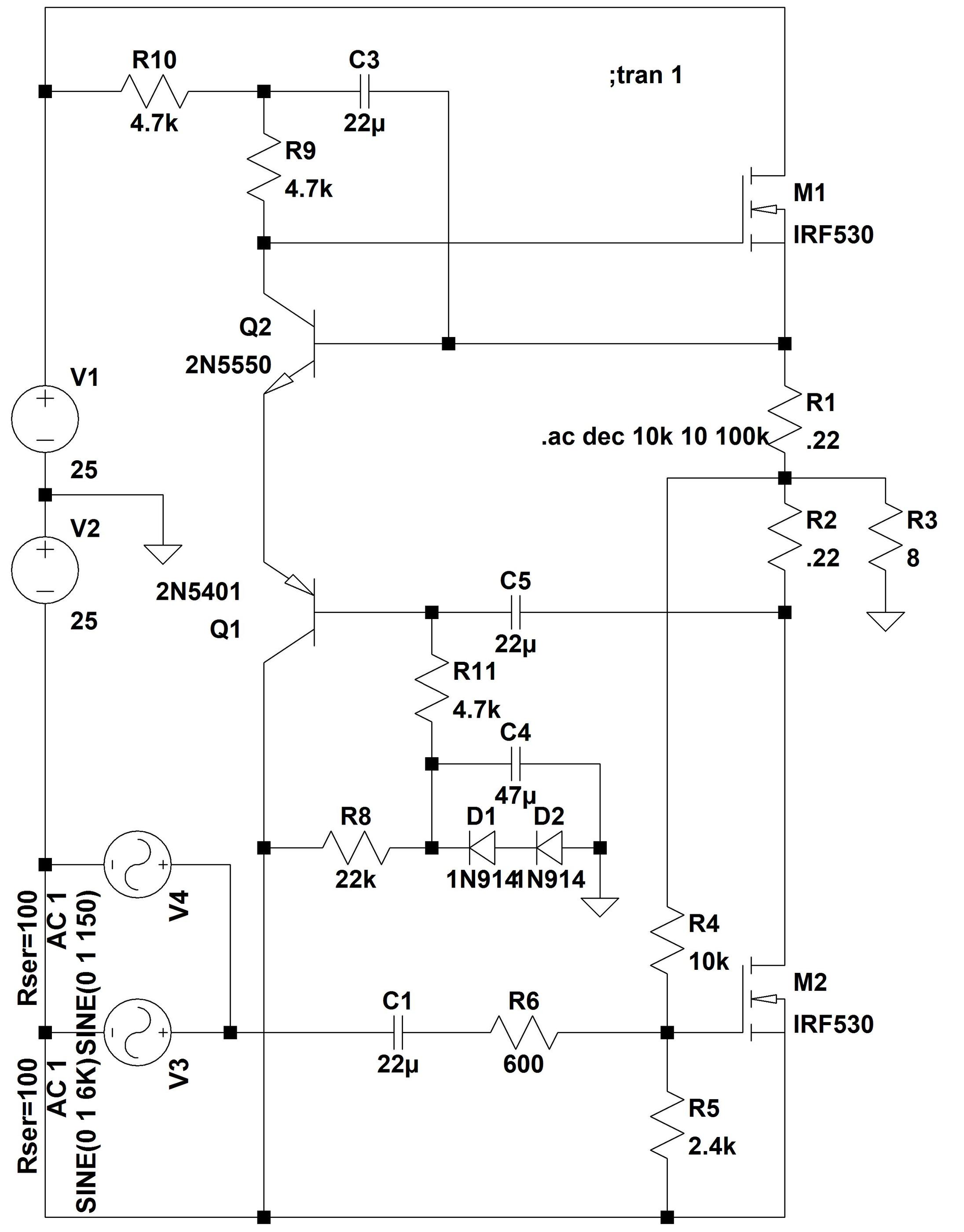

One further example to ponder:
A triode in real high A2 also acts like a Pentode or even
sand. Mu begins to lose influence as the space charge
thins out. Application of an external RFeedback could
bend those curves back into the normal Triode set...
I am trying to show the parallel between RFeedback
and Mu. They are really one and the same except
for the statistical spread of multiple internal paths.

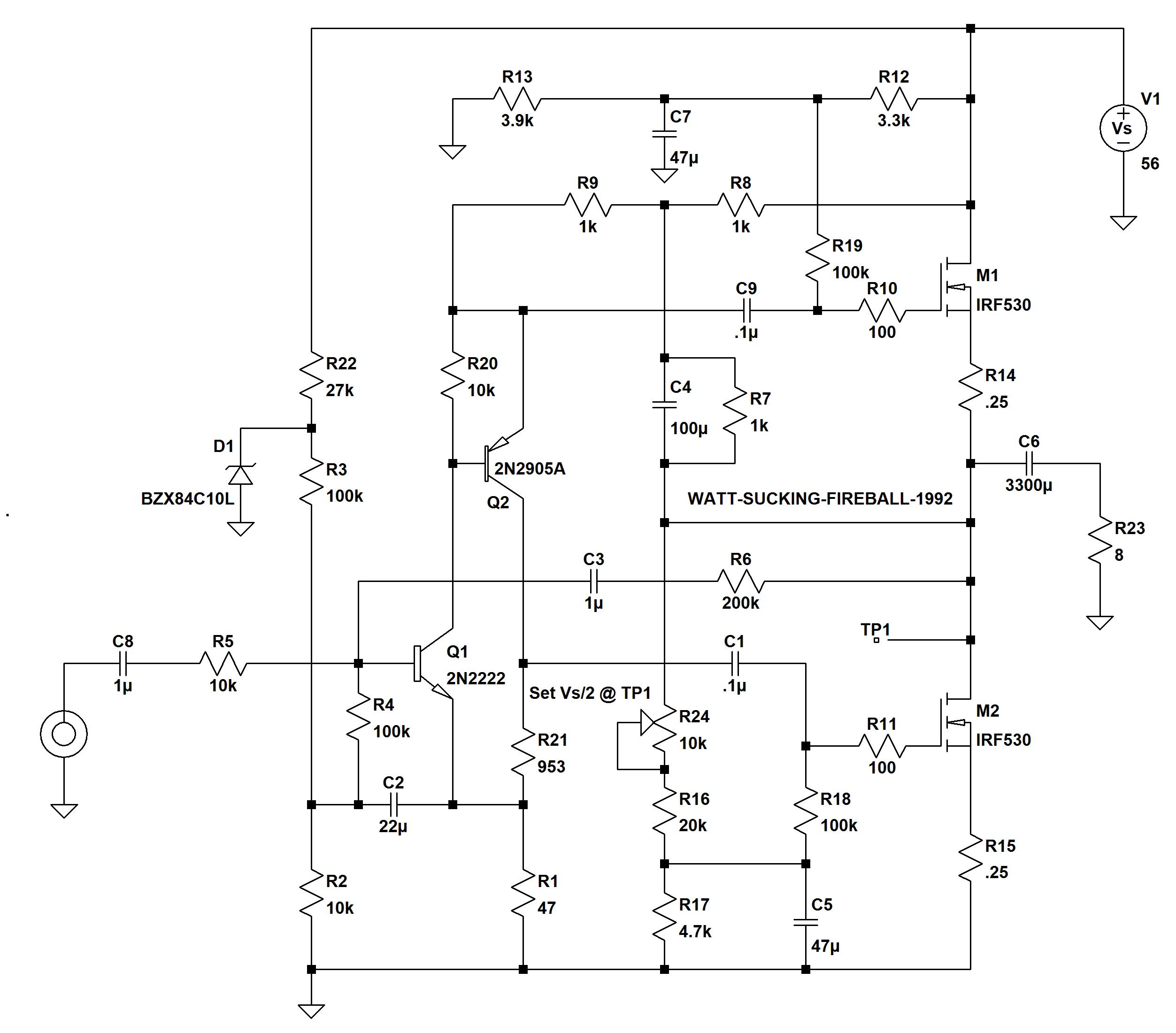

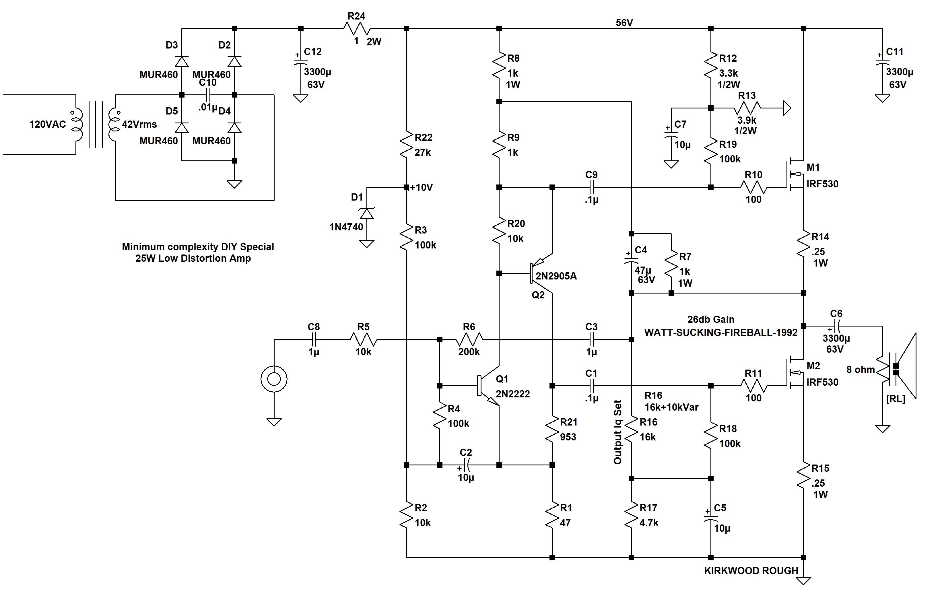

DIY Low Complexity AMP
This is the cleaned up version of the one above. It was a least-parts-count Guitar Amp that was designed for a friend in 1992. The circuit has a couple of curious features. There is local feedback, (R21/R1)+1, around the input transistor pair to set the gain there to 26db and then there is a global feedback, R6/R5 which sets the overall gain to 26db. Even if the R6 feedback resistor is removed the amp remains relatively linear with a open loop gain of about 52db. This design would reinforce a higher even order harmonic when driven hard which makes it more useful as a guitar amp since the even order harmonics are octave related and sound "FAT" or "Warm". R16 is a 16K in series with a 10K trim pot so the output stage quiescent current can be set from 0 to 1.4 amps. I set it to about 600 milliamps. Both MosFets are driven counterphase from Gate to source by relatively low, 1Kohm, impedances allowing ridiculous bandwidth if a compensation cap is not used across R6. This input stage is bootstrapped to raise the input impedance of the global summing node at R6/R5 improving linearity. The upper MosFet gate drive is bootstrapped to present a stiff modulating voltage source from gate to source and couterphase to the lower MosFet. Bias decoupling capacitors, C5&C7 improve the 56V rail rejection lowering hum. There was of course a Fet preamp driving this stage to suite the guitarist which at 1Vp or .707Vrms, drives full output without clipping. Heat sink temp rise should be kept less than 30 degrees C above ambient. A rule of thumb is to use .1 sq ft. per watt of surface area to keep the heatsink at 20 degrees C above ambient with convection cooling. This is generally true for black anodize sinks, vertically aligned with 1.5 to 2" fin height, and 1/4" fin spacing. Both sides of the fin are counted as surface area. This amp had a plate about a half square foot of 2" fin stock.
That's Cool
I think that's very cool. Its self bias feature is pretty tight <40 mv but it has to operate at a high watt bias current or all hell breaks loose at higher power. Input impedance has to be relatively low so the gate capacitance doesn't swamp the frequency response. Must work on split supplies to establish bias to the bipolar balancing act; I like self biasing methods, see Ref:2N4401-3-AMP; and the "gain pivot" for the amp is the transfer function of the lower MosFet. Zen kinda in a twisted way. This type of circuit convolution is exactly the type of thing that can nudge a change in thinking habit. Wierd, but cool. Below is what's left from optimising; Madman Muntz lives; the lower boot had little or no influence. There doesn't seem to be a convenient way to use the small bipolar devices in the signal gain path, the're busy balancing the output for all practical purposes. The intermods are a bit high but the circuit twist is interesting stuff.

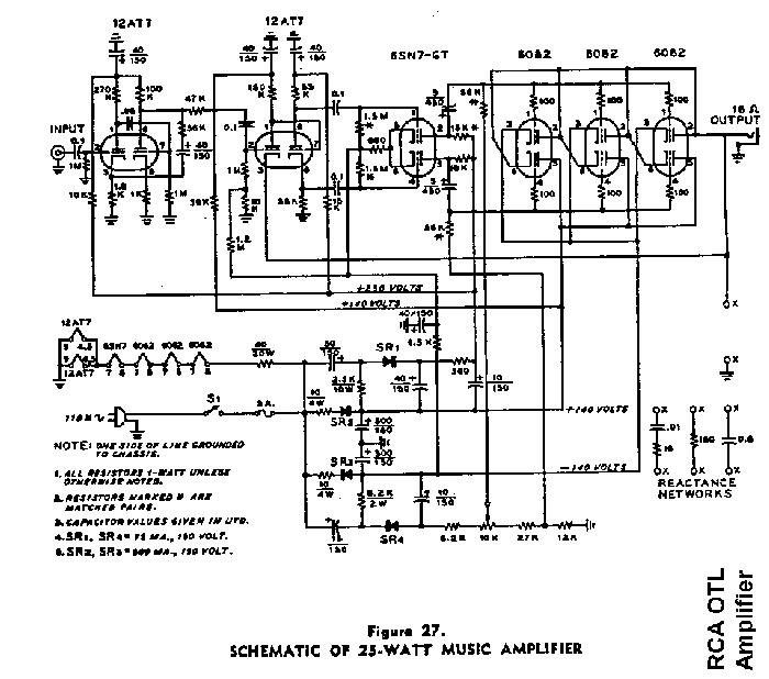

OK... I see it now a little clearer how the simplified fireball worked.
Seems a concertina splitter around Q2? Q1 handles the feedback,
and the rest of it is all bias... Very much a tube circuit translated
over to the sandstate, was that a Williamson???

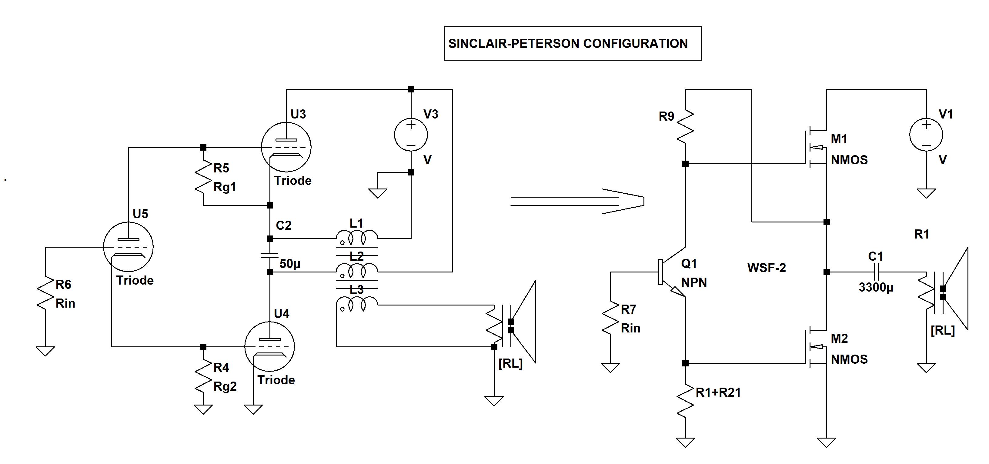

Mine's a Zen (Schaded MOSFET triode emulator) like you spotted
already. Then the SRPP above is a crazy hybrid of Nelson's Aleph,
Waveborne's servo'd CCS, and MJK (split SRPP resistor) style Anti-
triode. I claim nothing original.
The negative bootstrap was pretty pointless, I don't recall anymore
exactly why I thought it was necessary? Probably nitpicking idiocy.
You can loosen it up a little into AB by putting Schottky in series
with each of the output resistors. I'd suggest MBR745 to start.
Otherwise it tends to glitch a little hard when asked to do the
impossible. You noticed raising bias was another workaround.
You sho hooked on fireballs...
I had a more evolved version on my drive somewhere, but havn't
had time to go digging or reinventing that wheel. Maybe later...
This has the same issues (like pointless negative bootstrap) you noted....
But I post it for your entertainment, since I can't seem to find the one
I was actually looking for...
The challenge here was keeping the plate (triode feedback loop)
voltage high enough that the grid didn't start leaking. So I settled
for dumping only half the output swing back into Mu... I guess you
can call that a 50% ultralinear strapping...
I remind that voltage gain from plate to cathode is roughly 1/(mu-1).
Which at this ratio is totally voltage attenuation, but current gained.
Concepts stolen from Smoking-Amp and OldEurope.
About as weird as you could possibly hope for.
over to the sandstate, was that a Williamson???..
The difference between what the Sinclair/Peterson phase splitter does and a concertina is huge! Many early OTL amps used a concertina drive to the output stage which makes the upper tube of the output stage a cathode follower with less than unity gain while the lower half of the output stage has Gm x RL Gain. I think even one of the Futtermans was done this way. Though the classic RCA OTL amp used a balanced differential splitter, the upper portion of the output was, unsymmetrically, a cathode follower. This asymmetry is why so much gain prior is used and then thrown away with a feedback loop. The Sinclair/Peterson amp allows both tubes to operate linearly with gain the same way as a pair driving a push-pull transformer. There is no imbalance in the transfer function between the output conductance elements relative to their drives. Even a properly designed Williamson is very linear while requiring meager feedback.
Sinclair/Peterson huh? OK, got it...
For what its worth, I saw your bootstrap and knew you were
driving the upper device to have gain, and not merely to follow.
Williamson drives both devices to have gain, so maybe not that
different, except the transformer push pull rather than totem.
The presence of a bootstrap makes S/P not considered to be
a Concertina splitter? I'd never heard that distinction before,
but accept that I have not yet read the full history.
I guess Sinclair/Peterson is quasicomplimentary rather than
SRPP? As there isn't a series regulated follower thingie going
on upstairs... I tend to misuse SRPP to describe things that
maybe sometimes don't apply.

- Watt Sucking Fireball Series
