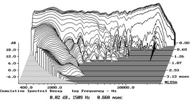

How do you interpret a waterfall plot? Also, is this a good one?

On the Z axis is the time elapsed... so farthest back is the starting point, and time elapses as you come toward the screen (or yourself).
The X axis is the frequency. The Y axis is the sound level, with the reference point at the top, and decreases as you go lower, or toward the bottom of the X-Z plane.
That's the worst waterfall plot I've ever seen!
The top (0 ms) curve is the output of the speaker and essentially represents the steady state frequency response.
Shortly after time 0 the input to the speaker is removed and we all wish the speaker would quite vibrating at that time. Alas, it does not and the lower curves represent the ouput of the speaker at the frequencies indicated along the bottom of the graph at the time indicated along the right of the graph.
A really good speaker would have pretty much died down within a few ms.
Reactions: oltos

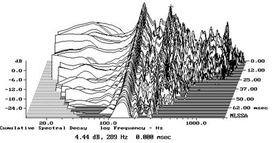

the speaker in question is the Athena F2, a 2 way speaker system with 2 8" bass drivers. The waterfall plot was measured by a stereophile reviewer.. "Fig.2 Athena AS-F2, cumulative spectral-decay plot calculated from the output of an accelerometer fastened to the cabinet's side panel 12" from the top. (MLS driving voltage to speaker, 7.55V; measurement bandwidth, 2kHz.)" He did a couple of other waterfall plots, but i don't really understand which is the right one to be looking at.. Here is another one of the same speaker, using different conditions " Fig.7 Athena AS-F2, cumulative spectral-decay plot at 50" (0.15ms risetime)."

OK, in that case, what this plot is telling you is where the natural resonant frequencies of these panels are and their relative magnitude. Because that sort of accelerometer is not calibrated, you can't really judge how dead the panel is, just where the modes are. The ideal cabinet would give zero output at all times and at all frequencies.
The thing you can do to get an idea of the relative severity of those panel modes is to replot the impedance magnitude and phase data on a complex Z plane (Stereophile, for some reason, doesn't do this, despite it being a superior way to visualize an impedance plot). You'll see a series of big circles, which represent the fundamental speaker resonances. Look at the frequency where the waterfall plot shows a ridge; if the Z plot shows a little circle or kink there, the panel resonance is probably significant and ought to be dealt with. If the Z plot is smooth there, the resonance is probably insignificant.
