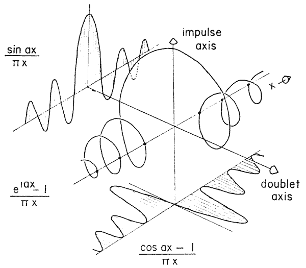

planet10 said:This isn't an impedance plot, but is how they should look... rotate so one axis disapears (ie look down the spiral) and you have the plot SY is talking about, make any of the other axes dissapear and you have the amplitude or phase plots.
dave
Someone resurrected this thread, and I happened to see this post from Planet10. This is one of my favorite type of plots showing the complex nature of a waveform:
I think that the complex signal (the spiraling thingy at center) is just being decomposed into/projected onto its real and imaginary parts/planes. Those quantities are not phase or amplitude, they are the real and imaginary components. The amplitude is the magnitude of the complex signal, which you can interpret as the distance from the central axis around which it is spiraling to the signal at any point in time, which is a line segment. The phase is the angle that segment makes to a certain reference axis (e.g. positive "doublet" axis type of orientation in the figure) which is defined as the 0 degree phase angle. Of course there are the mathematical equations that can be used to calculate amplitude and phase, but its also good to know how these quantities are represented in this kind of plot.
I always found a certain beauty in signals explained in this way, but the amplitude + phase representation is easier to interpret in meaningful ways.
