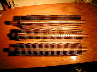

G.Kleinschmidt said:huge storage tank.
Beat you to it, mate.
Unfortunately, the 75' SS braided hydraulic hoses with pressed-on fast connectors and a Danfuss central heating waterpump are lying idle, after the hemorrhoid-like exit of the Pass Monster amp project.
(same goes for a quartet of silly size toroidal transformers and two heat plates)
LOL! Are you serious?
