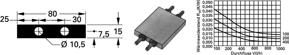

What will 5,000 watts of heat for a 3" x 16" plate at 50C make you do ?
(flow of >3 gallon/minute)
Ahhhh....gum up my keyboard?

To Danny: the poor heat conductivity of water doesn't really factor into the heat transfer equations. If you break down the heat transfer mechanisms, it looks like this:
1. Device => Water at edge of pipe - Mechanism: Conduction through some heat transfer compound, into the metal that the pipes will run through, then into the water right at edge of the pipe.
2. Water in pipe near device => Water in pipe at heat exchanger/radiator - Mechanism: Convection. The heat's just part of the water that is being pumped around. If you don't understand, its so simple to me that I can't actually explain it. The higher the velocity of water, the quicker the heat is transferred.
3. Water in pipe => Air at edge of heat exchanger (HX)/radiator - Mechanism: Conduction. The heat is transferred to the air through the metal of the HX/radiator. Having the water traveling through a pipe gives you 270-360 degrees to conduct heat away (the heat doesn't go 'down' very well) from the pipe, rather than the 180 that you get with a flat face of a normal heat sink.
4. Air at edge of HX/radiator => Bulk Air - Mechanism: Convection. Lower density, hot air rises into the bulk air, drawing in the cooler bulk air.
For the heat sink arrangement, the mechanisms are as follows:
1. Device => Heat sink - Mechanism: Conduction. Again through a heat transfer compound, into the heat sink.
2. Heat sink => air at edge of heat sink - Mechanism: Conduction. As above
3. Air at edge of heat sink => Bulk Air - Mechanism: Lets say convection.
The big gain of the water system are that
A. The temperature gradient between the device and the water in the pipe can be kept constant at T(device) => T(bulk air/ambient), depending on how well the heat exchanger works. This is beneficial because you're only conducting through a small distance of metal, basically pipe wall plus the contribution of the mounting block (which should be fairly minimal).
For the heatsink, you have to conduct through a comparatively large distance of heat sink before reaching air.
B. Moving the heat exchanging area away from the side of the enclosure means that you get more than just heat transfer in 180 degrees, and you can design a much more efficient system: eg thinner fins closer to the bulk of the heat and better air flow (more convection.
Essentially you're right, its just relocating the heat, however it does allow much better heat transfer by cutting down the slow heat transfer sections (conduction).

Three forms of heat transfer (heat flux/unit area).
Conduction q=k(T2-T1) Metal to Metal, Liquid to Liquid. Liquid to Metal and vice versa
Convection q=h(T2-T1) Gas to metal, Gas to liquid and vice versa
Radiation q=e@(T2-T1) radiating object to anything and vice versa
@ is Stefan-Boltzmann constant - can't find sigma
Do not bother with Radiation (emmisivity) It is negligible. If you can't feel the heat on your face (like being next to a campfire) its not appreciable and can be omitted. Now if the heatsink were glowing hot, you would feel the radiation and it would matter.
As someone said earlier, painting a heatsink to gain emissivity is counterproductive, as it would be one more layer to conduct through - unless of course the coating has higher conductivity than the sink.

Correction:
As mentioned, three forms of heat transfer (heat flux/unit area).
Conduction q=k(T2-T1) Solid to Solid
Convection q=h(T2-T1) Fluid to Fluid, Fluid to Solid, Solid to Fluid

Actually, even if the coating had a higher heat conductivity than the heatsink itself, its still not going to be beneficial. You said it yourself: its another layer to conduct through.
The radiation equation actually should have dT^4. Its the ^4 that dictates how useful radiation will be: while its small, the contribution will be minimal, however as it increases, the contribution increases very rapidly.

I stand corrected on both items.
I was preoccupied trying to find the Sigma symbol that I totally forgot about the power of the fourth on the differential temp...at heatsink temps we are dealing with 25C - 80C, I still think Radiation can be neglected....but you are absolutely correct - as it gets hotter, it plays a more important part of the overall heat transfer
