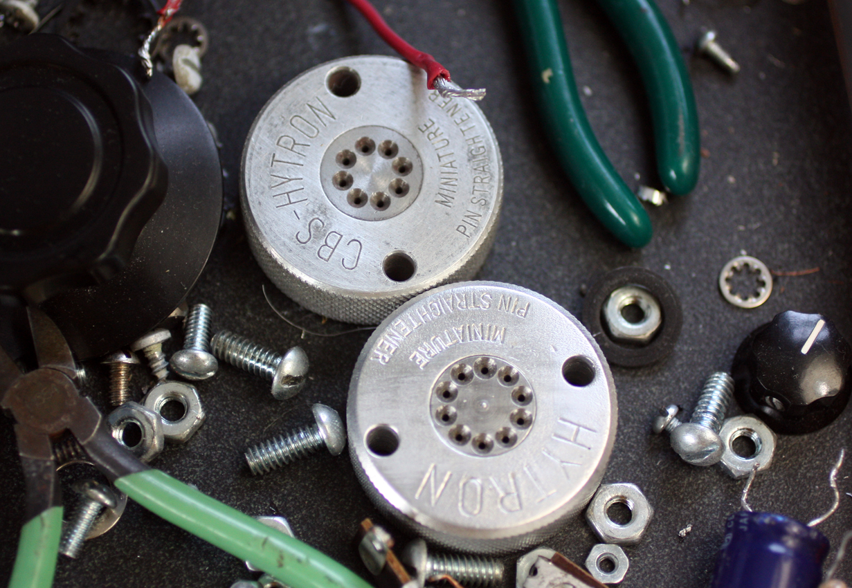

I picked up a couple of the vintage milled aluminum billet ones off ebay (shown earlier in the thread). They come up from time to time. They have slightly conical holes to ease the straightening.
I didn't know they where Mullard, I have 5 of those that I got from my father, they are probably close to 80 years old but work perfectly.Langrex in the UK have these .... 2 for £1.75!
Get a pin straightener ............
