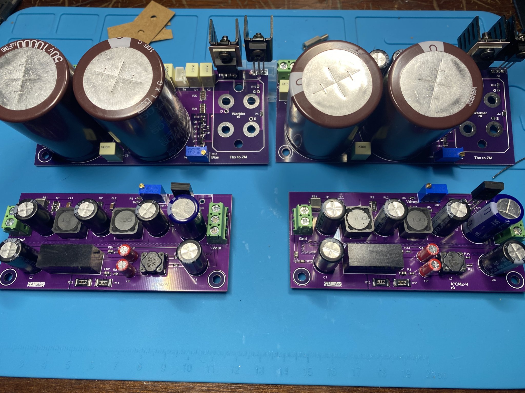

I managed to put two Warbler modules together and the power supplies for them.
On the power supply pcb I have a hf filter followed by a cap multiplier for the high current path. From the input I power also an isolated dcdc converter that generates -30V.
Now will need to test everything.

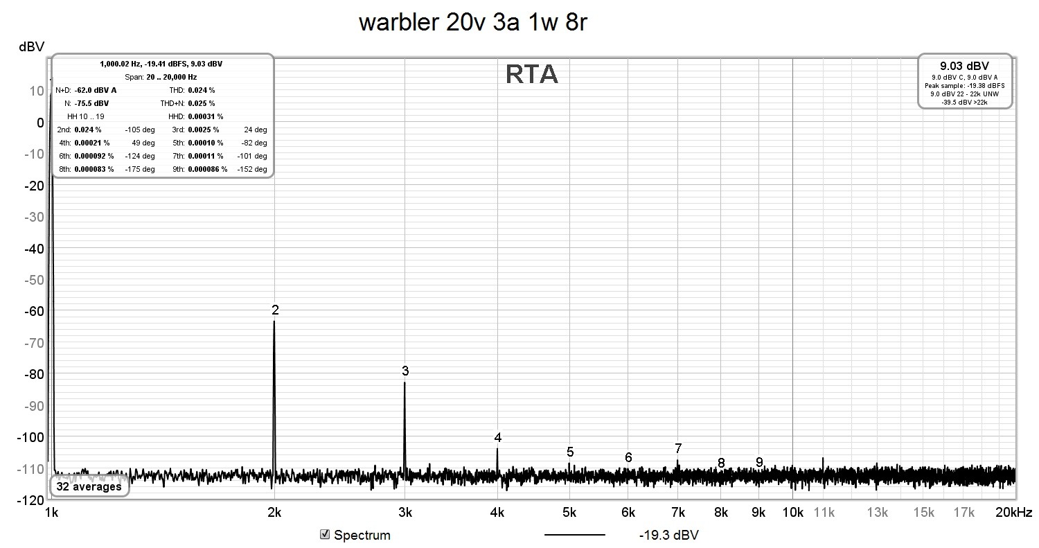

I tried both channels on the bench power supply. Both overshot to 0.5A as soon as I power them up then go to 0A and after a few seconds the bias starts to raise slowly to the preset value.

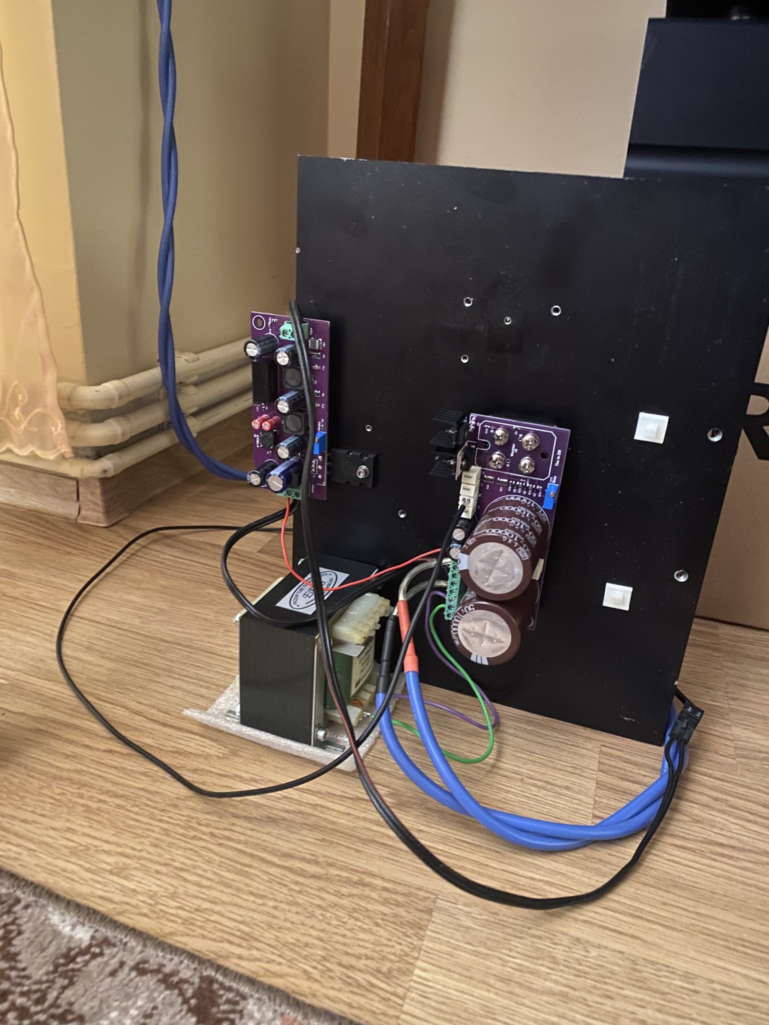

I connected in the system both channels and they both sing.

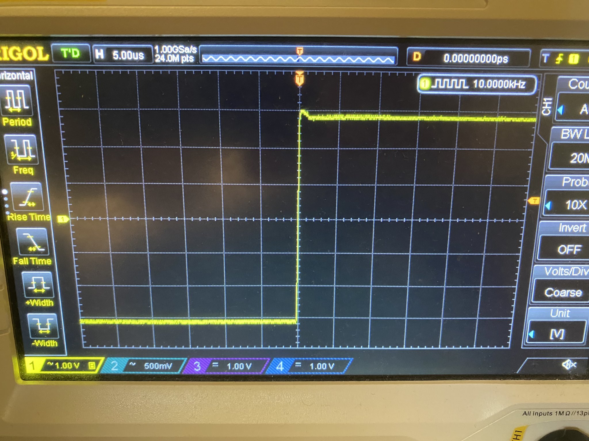

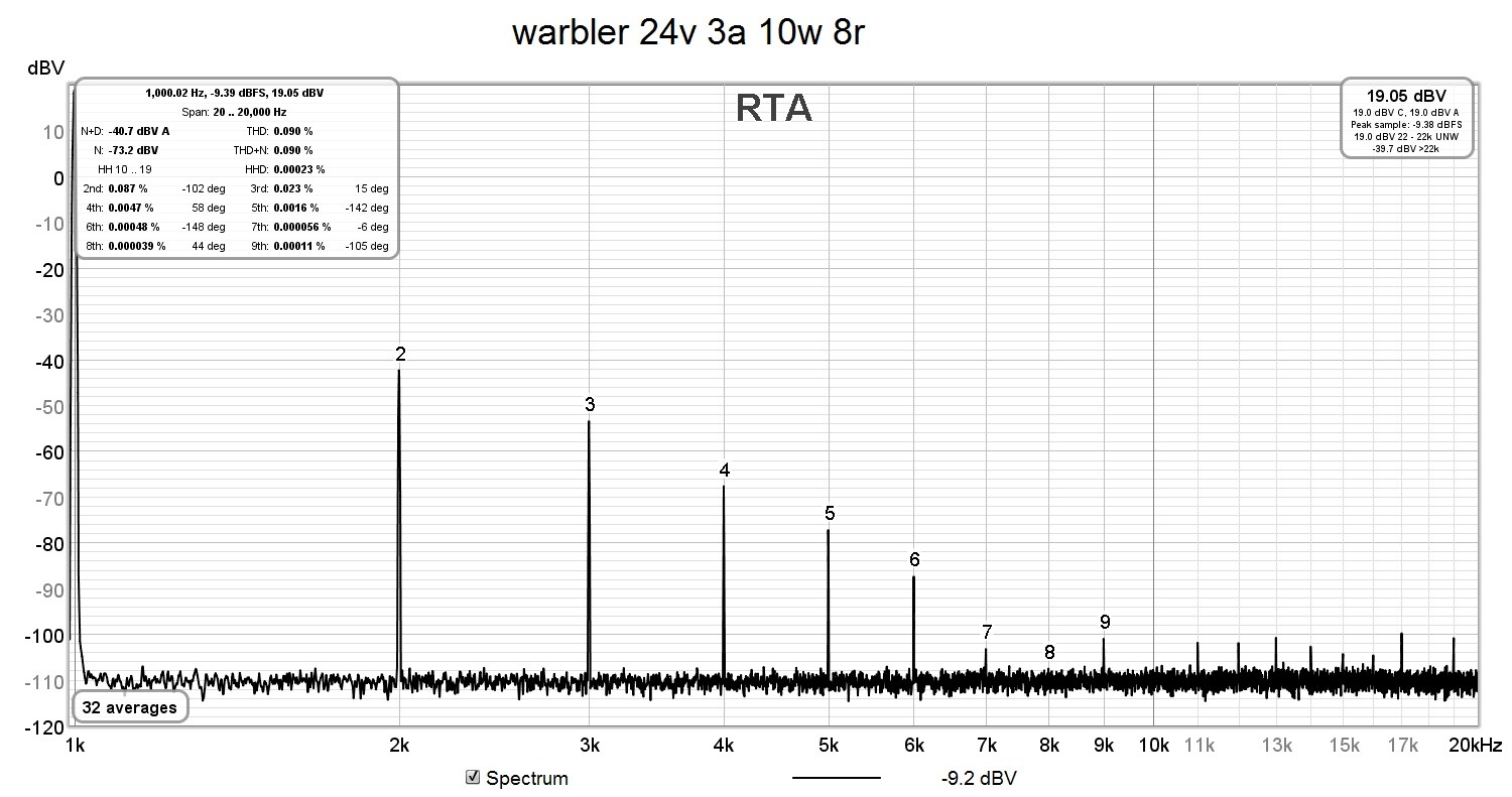

All good till now. Tomorrow I will do some ffts and a square wave test.
Everything seems in good shape.
Now it’s time to replace the heatsinks 🙂
A big thanks ZM !
A big thanks ZM !
