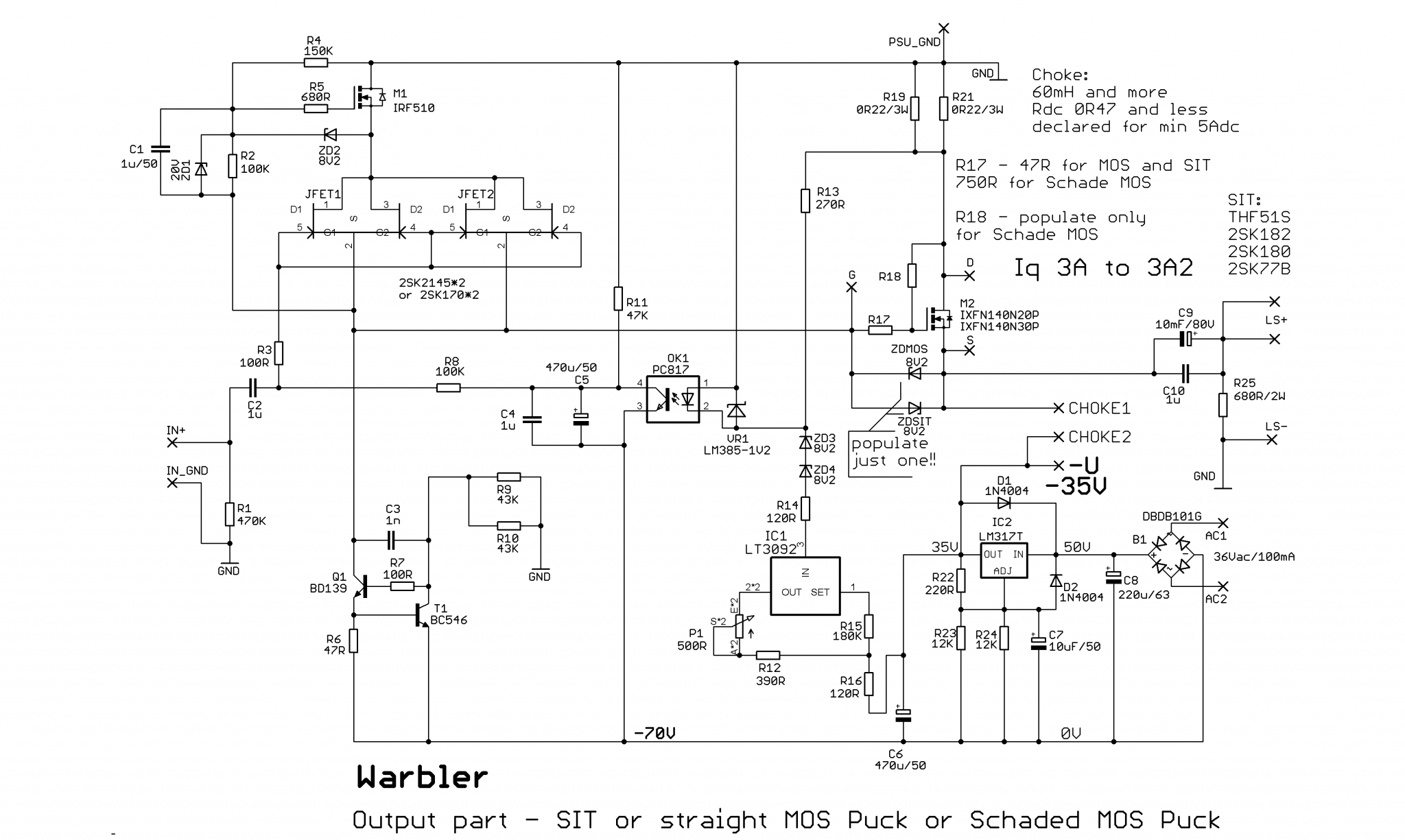

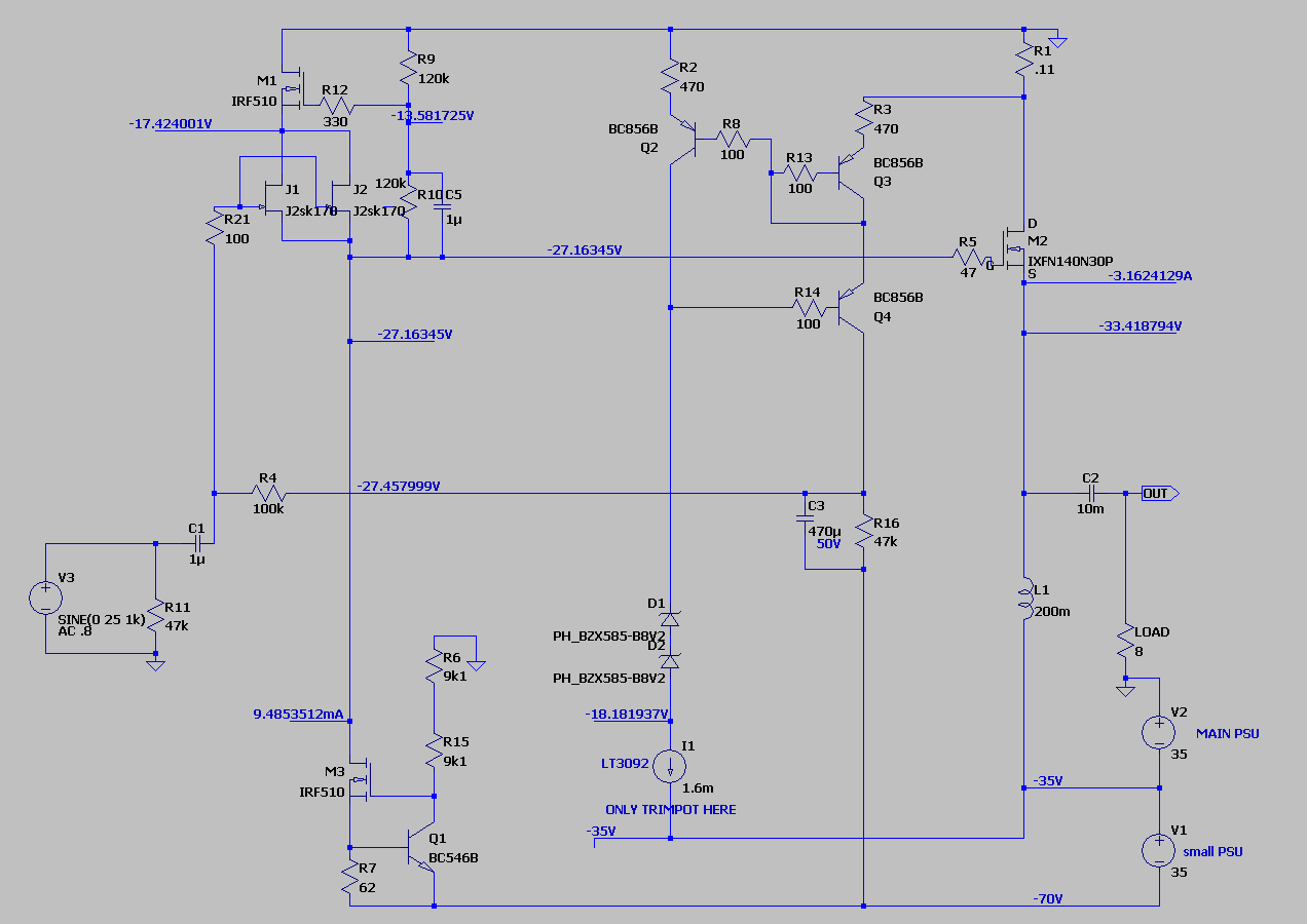

as seen on schematic - projected (negative) rail voltage is around 35Vdc; projected Iq is in range of 3A to 3A2, using IXYS Puck MOS, or same in Scade config, or Tokin Puck SIT
2SK2087C - rail can be lower , Iq in range of 2A
Ben Mah did play with several iterations of choke loaded amps, so he's a guy with best xperience which ready made chokes are good
All I have now of chokes ( no intention to chase better ones, too many amps) are two pcs of so-so similar cannibalized Microwave Owen xformers; while inductivity is OK ( 200mH), their Rdc is catastrophic - slightly under 2R

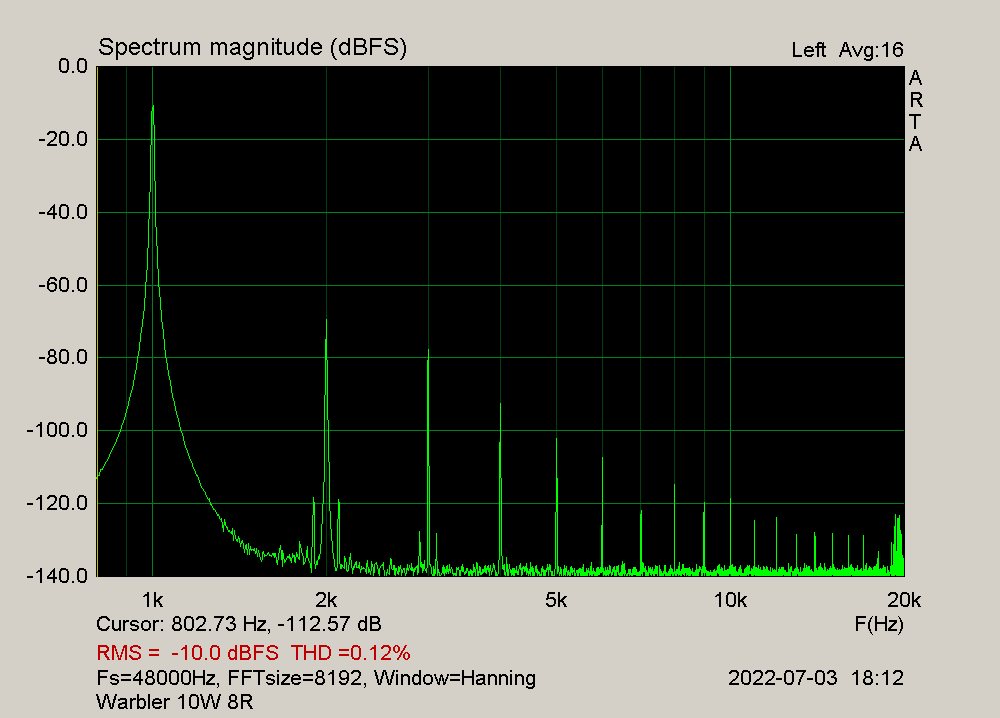

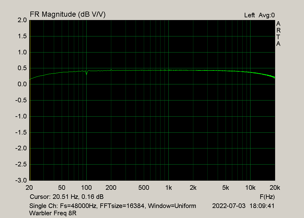

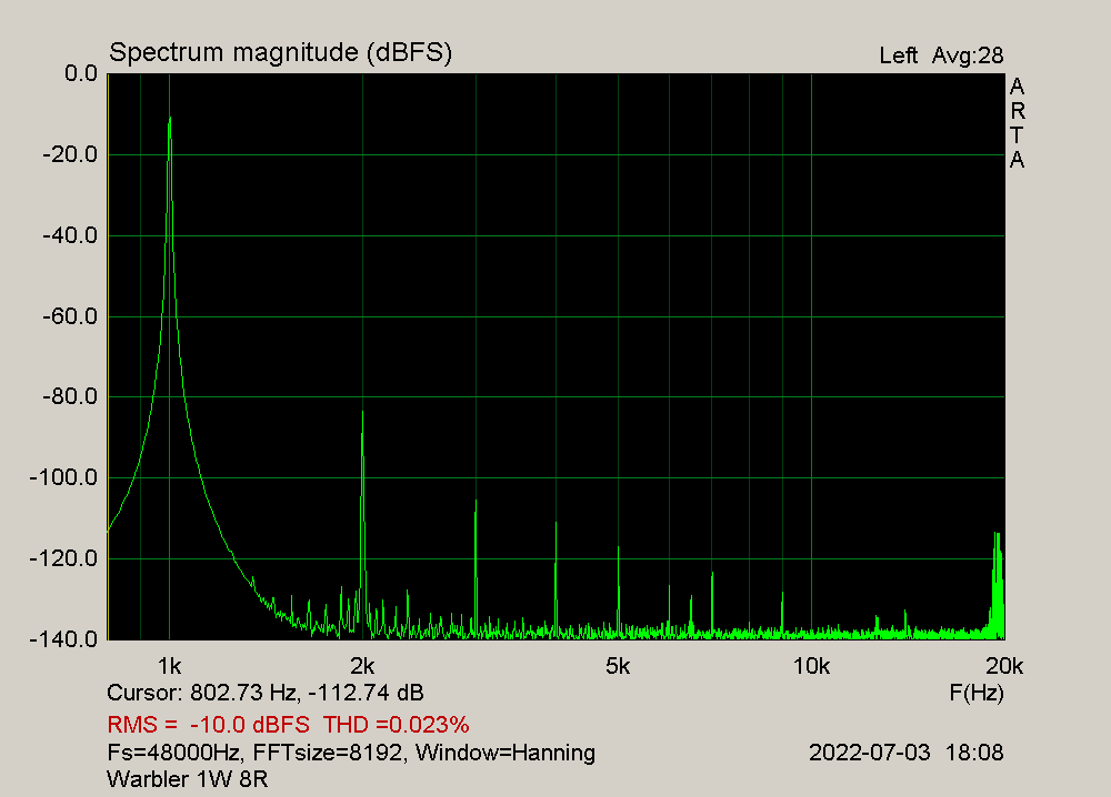

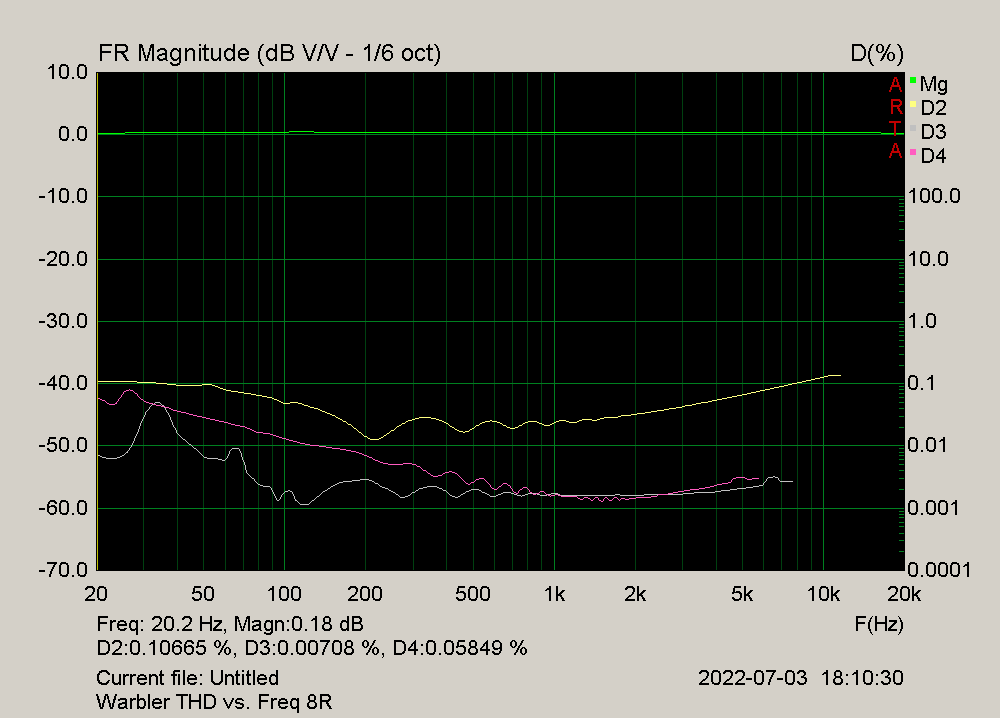

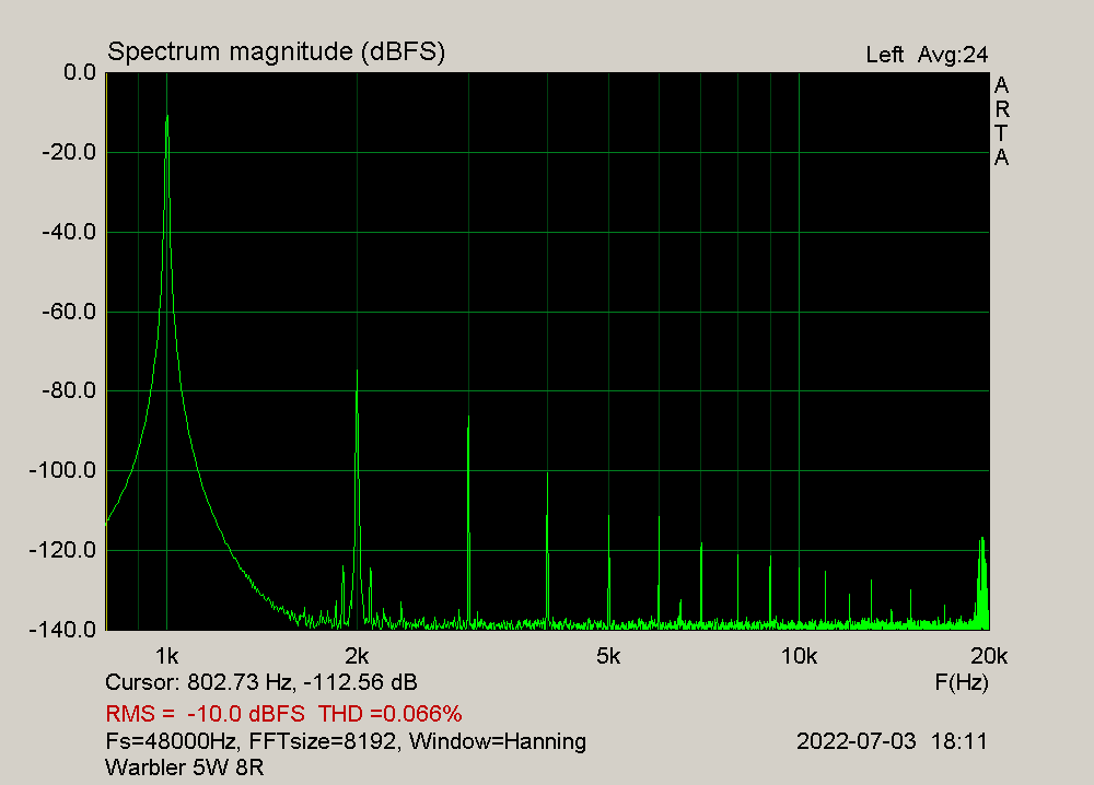

So, graphs I'm going to show are up to 10W and no more - due to two reasons:
- my THD measuring apparatus is good (amp input signal department) up to 10W@8R voltage swing and I wasn't in the mood to work on that further
-had a setup with 30Vdc rail; lazy to make necessary changes on T-Bed for more
So, with proper rail voltage, proper loading choke ( Rdc much lower), you can expect to see lower THD at 5W and 10W levels, and you can expect steady 40W@8R, taking in account that SE Follower isn't PL XA25, cruising near max power all day long
again, test setup - 30Vdc rail, Iq 3A

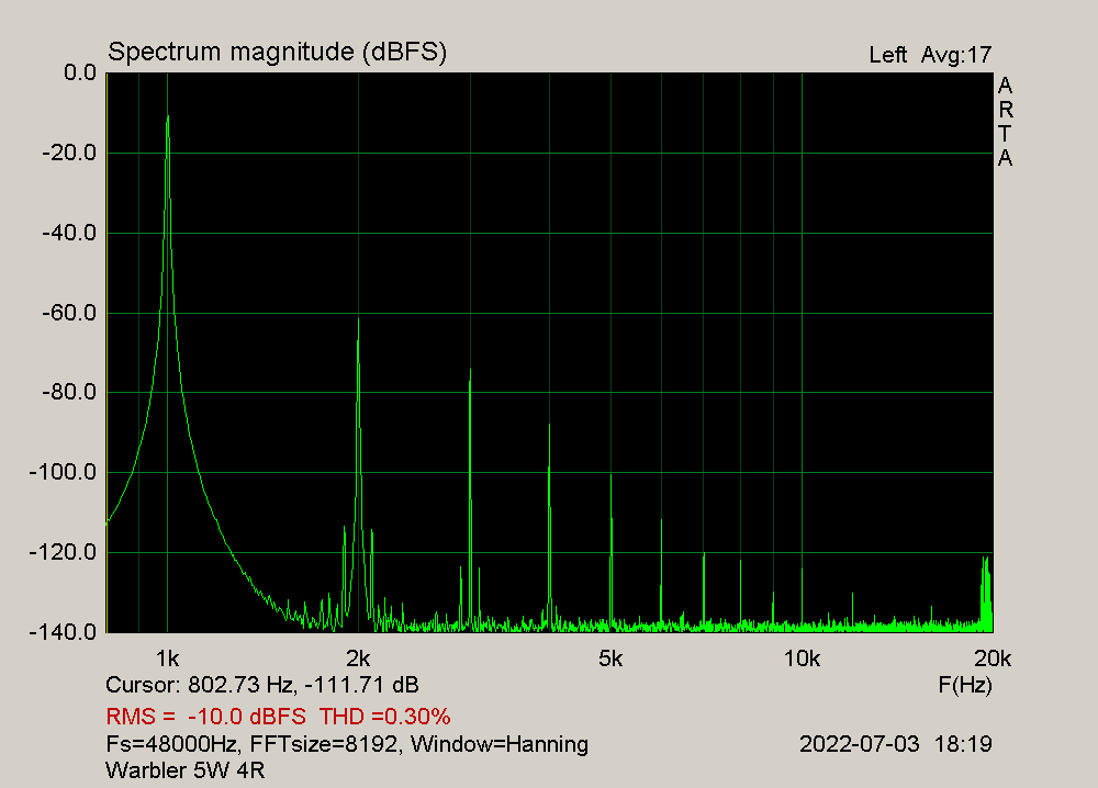

so, for start, straight MOS iteration, 8R load

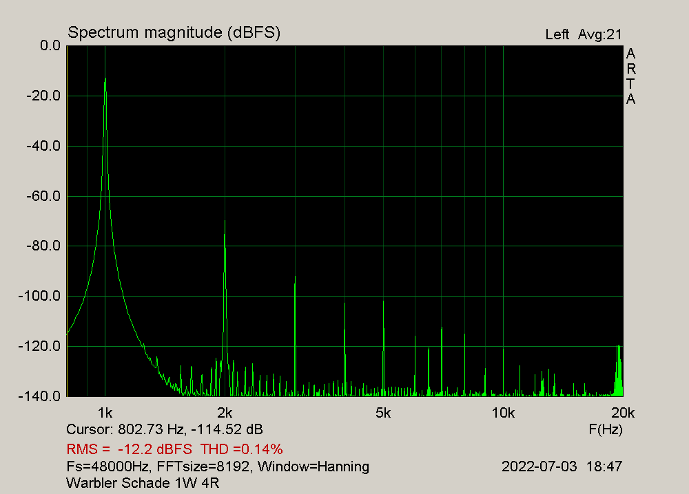

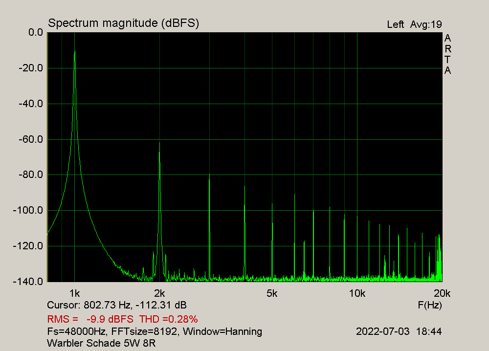

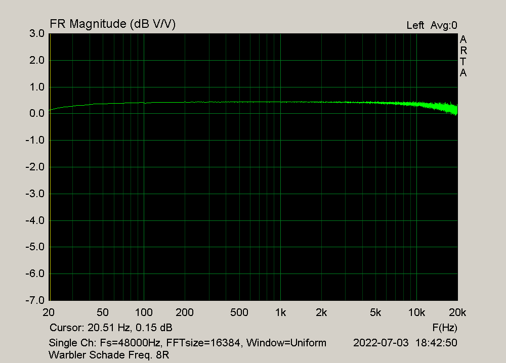

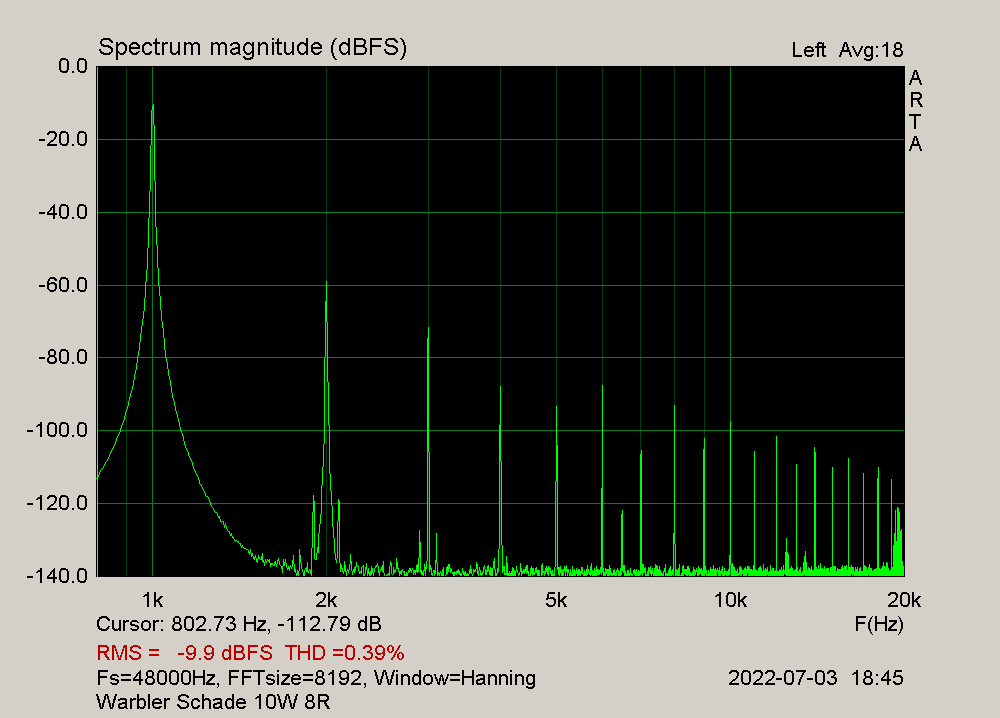

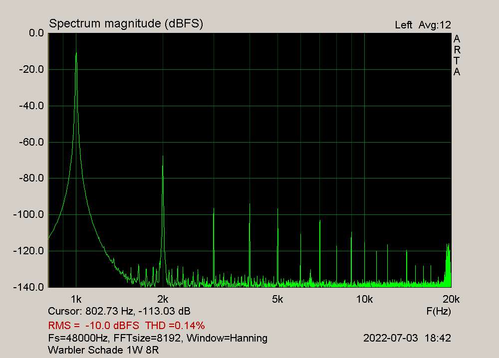

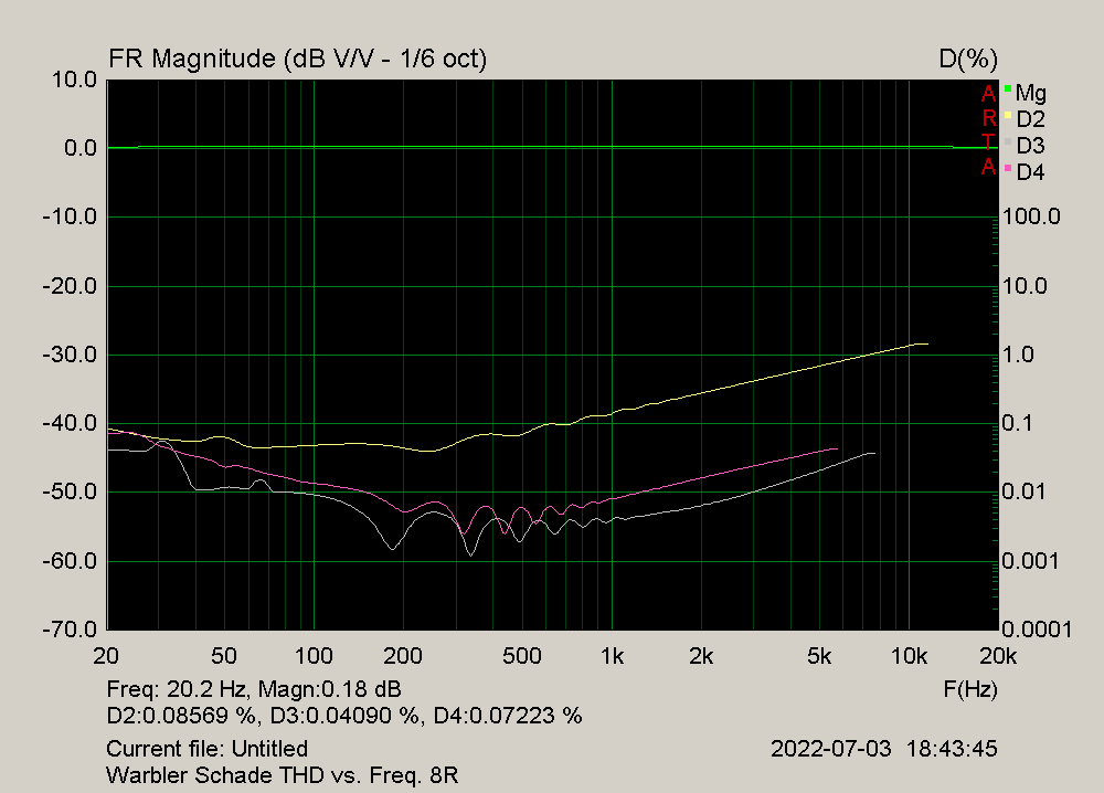

Schade MOS , load 8R
as is normal with Scade arrangement, thing always get interesting above 10KHz or so, but that's nature of the Beast; there are different ways of doing it, Papa did show his trick with input xformer in Singing Bush predecessor amp - BAF 2015 .... anyway, 101 way of skinning virtual Cat

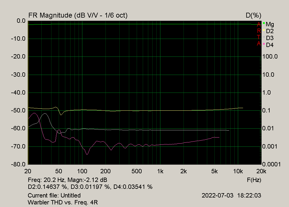

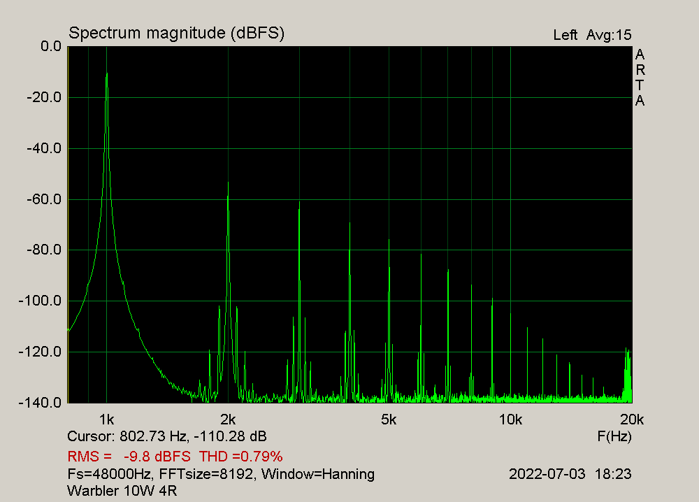

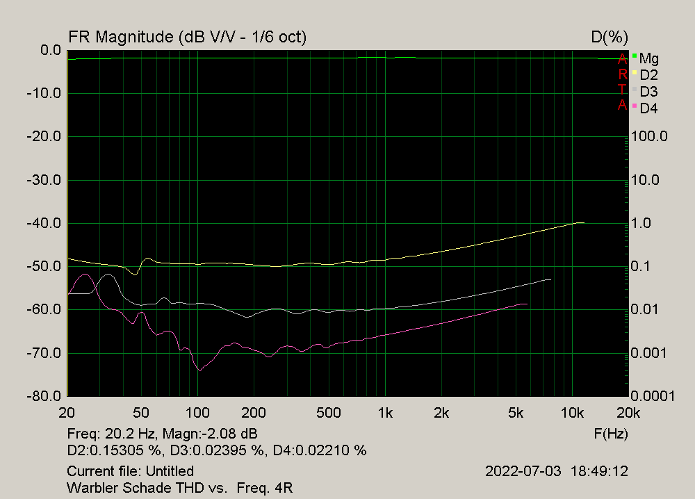

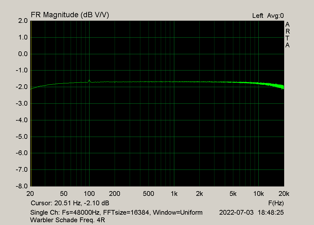

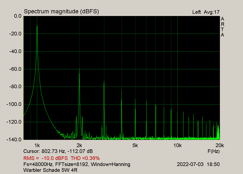

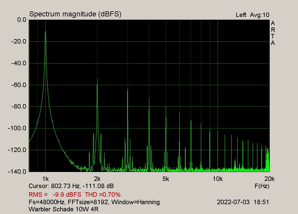

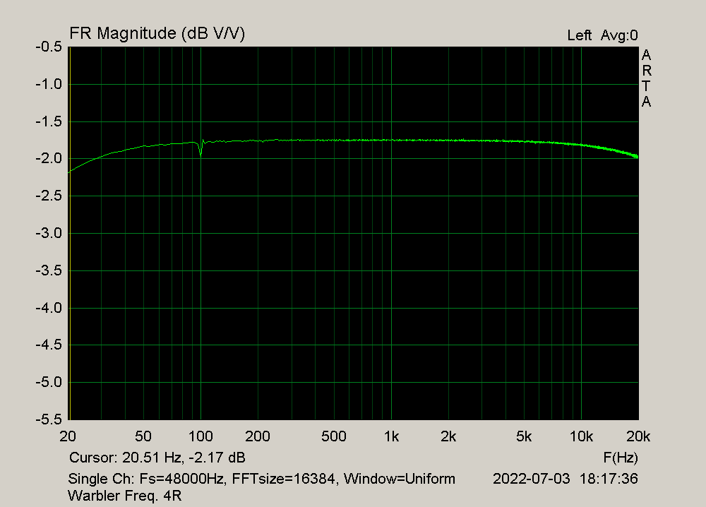

Schade MOS, 4R load
in fact, I believe there is a way of doing it even better, mostly thinking of better Iq stability in dynamic domain
stiffer Iq with large signals and much faster recovery
oh well, can't always end with what's drawn on first napkin, sometimes second one is better
:rofl:
in short, out with optocoupler, in with current mirror
Warbler postponed to final version, whichever one ends as one

oh yeah, specification on schm is utter wish, say - data which I will give to my custom winder

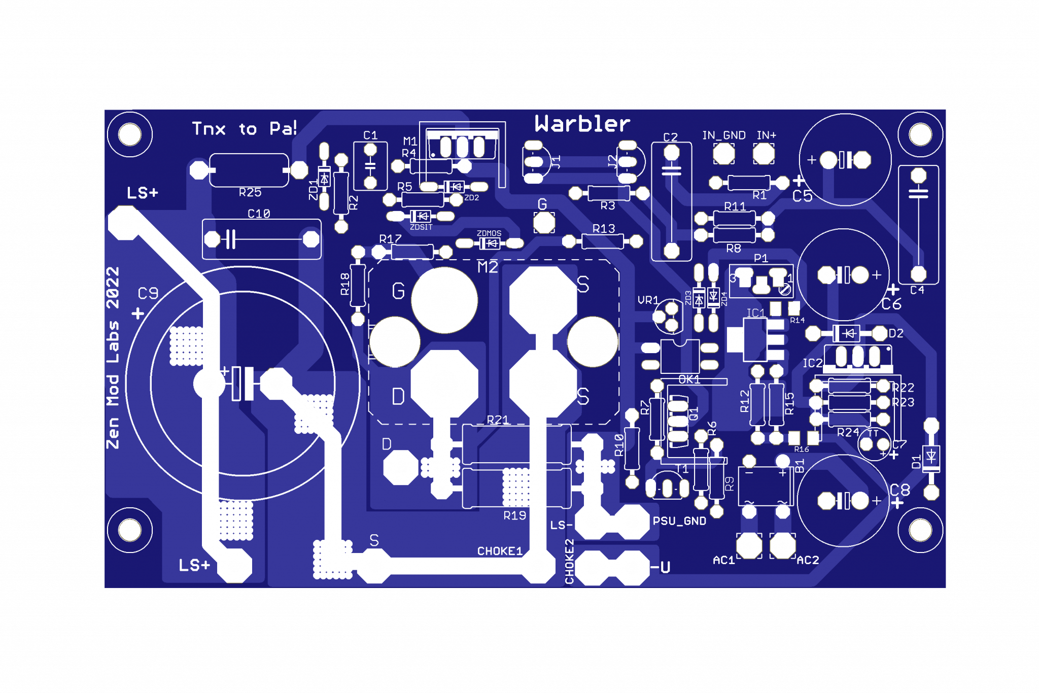

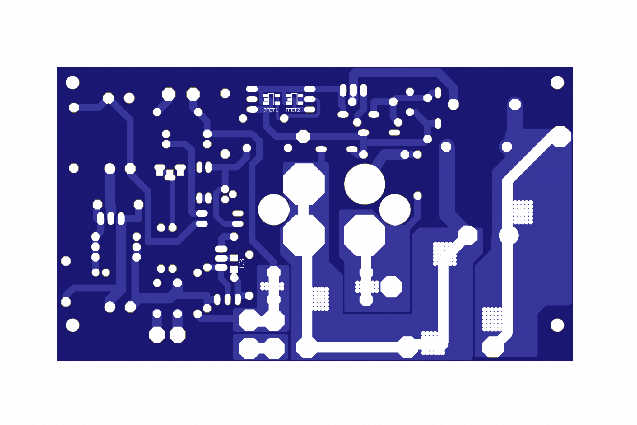

A PCB suggestion if I may
The screw pads are going to be very prone to lifting if you take into consideration the increased temperature and the strain of the screws. Even with washers. Some reinforcement with vias would increase their strength
tnx, easy to do and I probably will ..... and small vias can be filled with solder prior to mounting
though, it didn't show as critical, yet ....... and I saw plenty of same arranged pads in really critical equipment
remember that screw holes are big vias itself
:rofl:
which means that Choked Singing Bush (yeah, SB with choke in place of Mu follower, thus needing full biasing mech. at SIT side) is going to benefit from same change
