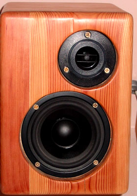

I cant decide what finish, got a shed full of baltic pine as it looks cool on me DIY computer speakers... Trouble is after about a year the baltic can split(doesnt affect the speaker, as box is MDF)see picture

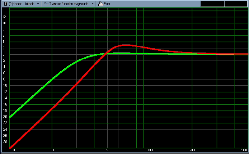

I moddled it in WINISD in a 9999999999litre box tuned to 0.1Hz.. which if ya ask me is basically free air.. 🙂 lol
The result is this....
The green line is free air, the red is in a 50litre box, which is what it used to be in... 🙂
notice how it takes a billion litres to make any difference,i noticed this with my jbl,to get response better,adding 100litres made only 1db difference,135litres and 175 is basicaly the same.
try estimating the volume of the box eg: underfloor height 50cm,x 20x30m etc...
i would try that,because it may not be a billion or whatever 9999999999 litres :-D
IBs have low power handling so expect the xmax to be used up if u want it loud.

Out of intererst - can you describe an IB with a Q?(eg. as you can do with a sealed / ported enclosure). The Qseems to approach 0.4 when I calculate it.
Dave Bullet,
You are a dumb-*** - the Q of an IB is effectively the Q of the driver. The driver you were using in your calculation had a Q of about 0.4 - am I right?
