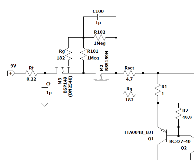

Hi Grunfs, I was looking at the model of your ccs input with Biase multipler, I wanted to ask since I couldn't figure it out, but to implement it in negative feed, just flip the ccs and place it on the negative part? I hope you can clear this doubtI installed a new input CCS (BSP149, BSS159) yesterday,![]()
Hi, I'm at the last design stage and I would like to try this css too, could you explain how to add it to my circuit? I see three terminals, and honestly I'm a bit confused
Just use + CCS and - CCS
forget the terminal labeled “ out”
I use a 500 ohm trimpot for currents up to 8 or 10 ma
I am using it in several power amps Krell, Ashly, Hafler. All with good results
You need at least 15 / 18 volts across this type of current source to work well. Not so good for preamps. Be careful not to overheat the jfets - use a series resistor to keep the voltage across the current source to 25 - 18 volts

I get it, as I thought, so to use it in a negative Power supply, I assume you just have to reverse the sense of input right?
I think that using this type of CCS for the power supply of the DAC chip is a waste of energy, at this point it would be better to use the smooth Shunt with only one DN2540, what do you think? the power supplies need 16mA, is it worth using this type of power supply?
