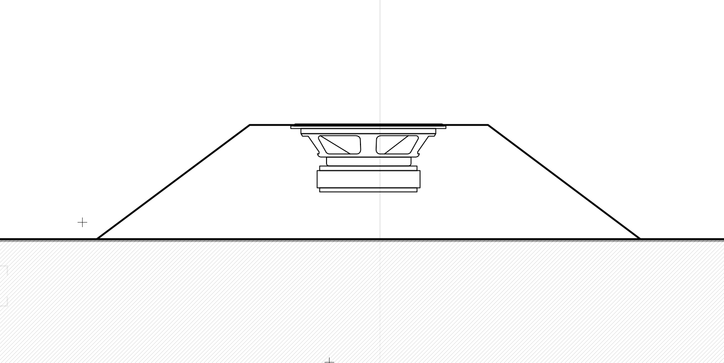

Need to make (or buy, unlikely) speakers on front wall. Concerns are oddball effects, isolation from wall material, getting drivers aligned with sweet spot when driver height will be minimum of 150 cm / 5 feet (angle down and in a fraction? Thoughts so far:
1. Will run with sub
2. Make thin
3. Surround by acoustic foam or something else up to level of baffle
4. Designs considered (without much research) include spiral horn (Cornu) and https://www.diyaudio.com/community/threads/tangband-3-inch-honeycomb-cone-w3-1797s-hbw-08.409698/
5. Driver size: Was ready to build Pluvia 7 HD floor standers, but I mocked up a couple of designs, which I always knock over - not enough floor space. Have no issue with driver size, but 3" I made already could do with more ooommph in the room. Those are HiVi B3N, so perhaps some other 3" might do, but I could go up to 5" or 6" without any concern. [If the layout on the other side of the wall were different, I'd be looking at putting drivers in the wall].
6. If wall mount is too much compromise, I can go with fairly compact bookshelf (I'm tight on space, with SO's home theatre unit taking up space). GR-Research suggested https://gr-research.com/product/lgk-2-0-pair/ but reviews mixed.
7. I could mount speakers on shelf or extending wall mounts.
8. I could use floor stand speakers upside down, spaced about 1 ft / 30 cm from wall
Thanks for any suggestions, considerations, sympathy. I'm disappointed that a floor stand set really won't work given narrow, fairly crowded available floor space and the conflict between home theatre use by SO and my desire for crisp, clear, delicate audio without video.

Yeah! That's pretty cool. I might be able to mount the drivers slightly pointed in. Clever, simple. Thanks!Maybe look through this wall mount design for additional inspiration.
With wall mount you need to have a well damped box alignment, and try to merge the box into the wall to flatten the 2∏ to 4∏ transition.
A sealed enclosure might be the best bet.

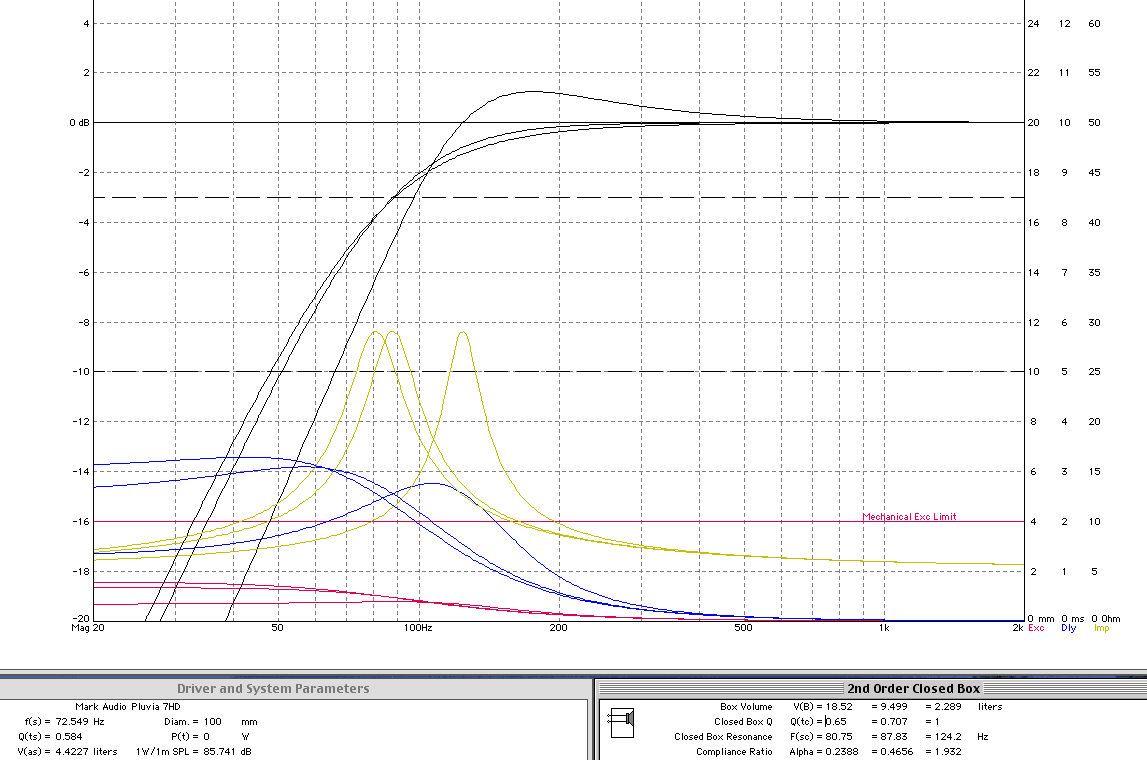

Thank you. I'm not sure what " well damped box alignment" means, but sealed and the transition to the wall make sense. Would this need to be sloped into up and down as well as left and right? I could laminate a moderately interesting shape. Wonder what the "ideal" would be!
Well damped means it starts rolling off sooner but at a slower rate. I’d target a 0.5 Q sealed box. About 9 litres for the P7HD.
The more elaborate box would be better, but adds a significant degree of difficulty.
dave
Pointing them at yourself doesn't always lead to the optimum balance. I thought this might be good to know since tilting them from being normal to the wall will present a challenge with the cabinet shape (which is fine if there's a reason for it).angle down and in a fraction?
