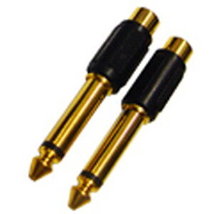

Thanks for the recommendation. So I guess I would just get an RCA to TRS adapter to go from my phono preamp to this?
I actually made my own cables with RCA on one end, and TRS on the other.
Used a good quality cable we had around here (but nothing involving "snake-oil prices"!)
But yes, an adapter like these would do fine.

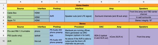

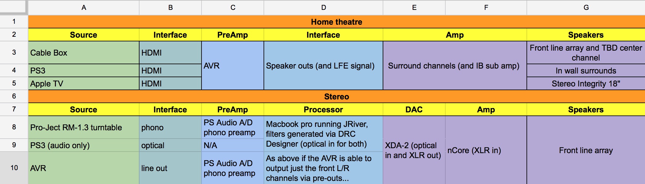

Here's my diagram for how I think things can connect:
If I get a USB/SPDIF converter, I can compare (to some degree) how the Open DRC unit compares with a PC based JRiver/DRC designer solution.

Suit yourself, but it's actually a lot simpler than coming up with diagrams like you just posted.
How hard is it to route audio in to something, and audio out to something else?
I'll be direct. If you keep trying to come up with half-baked solutions, you'll have a less than stellar outcome.

Is Open DRC a half baked solution though? I haven't heard anyone's experience saying so and if anything, I've seen lots of good reviews.
And if it's real easier than posting a diagram, then I'm golden. Again, not super happy about a $300 piece of software, but that's still less than an Open DRC unit!
Like I said, I'll keep looking, but I also think there are other ways to skin this cat that are also valid.
