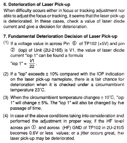

The last digits of the pickup serial number give the factory set current for the laser diode which should be easy to check by calculation after measuring the volt drop across a resistor in the laser drive circuit. 484 is it on yours ? That would be 48.4 milliamps if so.
Just performed this measurement on my "spare" KSS-151a laserunit in the Denon DCD-2560 EX which a bought as a donormachine with the help of the servicemanual on my new fine set of pins and grips for the MM.
I measured when running a disc 0.997 Volts voltagedrop.
According to the servicemanual I had to divide this value through 22 (as with the Wadia WT-2000 (Teac/Tascam P2S/CD-701) and the resulting value is 0.04531 A = 45.31 mA of iop.
Value on the KSS151a laser is 454, bingo only 1% lower than specified.

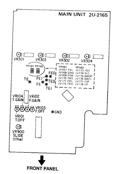

I also performed another measurement (4) (jitter related) that was in the servicemanual although the the indications what to do was not very clear see pictures from the servicemanual of the DCD-2560
http://www.diyaudio.com/forums/attachment.php?attachmentid=655511&stc=1&d=1515425851
http://www.diyaudio.com/forums/attachment.php?attachmentid=655512&stc=1&d=1515425851
So at instruction 7 (4), pin 1 HF must be JVF178(HF) numbering starts from under to the top (Japanese) and GND?? just the ground pin or ground anywhere?
This sentence makes no sense:
".., if the HF level across pin (1) and across (HF) GND of TP102 in 2U-2165 becomes 0.6V or less..."
Maybe my English is not good enough but this instruction is pretty ambivalent to me.
I measured between pin (1) HF JVF178 and the ground pin (somewhat lower to the front of the player indicated with XGND 0.554V so that's not good and could indicate a deteriorated laser after all.

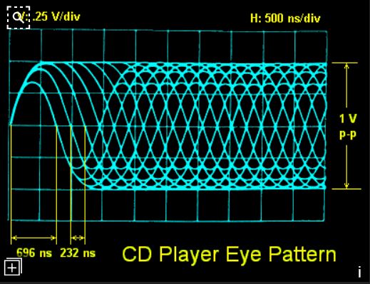

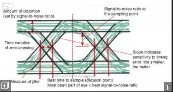

Without having a player in front of me to quickly check what is actually on those test points I would have said that HF = RF = Eye Pattern. Ask a technician 'have you checked the HF' and the assumption would always be that you meant the RF signal.
Checking the 'HF' would be done with an oscilloscope.
Your laser diode checks OK, but that is just the diode itself. You could prise the diode out of the pickup and the result would be the same, the current would be identical. That is because the optical laser power is measured by an internal photodiode embedded onto the same die as the laser diode.
If the HF is low and the laser power is good then that can mean a problem with the optics. A fogged lens will lower the 'HF' even though the actual laser diode is functioning correctly. Its like shining a torch with a dirty lens. The bulb is fine but the final light output might be low.
Jitter is something that an experienced tech can discern in the 'HF' when viewed on a scope. The signal should be clear and steady. If its noisy/jumpy and generally unsteady then we might say it had 'jitter'.
These images are from the web. The first is impeccably good, the second shows how jitter would look. Imagine all the 'diamond shapes' in the first image looking noisy like in the second.

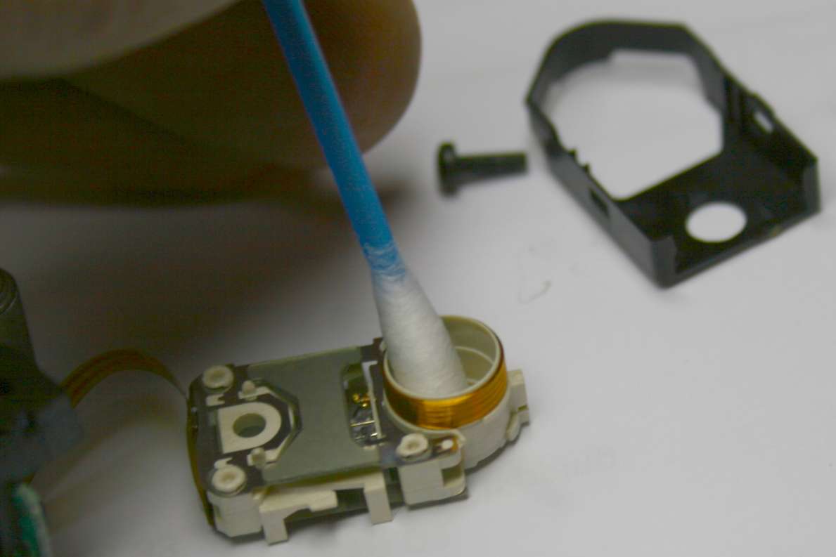

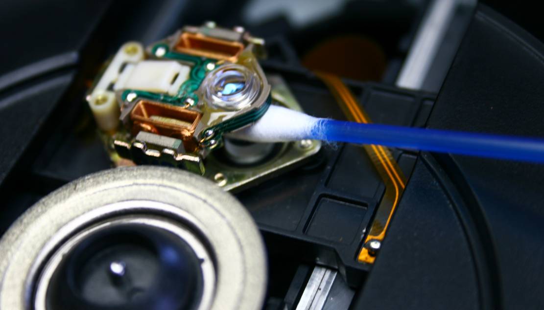

Nice link and work in the link. I'm always scared to clean the lens but there you've proven it's useful to do it. Ok where is my Tek and my Tascam...
How about deepcleaning the lens like on the pages of the Lampizator:Nice link and work in the link. I'm always scared to clean the lens but there you've proven it's useful to do it. Ok where is my Tek and my Tascam...
http://www.diyaudio.com/forums/attachment.php?attachmentid=655584&stc=1&d=1515448551
Thanks.
A good clean of the top surface of the lens can dramatically improve the level of the RF. That's something I've seen countless times when working on players.
Robert... your link doesn't work for me 🙂
Deep cleaning the KSS151a lens - Lampizator style
http://www.diyaudio.com/forums/attachment.php?attachmentid=655701&stc=1&d=1515500506
Better?
Credits: Lukasz Fikus, Lampizator archive website
Better?
Better 🙂
