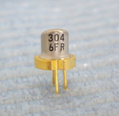

I've seen laserdiodes (304 6FR) for sale on Ebay for just a couple of USD/EUR.
Is that a alternative compared to the whole replacement of the Laserunit when the laserdiode itself is only gone?
http://www.diyaudio.com/forums/attachment.php?attachmentid=654588&stc=1&d=1515069200
As a generalisation... although the laser diode is simply glued into the pickup (and easily removable given a quick twist with pliers), the optics of the pickup are aligned around it. The lens carrier plate has tiny screws to set the axis so that the beam intercepts the lens correctly. Some optical pickups also use a 'diffraction grating' internally to generate separate 'side beams' used for tracking. I'm not sure how the laser diode position interacts with that and whether its a concern during assembly.
I would never say never... and it would be interesting to try... but you need a donor pickup to sacrifice and suitable test gear.
Okay, clear no diy job!As a generalisation... although the laser diode is simply glued into the pickup (and easily removable given a quick twist with pliers), the optics of the pickup are aligned around it. The lens carrier plate has tiny screws to set the axis so that the beam intercepts the lens correctly. Some optical pickups also use a 'diffraction grating' internally to generate separate 'side beams' used for tracking. I'm not sure how the laser diode position interacts with that and whether its a concern during assembly.
It depends how keen the diy'er is 😀 As I say, 'never say never'.
You would only know by trying but you would need at the minimum as oscilloscope to look at the signal (should you be lucky enough to get it to spin up at all), and from there to try and optimise the levels.
