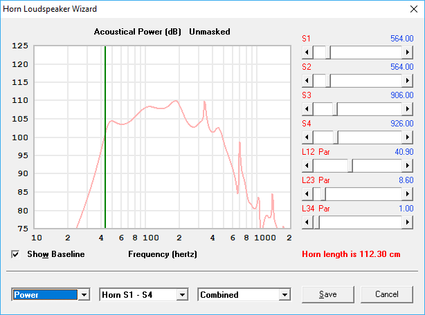

But ES18bph etc are basicly 4th order bandpass enclosures with big flared port or horn. Thats why we call them band pass horns. The short horn part is there mainly for better coupling with surrounding air and thus they are very efficient enclosures. Negative thing is, they only work well in very narrow band like 60-180Hz, where as typical well designed front loaded 1/4w horn can cover 60-400Hz. But they are also much bigger.
Yup, they're basically a 4th order BP alignment with the front volume and vent replaced by a short expanding "horn", which is basically an expanding vent.
Now, say we were to convert it to a 6th order series or parallel-tuned BP type of alignment. We get the advantages of wider bandwidth and/or better power handling at low frequencies, at the possible cost of a larger box. The front-vented W-bin is basically such an alignment (6th order BP with front section replaced by a short horn).
Theoretically it should be possible to do a series turned version of the W-bin to get the advantage of increased bandwidth, but I really haven't looked into it. Hmm... maybe I should modify my W-BIN BOXPLAN workbook to include that option to see what's possible...

While that W-Bin might be tuned to 35 Hz, the accompanying FR graph suggests that it's over 10dB down at 50 Hz. That's more of a kickbin than a pro audio subwoofer. Looks like a very old design, done in the days when amps were small and SPL from 60 Hz up was more valuable.
What do you suggest I build instead, to add to this system if I leave the w bin as a kick bin?
As you are using a different driver than what was spec'd for that particular W-bin, you might end up with a completely different response. The good news is that the Fb is at 35 Hz, so it's possible that your build will go down a bit lower than the original, but not be as efficient. Best to just test it to see what it's capable of, before making any further plans.
