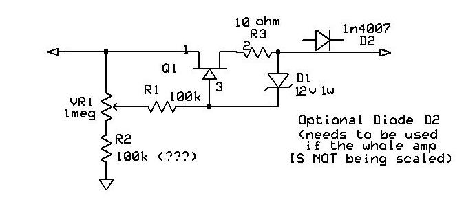

So I fixed my amp, now I have a new problem regarding VVR. I'm using the schematic attached I found online. It looks simple enough. Only difference I made was to use an IRF840 mosfet. I turned the amp on with a variac to start with and with a HT of 160v I was only getting a max output of 46v. Any higher than a HT of 200v it sounds as if something is sparking. I used and IRF840 in the effect loop so I would assume it's suitable. Anyone have any idea on what's going wrong?

What's the B+ voltage in your amp?...an IRF840 mosfet.
The IRF840 is good for 500 V maximum, and several amps of current (but not both at the same time.) With semiconductors it's wise to leave a significant safety margin, so if your B+ is well over 400 volts DC, you may be cutting your margins a little thin. (But that is probably not the cause of your current problems.)
Questions:with a HT of 160v I was only getting a max output of 46v. Any higher than a HT of 200v it sounds as if something is sparking.
1) What size is the pot you're using? Miniature pots are not rated to have several hundred volts across them. That could be the cause of the sparking you're hearing - it might be inside the pot.
2) How is the IRF840 mounted? I presume you're aware that the metal mounting tab is "live" at B+ voltage. It can be mounted on a metal heatsink directly, but only if that heatsink is electrically isolated from the chassis. (The heatsink will be "live", and dangerous.)
Better to mount the MOSFET to heatsink or chassis with an electrically insulating (but thermally conducting) insulator pad.
In any event, I hope you took precautions to keep fingers away from that MOSFET mounting tab. If not, please do! Build a plastic box with ventilation holes around it, put on a "Danger! High Voltage" label, make it impossible to touch by accident.
3) Have you double and triple-checked your MOSFET connections? The gate is not the middle pin, and source and drain are not interchangeable.
If those questions don't lead you to the source of the problem, a couple of clear photographs might help. If that still doesn't solve the mystery, it's back to the DMM for more voltage readings. Let's take one step at a time, though.
-Gnobuddy

I disconnected the mosfet drain as seen and the pot works fine. So it's the mosfet that is the issue. I have an IRFBE30PBF 800v 4.1a rating might try it instead.

1) Measuring with your DMM at the pot wiper, does that get all the way to full B+ when you turn the pot to maximum? It should, otherwise the pot is defective or mis-wired.
2) When the pot is turned to its max setting, what voltage do you have across the zener diode (DMM set to DC volts, red DMM lead on MOSFET gate, black DMM lead on zener diode where it meets the 10 ohm resistor?)
You should read several volts here, maybe up to 10 V. If you read well under one volt instead, the zener diode may be wired backwards. If this is the case, the zener will stop the MOSFET from ever turning on, and that will cause low B+ out of the VVR.

Ok so I got it working (blown zener) but it's still being weird. The amp works perfectly fine when the vvr is set to minimum to 150v, but then it starts oscillating and humming again, up until 270v where turning it up more causes it to jump down1 to 245v it then works as normal. Is it just the pot?

My guess is it's the same problem that's been plaguing you for this entire thread: unwanted oscillations due to problematic layout and wiring.It's just at 150-245v.
The voltage gain of a vacuum tube changes with the applied B+ voltage. As you twiddle B+ with your VVR, each gain stage in your circuit experiences variations in gain, output impedance, and frequency response.
That being the case, it's my guess that it just so happens that the whole circuit bursts into oscillation for some range of B+ that you're dialing in.
There's a simple way to test my hypothesis: disconnect the VVR output from your amp. Put a dummy load (resistor) on the VVR output instead, something that draws roughly the same current as your amp would. See if the VVR behaves properly with the dummy load.
If the VVR is fine with the dummy load, and the problems come back when you connect the amplifier instead of the dummy load, then you know the problem is the amp, and not the VVR.
