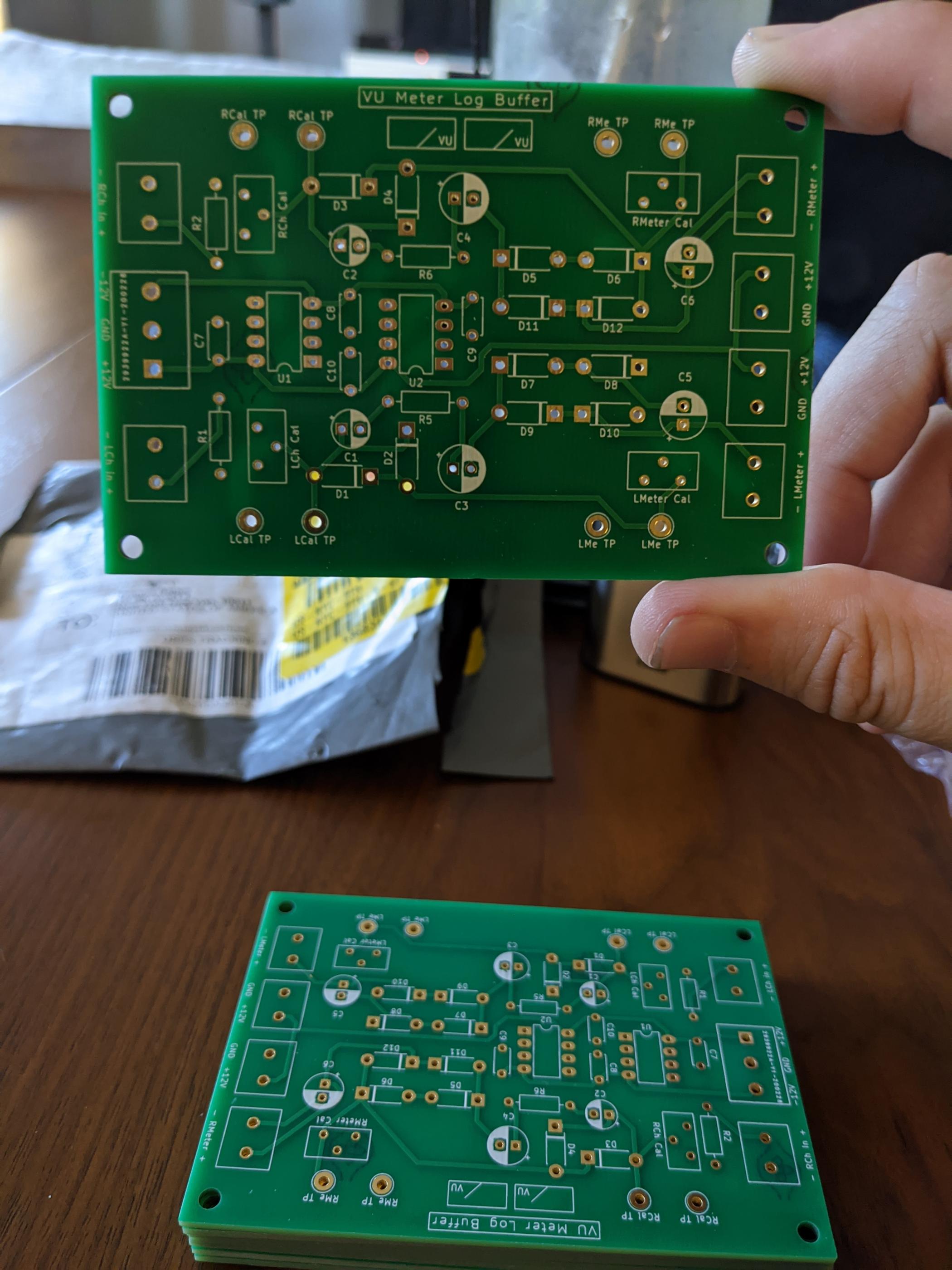

Huge apologies, everyone, for the LONG delay here. I've attached the gerbers as well as a PDF copy of the KiCad schematic of the final design.

I should add: if anyone is interested in this exact circuit, I have extra boards I'd be willing to part with for the cost of postage within the US (no promises that I will mail them expediently). Just send me a PM if you're interested.

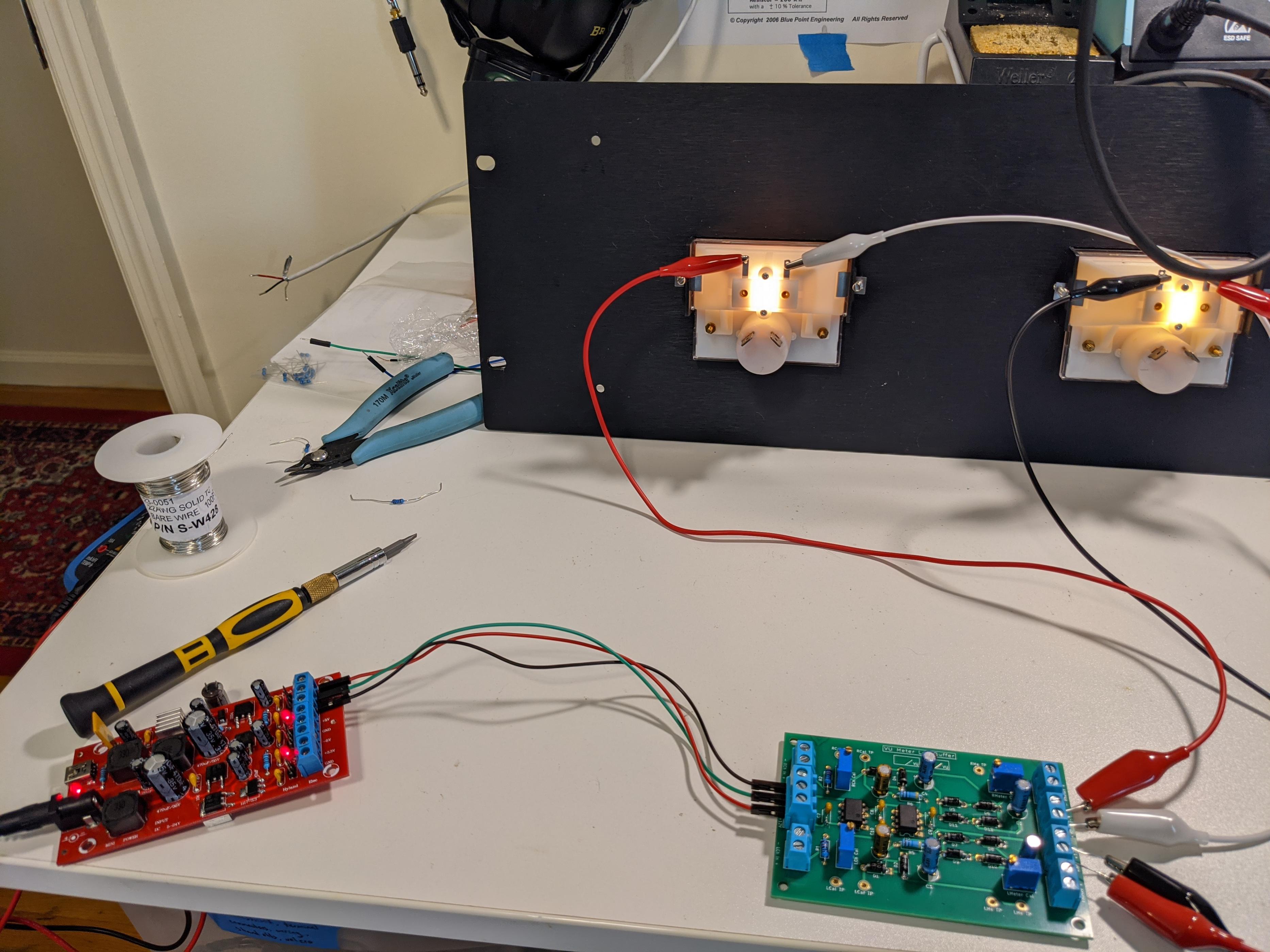

Attached: pic of the boards + pic of me testing the boards plus the +/- 12VDC supply board I used.
I ended up mounting the board on the back of the front panel between the two meters.
I bought this regulator from banggood, which I powered from a 12VDC wall wart.
Because the lamps require so much current on the positive rail (creating a lot of heat on the regulator board) I am powering those directly from the 12VDC wall wart and the board is only providing power to the buffer circuit board.
