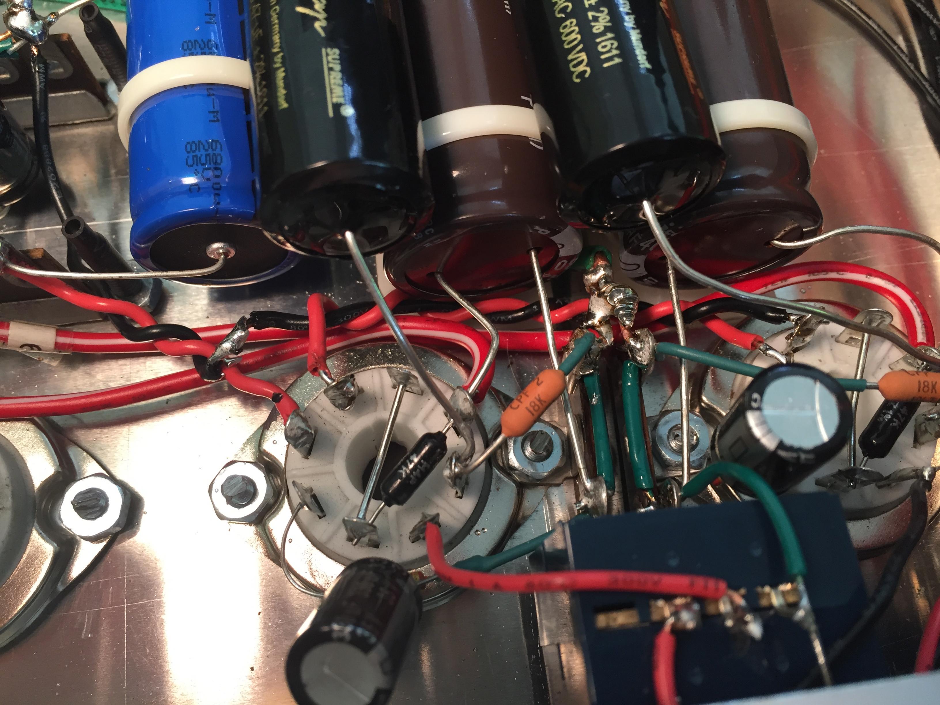

Just a thought:
If you are intending to use 6SN7 tubes, the heaters of both tubes need to be in series with each other. It looks from the last pic as if you have them in parallel, which is only good if you are using 12SN7 tubes. The red-to-black DC measurement will be up to 20v with no load, and 12-13v with the tubes in place. A 6SN7 powered like that won't last long.
Please check the wiring before plugging the tubes in under power.
Note the diagram showing different heater supply connections for the 6SN7 and 12SN7 tubes.
The random ac component you are measuring is because there is no tube plugged in. The diodes you used are OK for this job.
I rearranged the heater wires such that the red goes from 6800uf cap positive lead to pin 7 of tube 1, red from pin 8 tube 1 to pin 7 of tube 2, black from pin 8 tube 2 to the negative lead of the 6800uf cap (attached pic). I believe the 6SN7 sockets are now wired in series per the schematic and would appreciate confirmation before I plug in and test the heater voltage on the tubes, since they weren't cheap.
Btw, the exposed joint where the black wires were soldered together in the pic is now covered with heat shrink.

I went ahead and powered it up with tubes in, first the 6SN7s alone and then with the 5Y3GT.
Heaters -- Tube 1: 6.4V | Tube 2: 6.1V

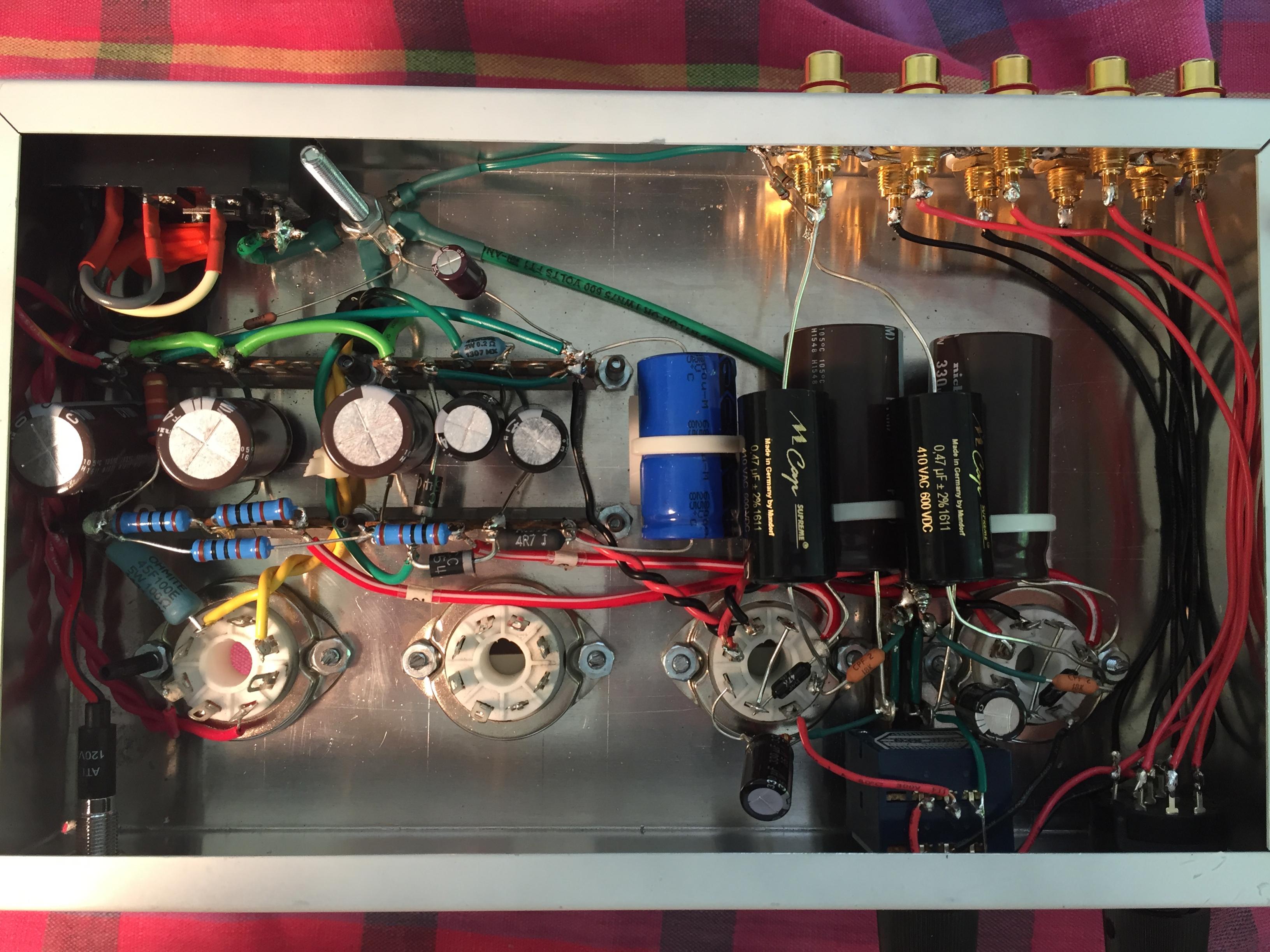

I had trouble getting a good ohm reading of the right-channel signal wires at the volume pot -- but I could get one. So I resoldered them anyway.
When inspecting the right channel 6SN7, I tugged the 47K resistor to plate 1 (pin 5) and found that it was actually not attached, moving almost imperceptibly despite the beautiful looking solder weld. That would account for why I was getting readings of 18V and 133V at the same position, as well as a 20V B+ difference in each channel: I must have been pressing it with the multimeter probe hard enough that it made the connection some of the time.
So I resoldered that connection, and now everything is balanced. B+ is 340V in both channels (not 330V as held in VTV Octal lore) and cathode 2 at 130V each channel.
The only real voltage disparity is that the right channel heater measures 5.9V while the left one measures 6.3V, which is odd because the left channel is the latter one in the series, so I'd expect the lower voltage to be there after the resistance in the right channel. The filaments of both tubes light up just fine.
Anyway, PS caps are decharging, and then I'll go listen again.

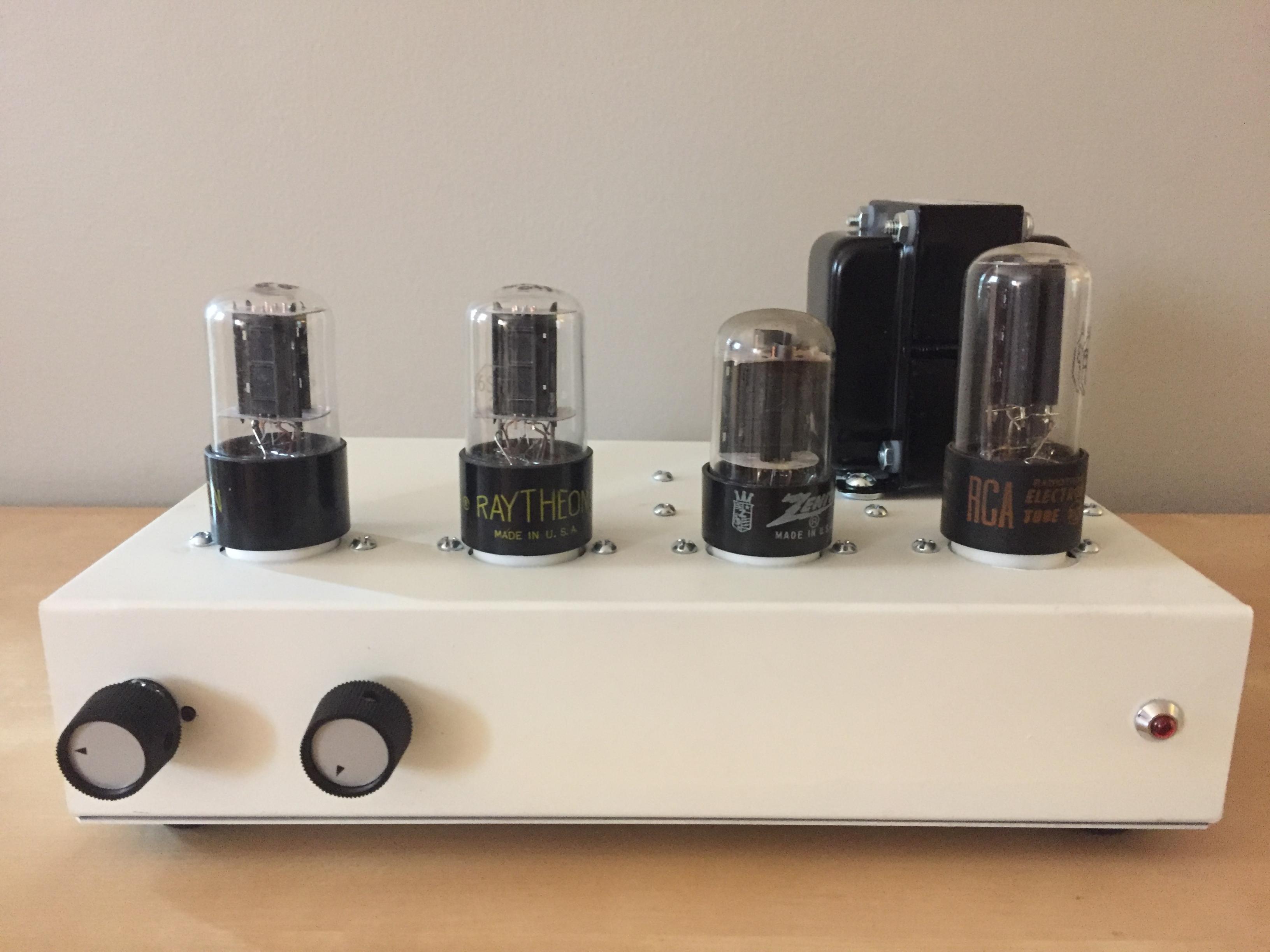

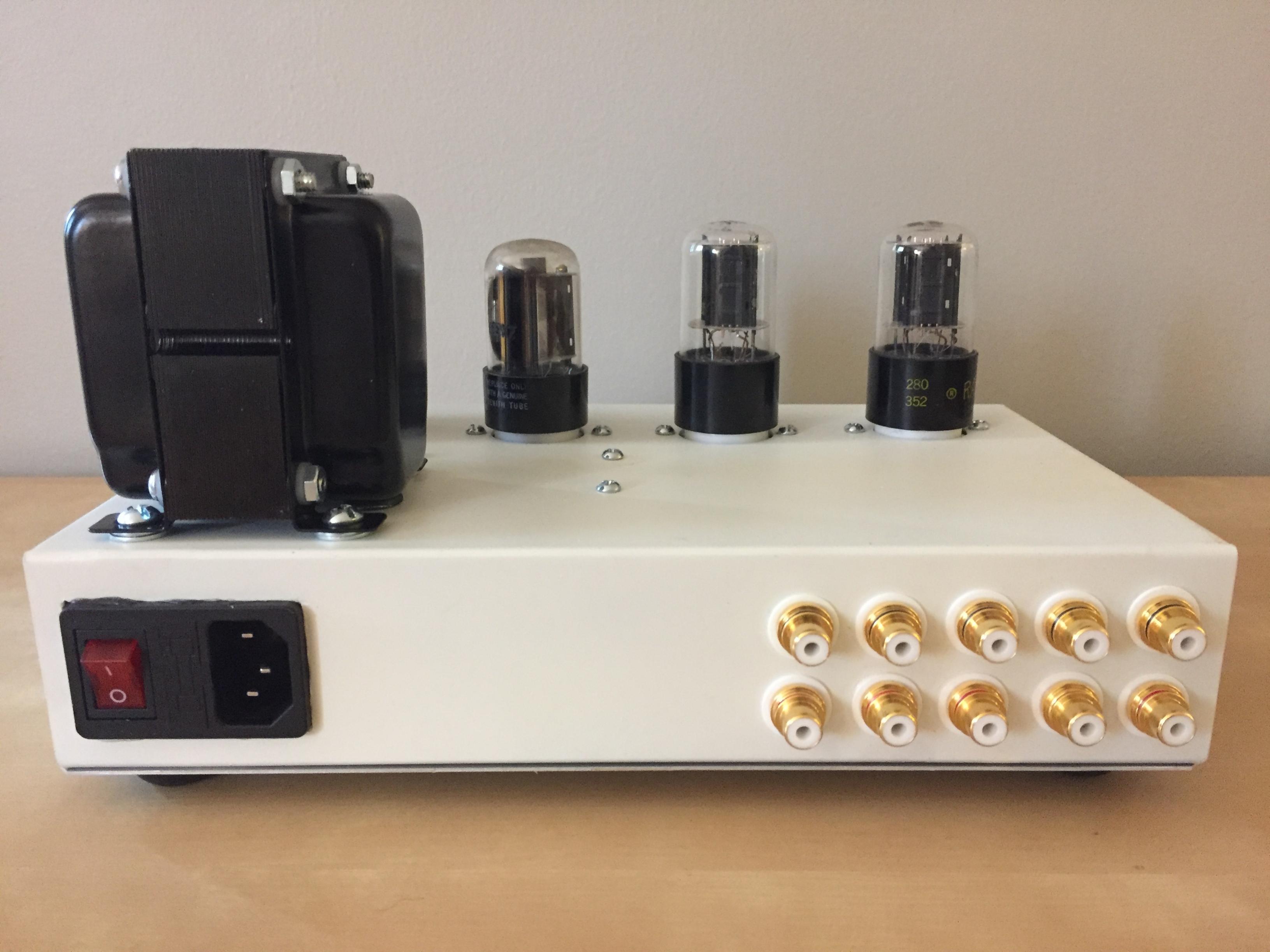

Well I can report that the stock VTV Octal Linestage works very well in my system. The noise floor is very quiet at idle. It collects a turntable, CD player, and phone/tablet/laptop/whatever and inputs to a Tubelab SE 300B.
The Achilles heel of this system has been CD volume, and it now drives them to gloriously loud SPLs. The TSE seems to be receiving more information too, particularly from CDs, as I hear a little more detail and the soundstage is better defined. The instruments but especially vocals have a more discrete spatial presence, in a good way. The wholeness and unity of the soundstage is improved a little too, since I could still hear everything in the same place when I was leaning over the middle of the system to adjust something and my head was behind the speakers.
My system still doesn't do the 3D thing like the George Wright stuff I've heard, so after this preamp is finalized I'll make a pair of 300B mono blocks with no ICs.
I will let it burn in before making adjustments, as I'm not sure yet what can be improved. But I will post here when I determine what that will be.
Bottom line is that I LIKE what I'm hearing and the TSE is happier with a preamp in front of it.
Thanks to all who have chimed in.
Pics attached for those interested.
