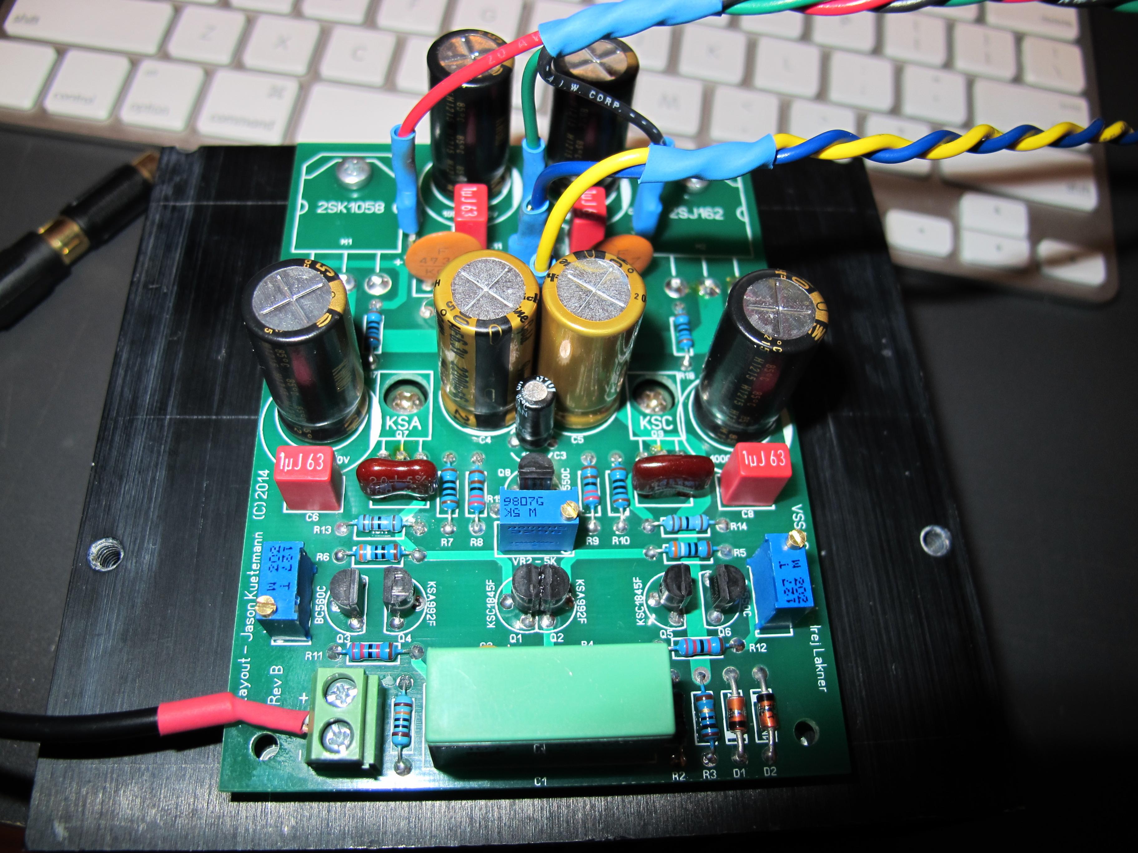

I will provide some documentation shortly. I will try to provide a detailed build document in PDF that everyone can use hopefully before anyones packages arrive. I need to clean up the schematic diagram and ensure the designators match between the PCB silk screen and the schematic. The silk has the values on it, so in theory if no troubleshooting is required one should be able to build it just by following the board. I will also put together a BOM as well.
It is the basic VSSA using 2Q CCSs and a non-thermally coupled VBE multiplier for bias in place of a diode string.
OK, just went through calibration and hooked up one board. Sounds just like it should, I'm pleased. I'm also very happy with deciding to use the VBE multiplier, I'm no longer at the mercy of component tolerances in determining how much bias I have.
I didn't have any 500Ω trimmers so I used a 2kΩ just for testing. This made setting up the VAS bias and output offset a little touchy but not unmanageable. The calibration process will be easier with the specified 500Ω trimmer. Setting quiescent current is easy and the adjustment is nice and progressive, just insert an ammeter and turn it up until you are happy.
I'm feel confident there are no errors since I simply built it as outlined on the silk screen. Anyone should be able to put this together without any real issues. Now to put another together so I can compare with the TO-3 PeeCeeBee.

Further update, I have received a couple more addresses. I will have these quoted when sending off still4given's package and get back to you folks as soon as I'm able. Attached is a picture of the completed unit.
