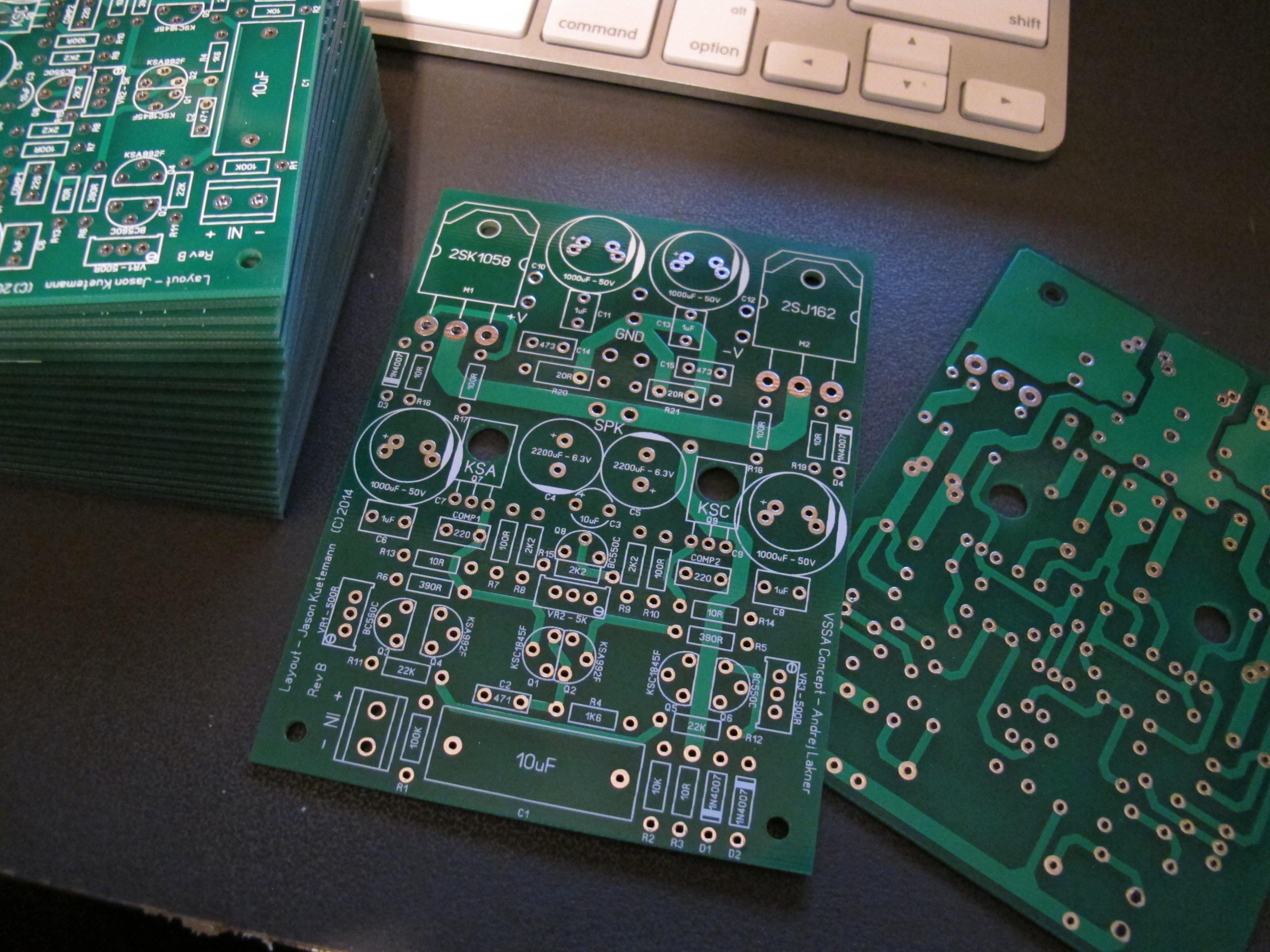

VSSA Through-Hole Version by Jason
And a quick pic of the product.
I used Sitopway for the job, as recommended several times and places by forum member nigelwright7557. Service was fast, same day quote and order processing with delivery in 11 days! The board house option is sweet, absolutely professional looking job.

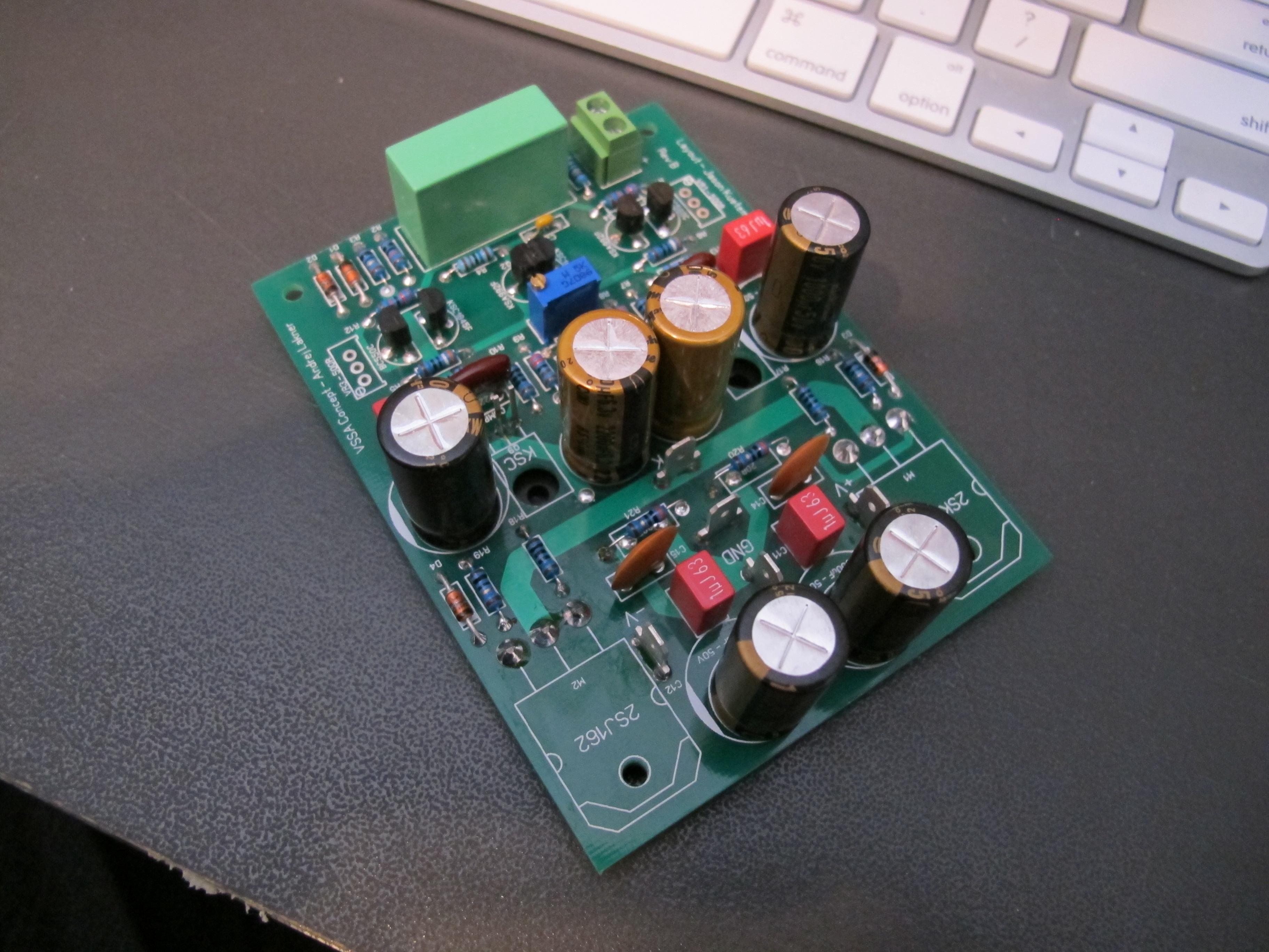

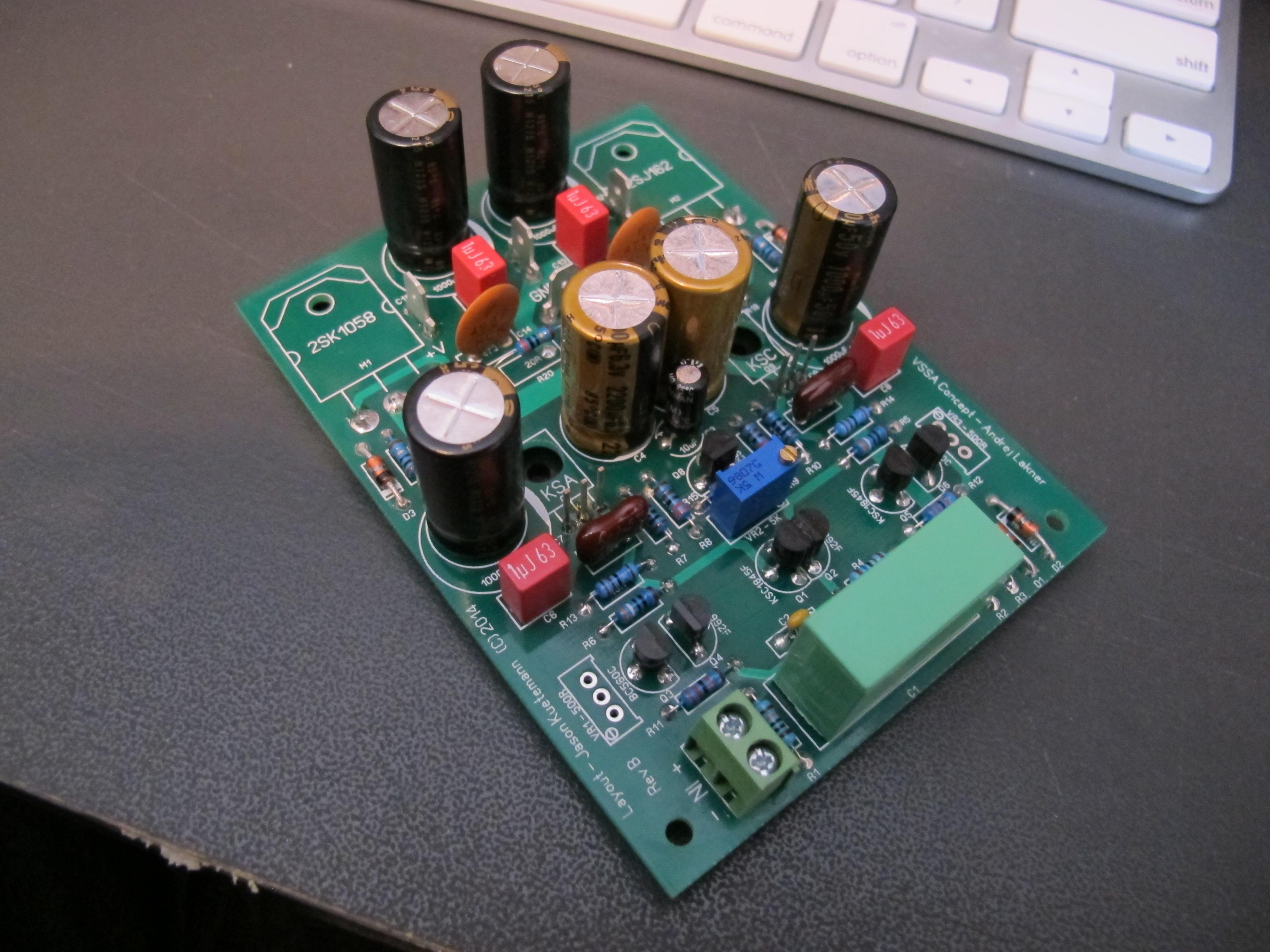

Just missing some trimmers that the local junk-monger didn't have 🙁, hopefully I'l be able to finish QC so we can arrange distribution of the surplus. I did make a few compromises on this one to get it stuffed (I ordered more of the Nicicon FG for the 1000uF locations, I only had KW on hand).
And yes, I caught the reversed capacitor and corrected it. Just a tip for anyone getting these boards - they are plated holes which makes rework more difficult, assemble carefully the first time.
