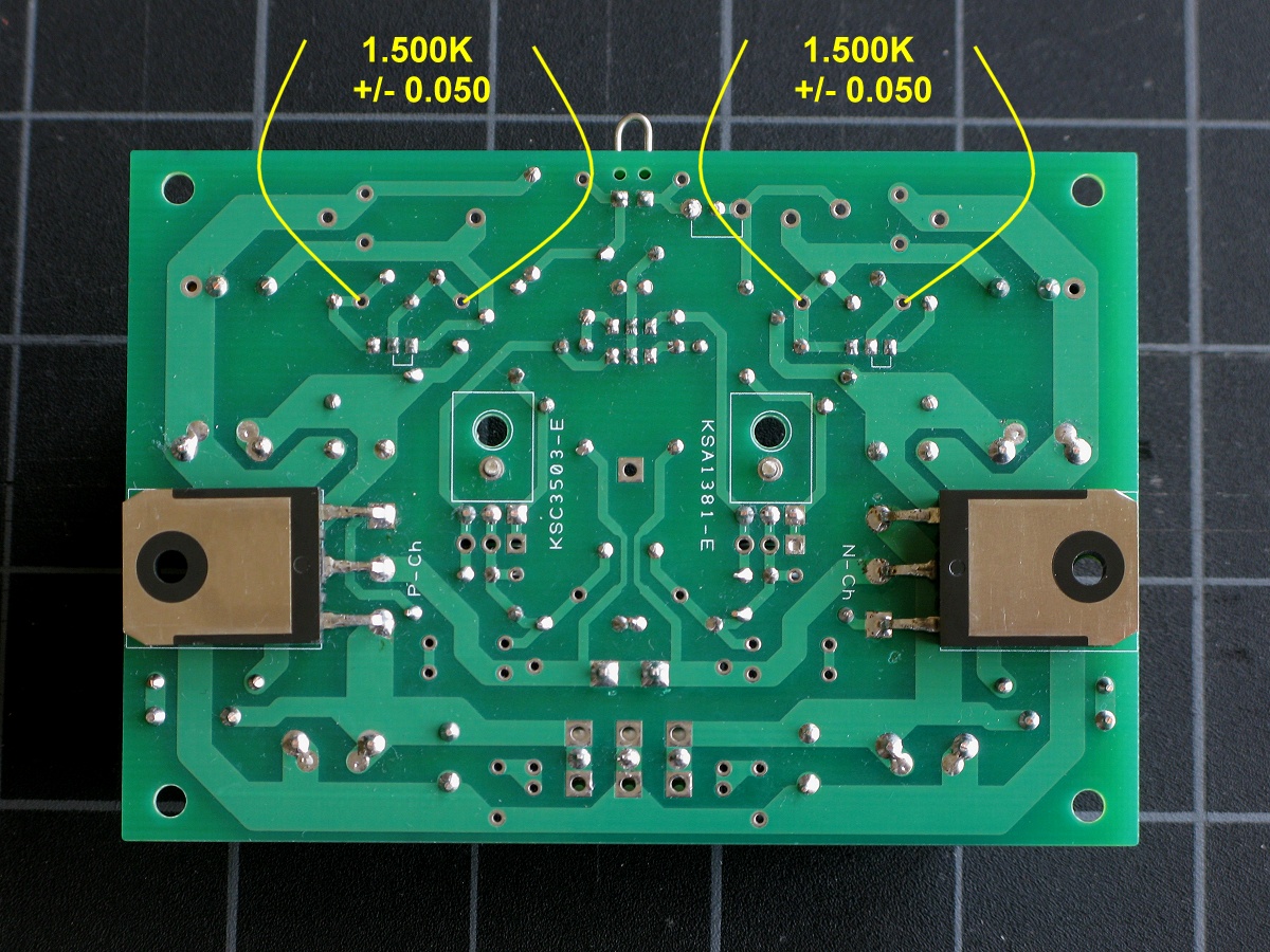

I set the pots mid-way to start, they usually come that way from the factory, anyway.
A better way, is if you adjust the pots after assembly, and before first power-up, so that the resistance across the pot reads approximately 1.5 K Ohms, close to the calibration setting. It may seem like a pain at first, but it makes calibration easier.
You can use the two empty holes adjacent to the pot as test points.

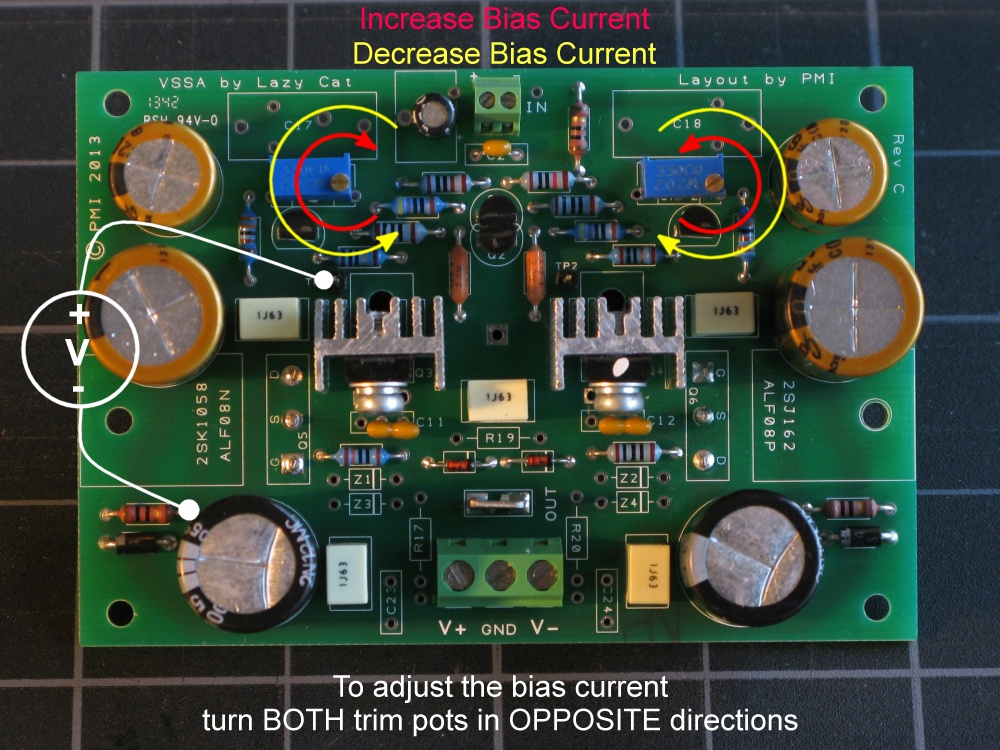

I would adjust to 12~15 mA VAS bias current and 0V +/-5 mV offset, at least in the beginning. After that, you can change it if you think it is too low or too high in your case. I will just paste my preliminary calibration procedure into a post below.
Offset and Bias Adjustment
Overview:

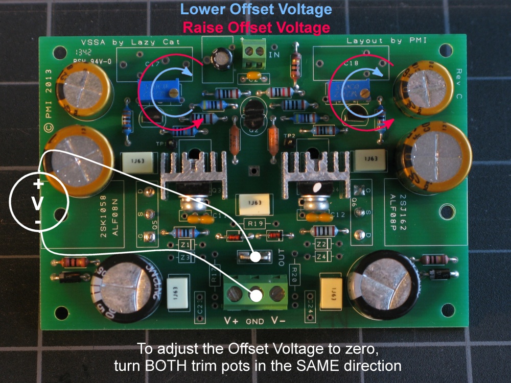

The two trim pots are complementary. For best results, they should always BOTH be adjusted the SAME number of turns or same fraction of a turn. (you do not have to follow this suggestion to get a result, but it may take several iterations otherwise).
The trim pots can be pre-set to 1.5K Ohms, measured across the outside trim pot terminals on the bottom of the board (or from R5 to R7 on top) before applying power. Otherwise, leave them at mid-travel.
The output DC offset voltage can be measured directly. The bias current will be measured indirectly, as a voltage across a 10-ohm resistor (R9, R10), using TP1 or TP2.
To make the subsequent bias adjustment easier, set the output offset voltage to approximately zero first, then set the bias current to the desired level, and make any fine adjustments to the offset at the end of the procedure.
If needed, the input bias current can be checked by measuring the voltage across R5 and R6, and dividing by the resistor value. It should be about 1.9 mA.

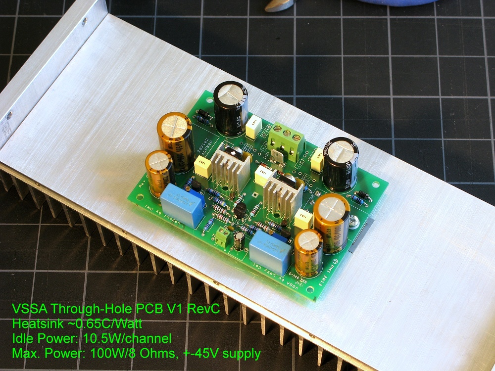

Before applying power, the board should be installed on a heatsink. It will dissipate about 10W during calibration.
20~22 Ohm 5~10W resistors should be installed in series with the positive and negative power supply wires. You can also use the popular "Bulb Tester" method, incandescent lamps (bulbs) in series with the supply rails.

  • To adjust Offset Voltage, connect a voltmeter from the power supply ground terminal to the output terminal. The meter measures the DC offset voltage directly at the output. Adjust BOTH trim pots clockwise to lower, and counter-clockwise to raise the offset voltage, until the meter reads 0 +/-5 mV.
  • To adjust Bias Current, connect a voltmeter from the inside lead of R11 to TP1. The meter measures voltage across a 10 ohm resistor. Adjust BOTH trim pots in opposite directions, until the meter reads 140 mV (0.140V). This will correspond to 14 mA VAS bias current. At this point, input bias should be about 1.9 mA. Assuming a supply voltage of about 35V, total idle current should be about 150 mA.
  • Quiescent power will be about 10.5 watts per channel - this is why the board must be attached to a heatsink any time power is applied (!)
  • Offset and Bias should both be checked, and fine adjustments made, when the heatsink temperature has stabilized.

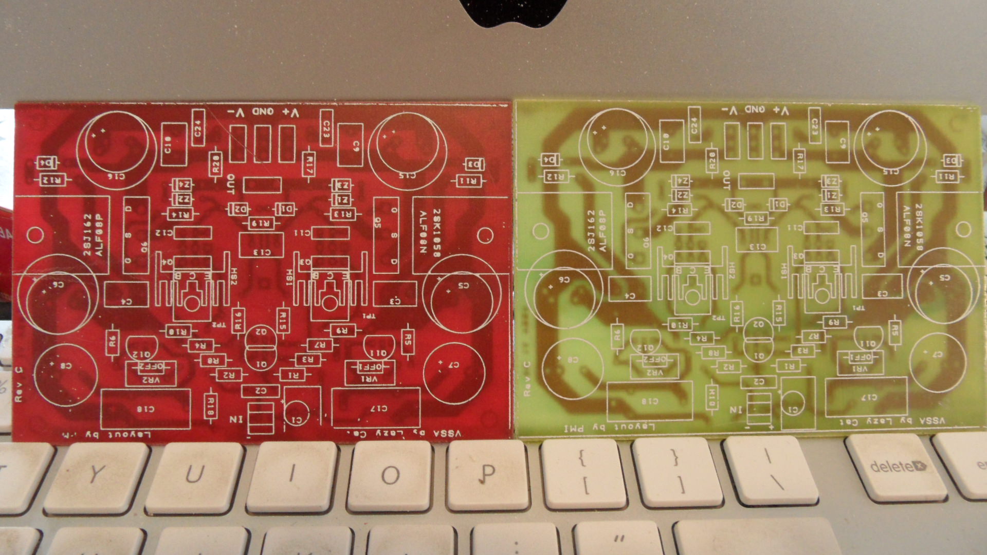

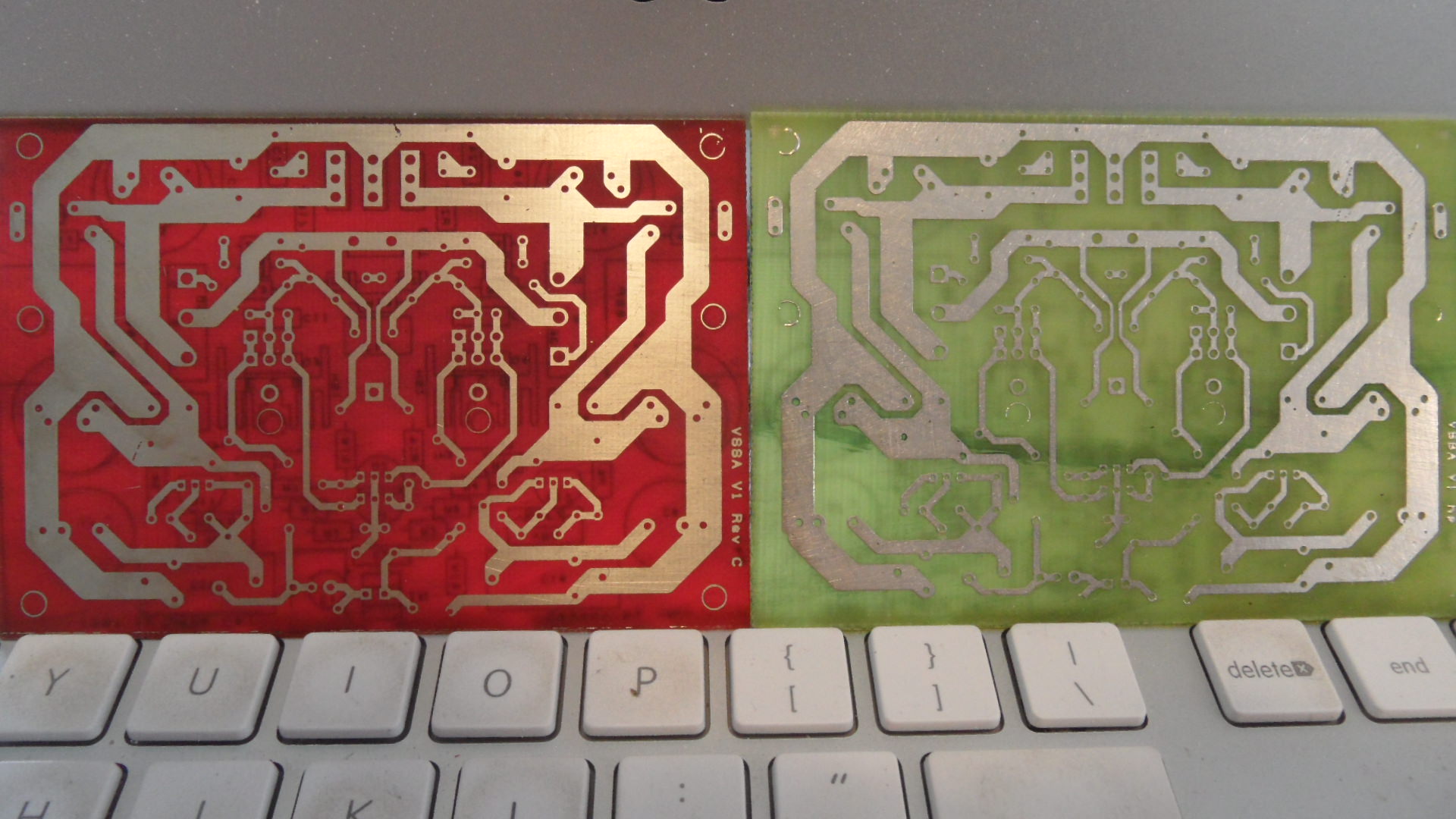

Pete,
Thanks for the write up's. I will be starting my builds soon. Here are my 1st 2 DIY Boards. Red one is .032" 1/2 oz Copper. Other is .064" 1 oz Copper. Looking to see if Copper thickness makes any difference.😕
Rick

I am not sure if it will make a big difference, but detecting a difference, or measuring it, may be difficult.
Both boards look great! Did both etch about equally well?
Pete,
yea, pretty much. the 1oz board took about 15-20 mins with rubbing the board with a sponge, where as the 1/2 oz only took about 5-6 mins doing the same thing.
Have to go help my B.I.L. put up a cell phone repeater now, so no more fun for a while

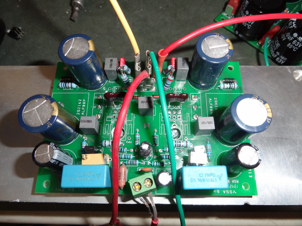

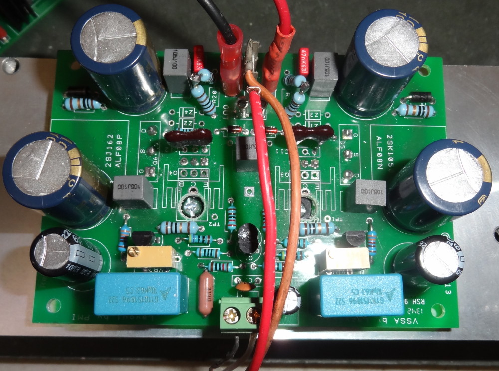

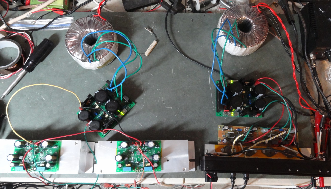

Thanks Pete, that is exactly what I needed. I set the VAS at 140mv and that took the overall bias to 152mA measured at the + rail with an ammeter. I used two meters to set the bias and it worked really well. Takes a minute to get used to twisting two screwdrivers at the same time but once I got the hang of it, things went pretty well. I have had it playing for about an hour now so I could be sure the heat sinks would be sufficient. Looking good so far. In a while I plan to hook up Jason's TO-3 design and A/B them to see if I can hear any difference.
Blessings, Terry

Thanks Pete, that is exactly what I needed. I set the VAS at 140mv and that took the overall bias to 152mA measured at the + rail with an ammeter. I used two meters to set the bias and it worked really well. Takes a minute to get used to twisting two screwdrivers at the same time ...
You don't actually have to do it simultaneously. I usually do them alternating, one turn on the left, then one on the right, etc.
Congratulations, you are officially the first one besides me to get the new boards playing music!
According to Lazy Cat, it takes up to 50 hours (!!) before the electrolytics settle down. I can't verify that long, but when I first assembled the second board, after listening to the first one for a few days, they sounded different. (I swapped speaker channels, just to make sure). About a 1-2 days later, they were the same, to my ears, anyway.
I am curious, and also for anyone else - how long did it take you to calibrate the boards?
edit:
Do you have VAS compensation caps installed on the boards?
Hi Pete,
The first board took probably upwards of 10 minutes to set because I first set the offset and then the VAS. While doing that I realized that the offset changes as you turn the pots to set the bias. Then when you readjust the offset it changes the bias. Felt like I was chasing my tail. Once I hooked up two meters I was able to keep the offset low while I was adjusting the VAS so when I got to around 140mV it only took a few slight adjustment to get everything settled. The second board took less than 5 minutes including hooking everything up.
I'm running the rails at about +/-37.8vDC. I hooked it up to my scope and it begins to clip at about 22vAC into an 8ohm dummy load.
I have both yours and Jason's playing side by side and hooked up to an A/B switch. They are very close in sound but not exactly. There is just a slightly different voicing between the two. You have to listen closely to hear it. I will assume it is mostly the caps breaking in. Jason's boards have a couple days play time and of course yours are spanking new. Still fun comparing. 😀
Yes, I installed 47pf mica in C11,12.
Blessings, Terry
Edit; I forgot to mention, I installed the VAS on the main heatsink. Mainly because I didn't have any of those cool tiny heatsinks you used. My question is how did you plan to attach them to the heatsink? I had to drill out the holes in the PCB to be able to fit the screw heads through to the top of the transistors. The MOSFETS are tight against the bottom of the PCB so I just tightened the PCB down onto the top of them but because the VAS trannies are so much thinner you can't do that with them. Just something to think about.
