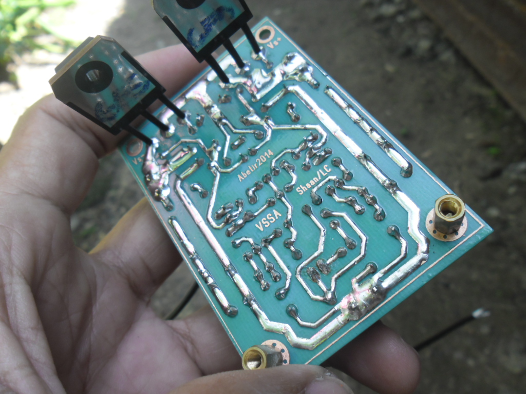

My bad! resistor values meant to be 750ohms and 820ohms. In my final build I settled for 2 x 1.5k in parallel, that is 1500/2=750. DC offset was 0.6mv.
...and my manner of soldering (inspired by thimios soldering method)..my first proto board..
thimios, sorry my friend i'm getting out of topic...
Thanks. I'll probably start with pots so I don't have to solder and unsolder parts too many times. That's hard on home etched boards. That's some very clean soldering. One of these days I will have to learn how to do those measurements like thimios does. That would add to the enjoyment.

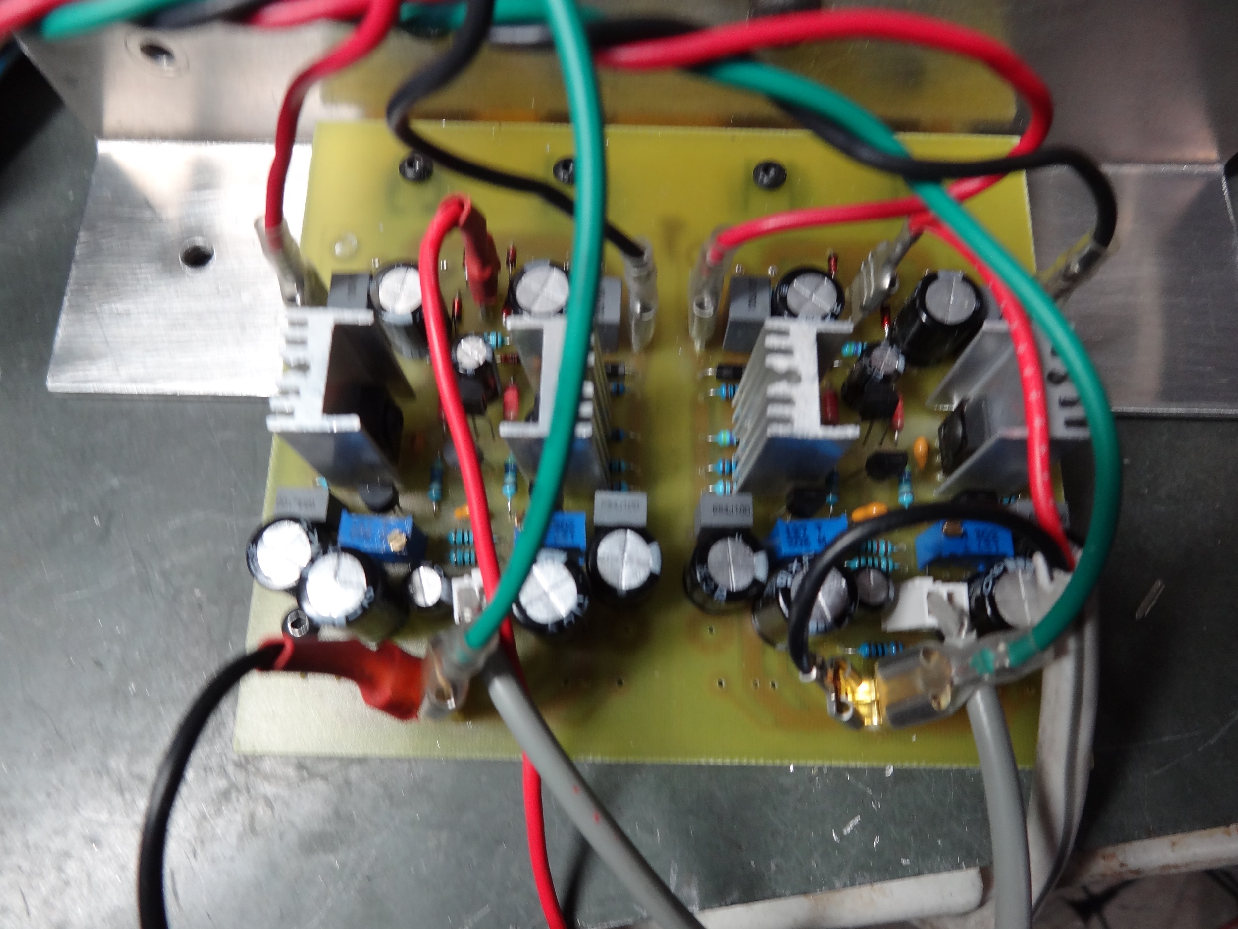

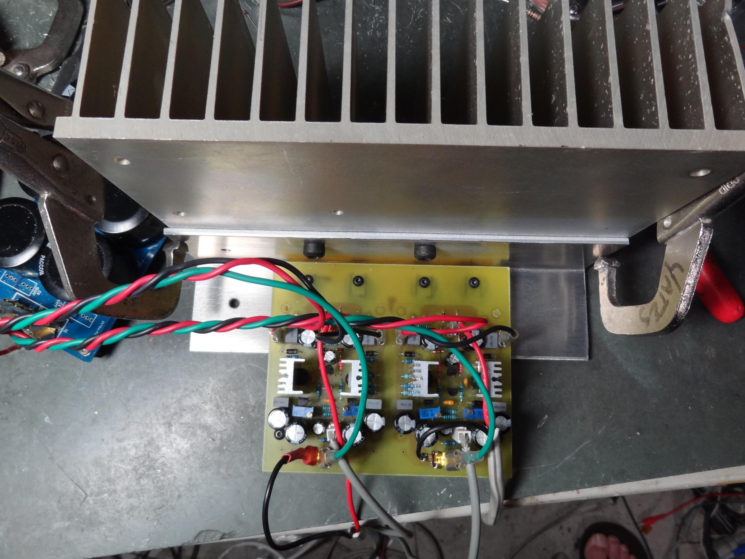

I finished the amp based on your layout. I installed 2k pots rather than resistors. I'm running it on +-44V rails and the posts ended up at 470R on one board and 500R on the other with the VAS current set to 14mA when warmed up. I tried a few different rail settings and the VAS current changes with each each rail change so I will leave the pots for flexibility. It would probably be better with 1k pots. I may change those out. This is a nice layout. Easy to etch and build. A 14ma the vas runs pretty hot. I think the little heatsinks are necessary.
Blessings, Terry

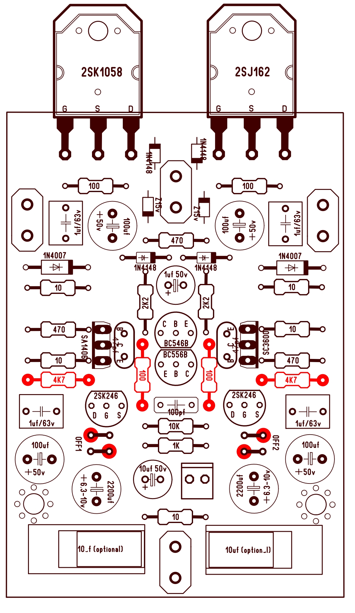

Very nice Terry, at -+44v I'm glad it worked smoothly I have never tried my amp to reach that power level. :) You may want to do some changes to suit your current (-+44v) psu rail (attached changes in red). It looks to me that VAS works at its optimum. On the other hand if the amp shows no sign of instability then leave it be. You've got excellent heatsinking :up:
All's well that goes well :cheerful:

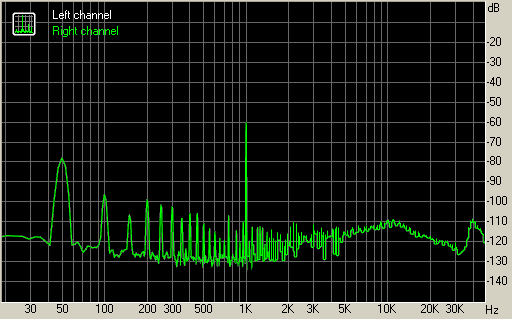

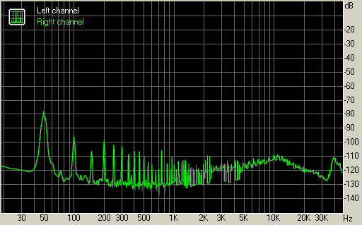

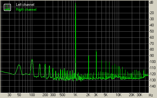

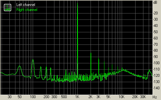

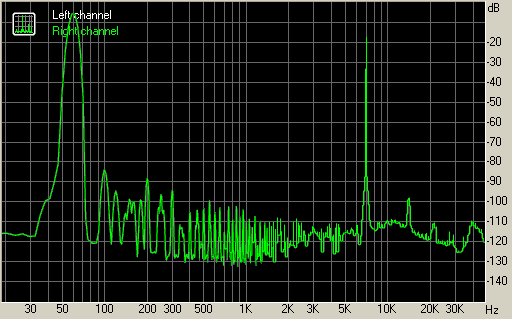

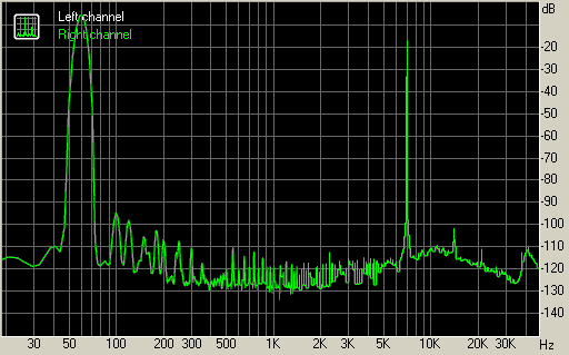

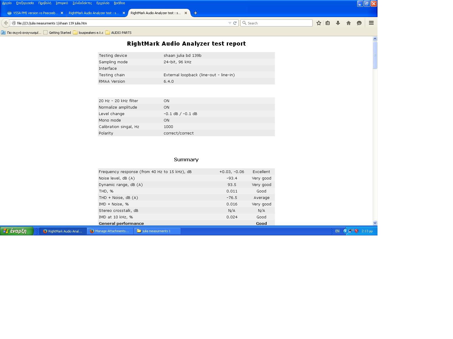

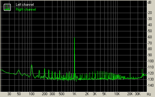

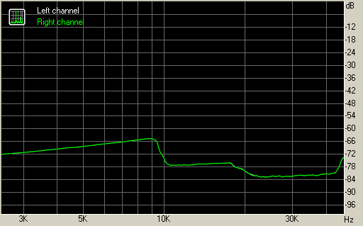

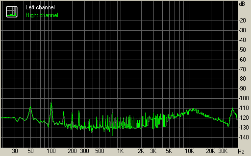

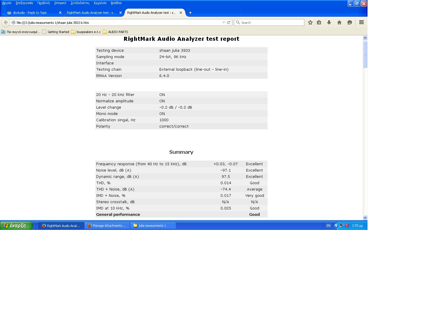

New test
Shaan original vers. with KSA1381 KSC3503.
2)frec.responce
3)dinamic range
4)indermod.distortion
5)IMD
6)Noise level
7)THD+NOISE

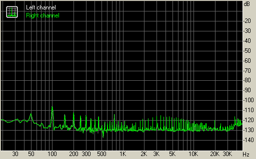

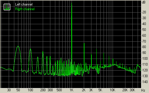

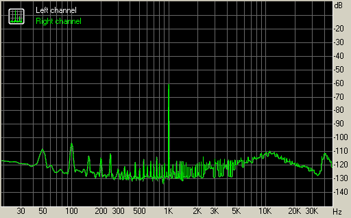

New test
PMI vers.
All these test on a 6R dummy load.
What would you like to prove, that resistor is better than CCS? If you use shitty CCS is exactly what you came across here. VSSA module measures far better than resistor only CCS. I made this kind of measurements some two years ago.
I agree.
You should replace Shaan version with CCS and replace PMI version with resistor only CCS. And take some measurement.
