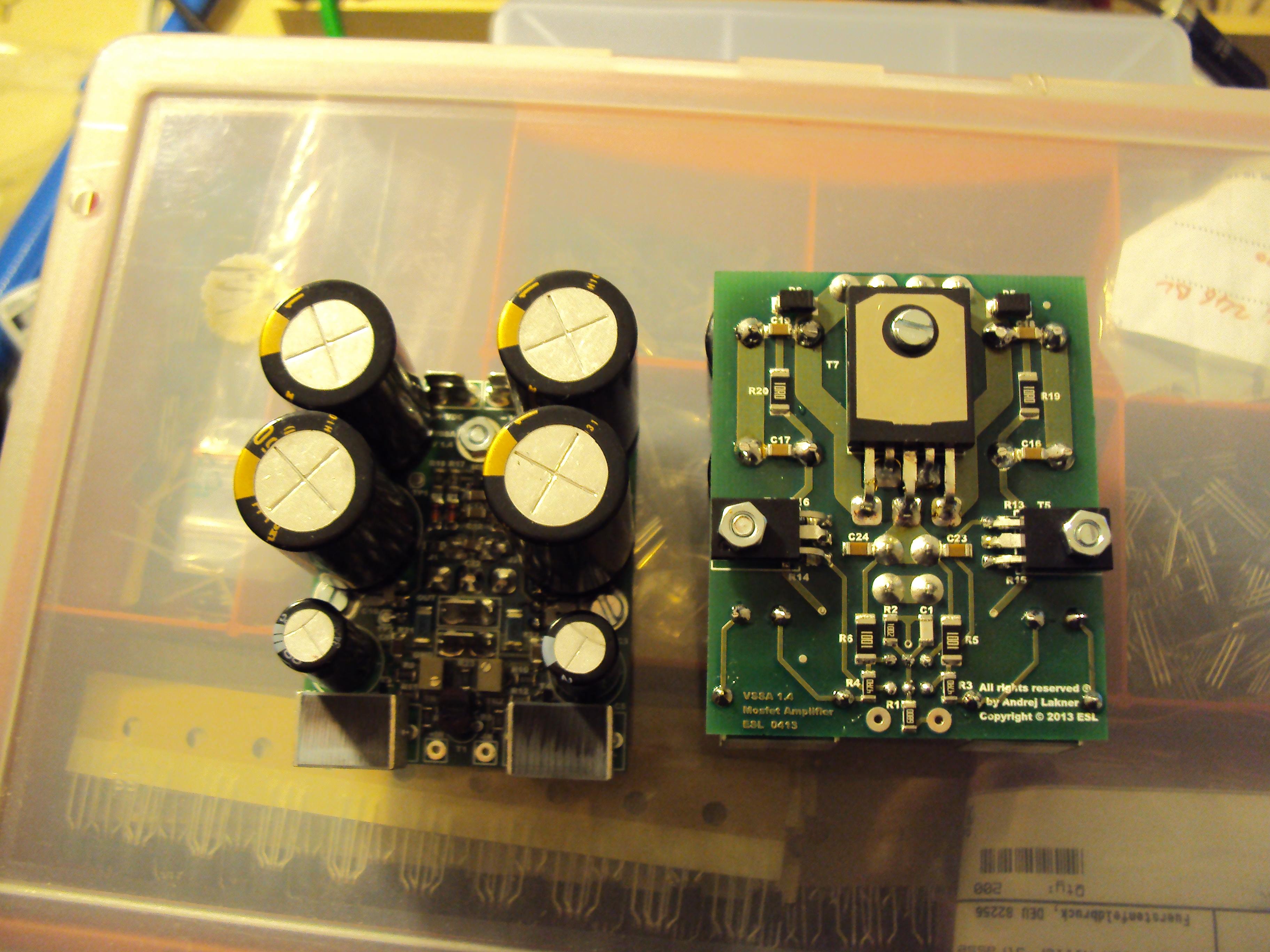

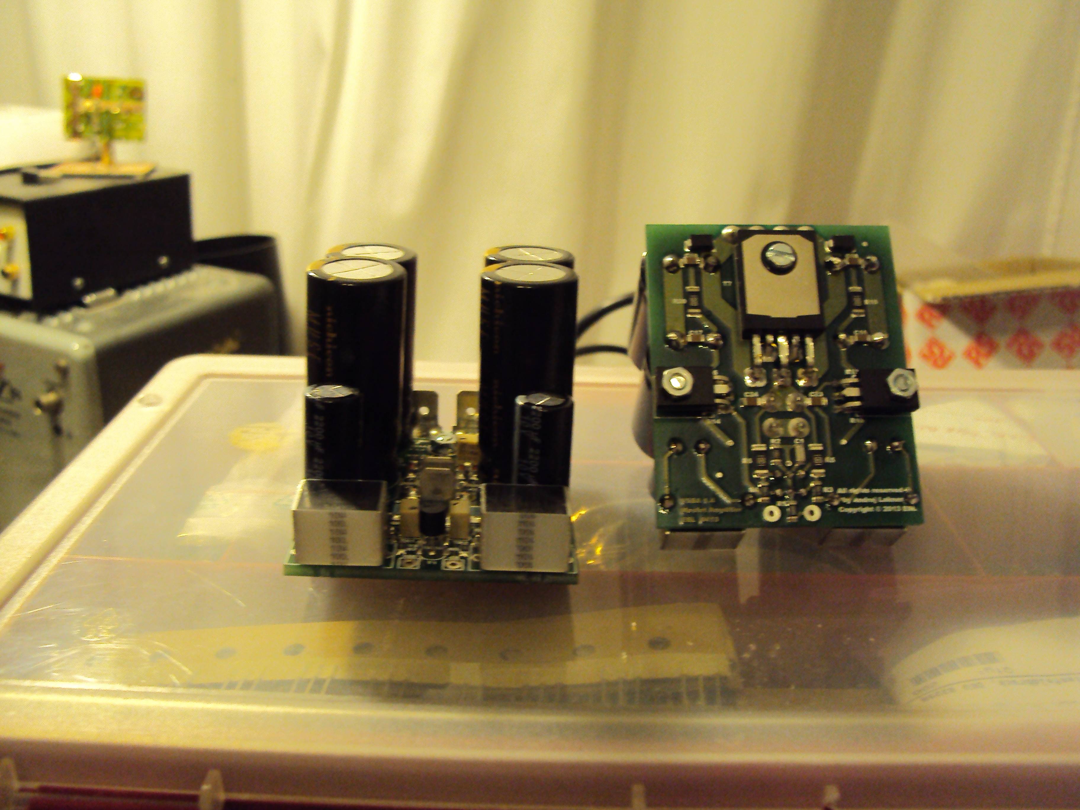

I was following your provided instructions with care. Just felt weird having continuity on the mosfets to heatsink. So if it's a green llight I'l proceed to adjusting with my 35V unregulated PSU. I'm waiting for my second DMM to arrive. But maybe with a bit of luck I could adjust it only with one DMM. Wish me luck. :c_flag:
My VSSA modules are build.

Calling sng001, PMI, miksi and all others to show current results on VSSA modules assembly. Is anyone there already made a working amplifier base on VSSA? :sing:
I'm not at home at the moment but yesterday I've replaced R19 and R20 with 1206 combo- 4x10 ohm, R23 was very difficult to remove so it's just piggybacked with 1206 zero ohm 'resistor'. Grounding finished as in schematic given earlier. Both channels turned on for about hour (everything was OK). Later afternoon, when I get home I will check whether hum problem was resolved when in audio chain, or not.

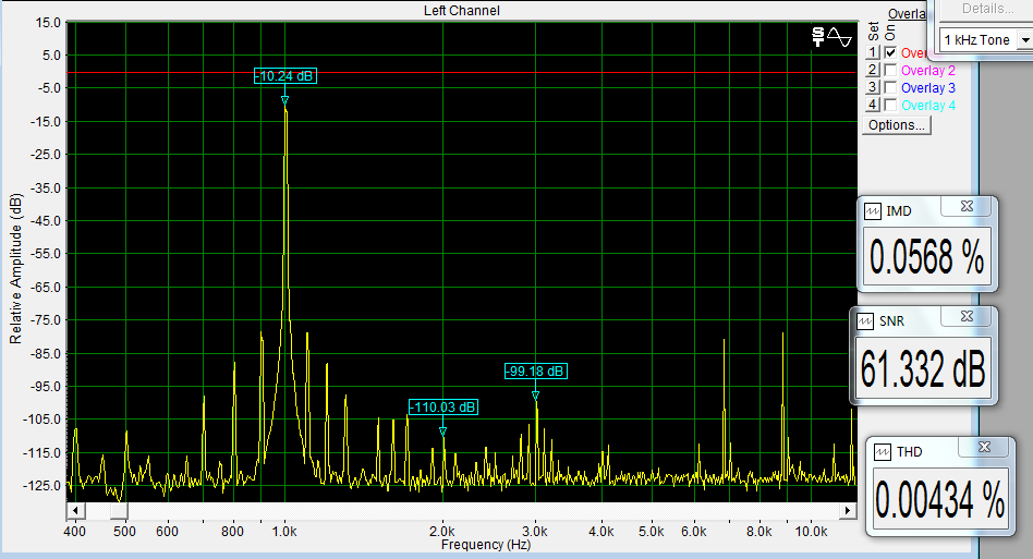

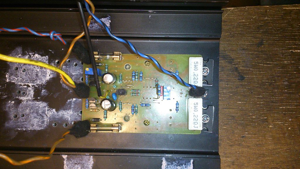

I putted BJT toshiba drivers and outputs + little mod. Thanks LC for vssa again.
I did some pulse response test and must say that I have never had so quick bjt amp ever.
