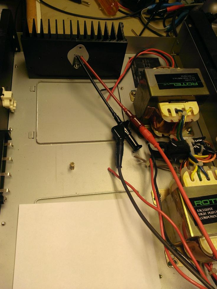

Heatsink testing in forthcoming VSSA home (old Rotel amp).
Heat sinks not so big but still manages about 20C above ambient at ~14W (VSSA bias).
