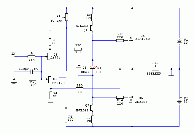

Next one: Mosfet input stage ? It present a lot of advantages. Fast, immunity to HF parasitic components and get rid of the nice double feedback path.
I did a JFET input version of this amp few years ago when I wanted to incorporate LATFETs into F5 (adding them as a Source Follower output stage to F5 topology).
Input stage biasing is easier (JFETs being depletion mode devices) and input impedance is much higher.
It sounded OK but I liked this one more...
Anyway, here is the JFET input, BJT VAS and LATFET output version (the forum member "fab" built something similar before me) of this amp:
