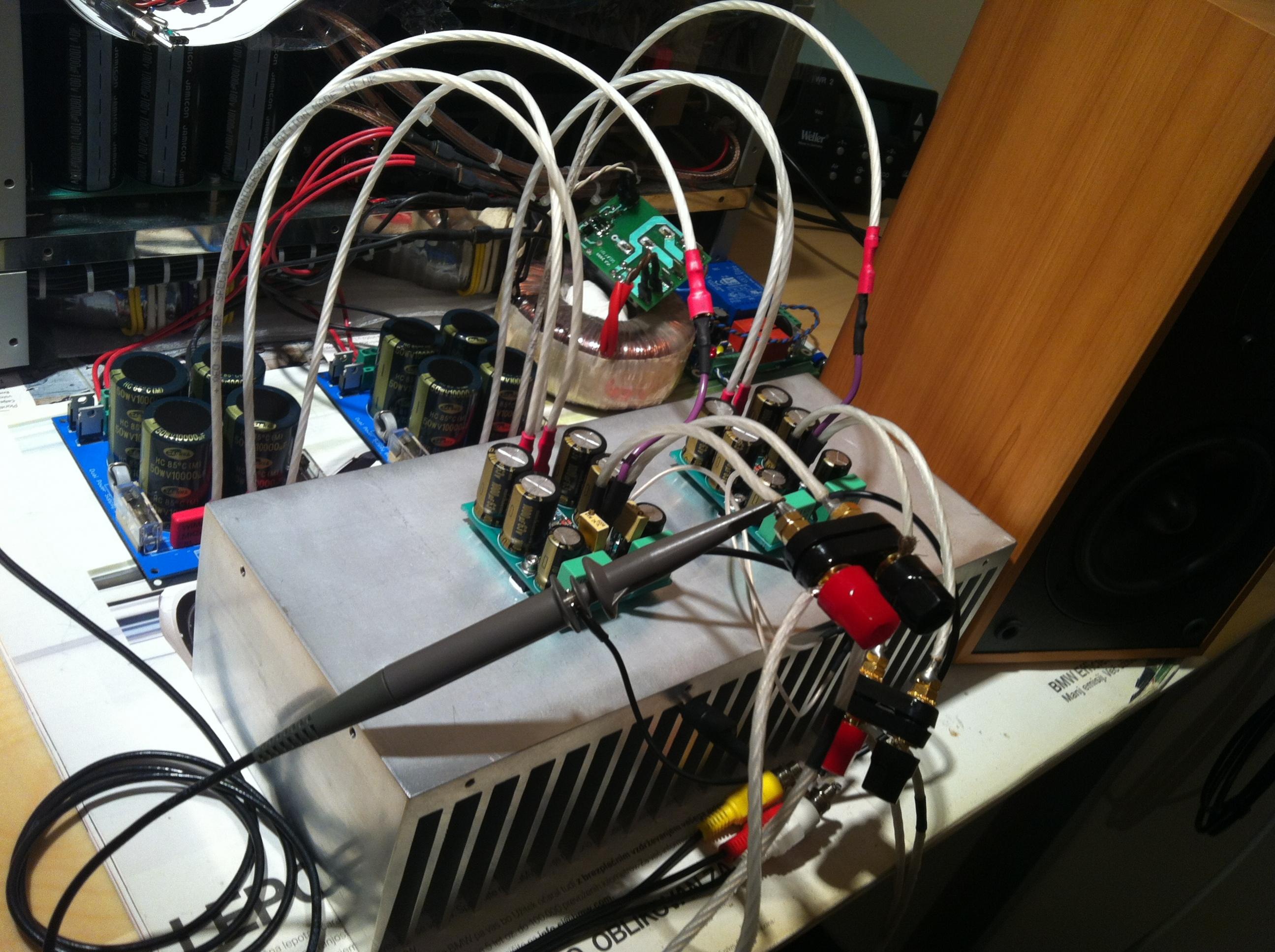

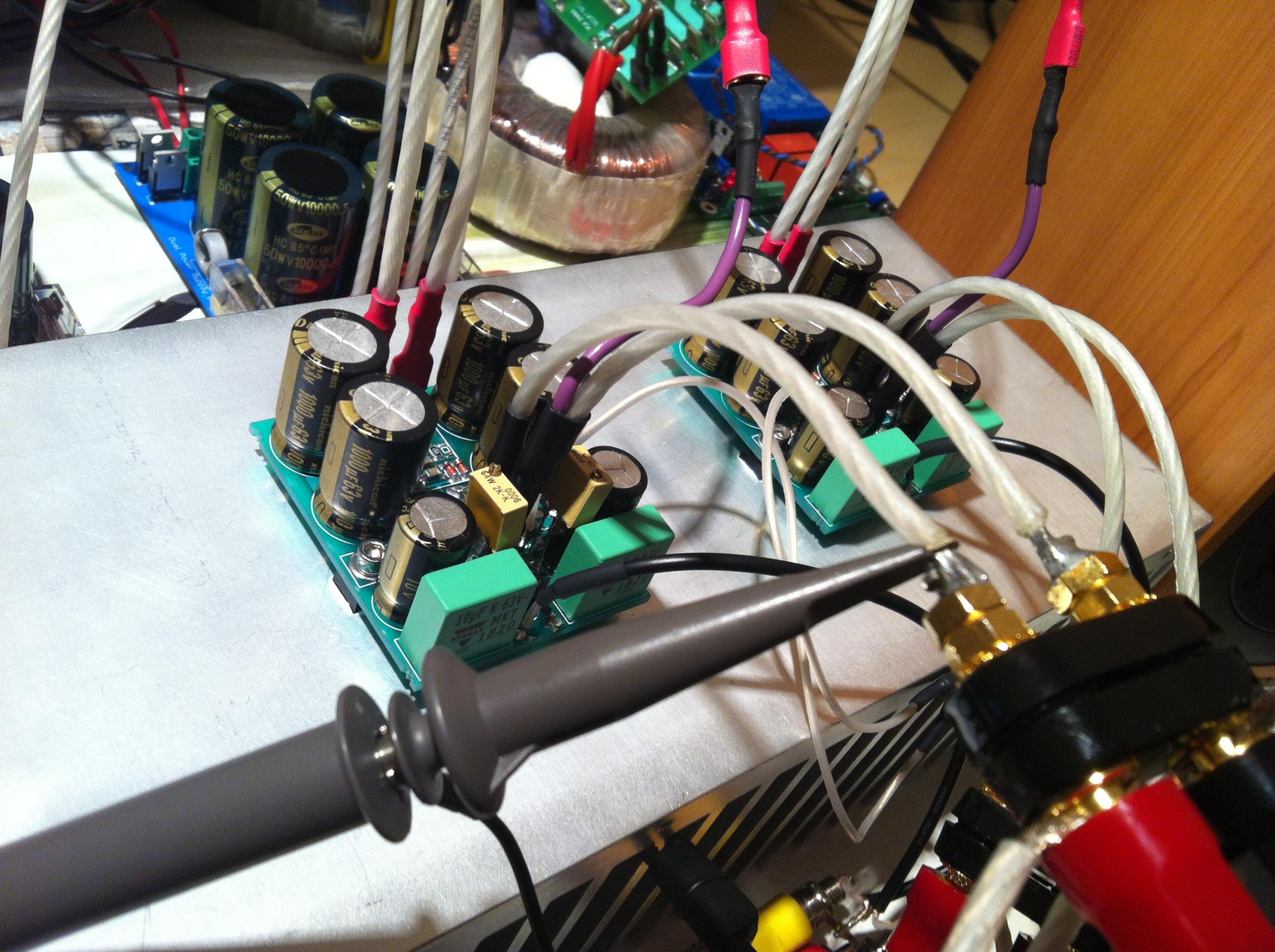

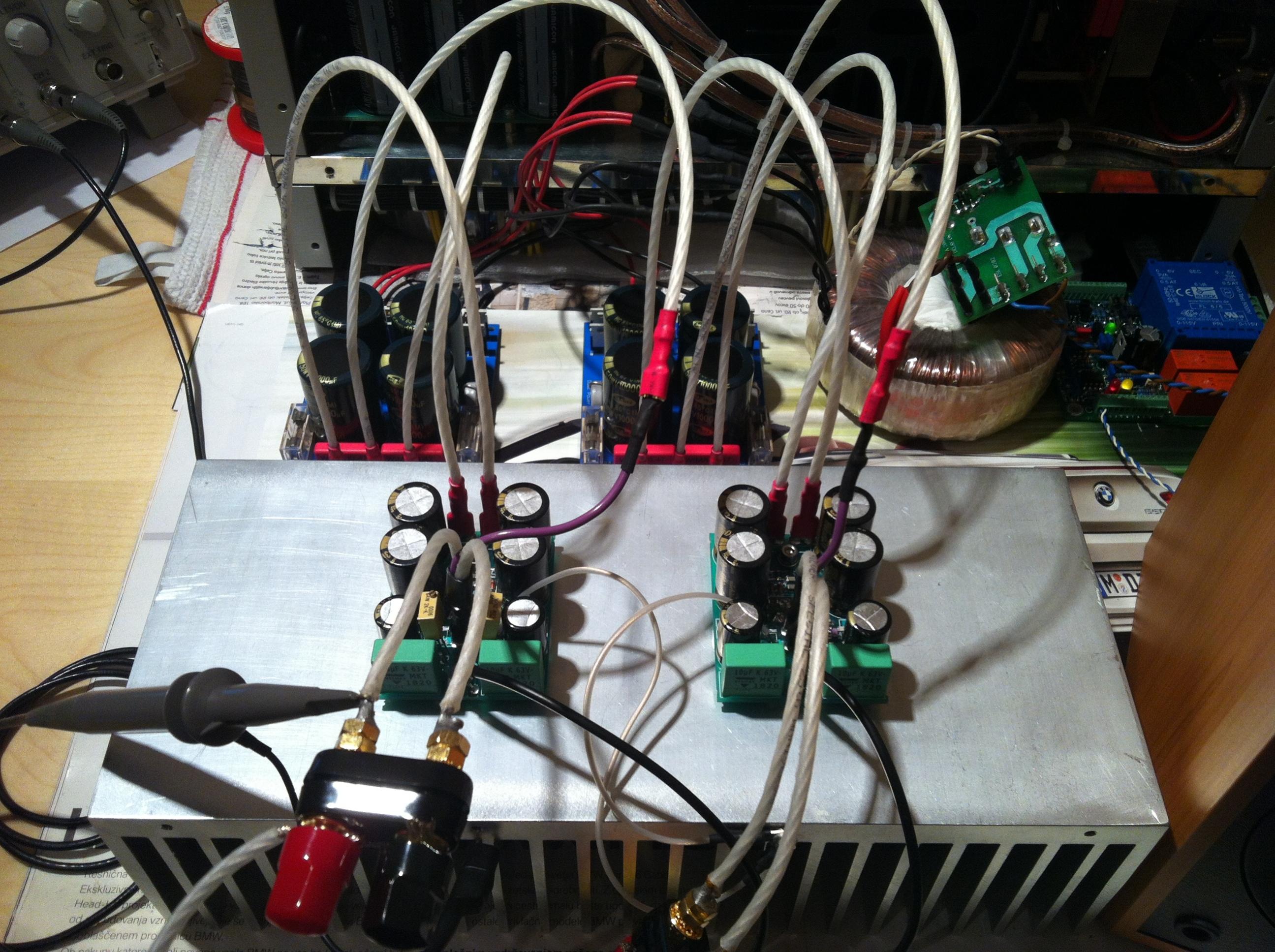

As promised here are some pics of the first lab listening test of both VSSA channels. Measurements will follow over the weekend. 😎
VSSA is a very, very good sounding amplifier, of course a lot of dependency factors included but if someone don't mess around too much, can definitely taste VSSA sound at its best.

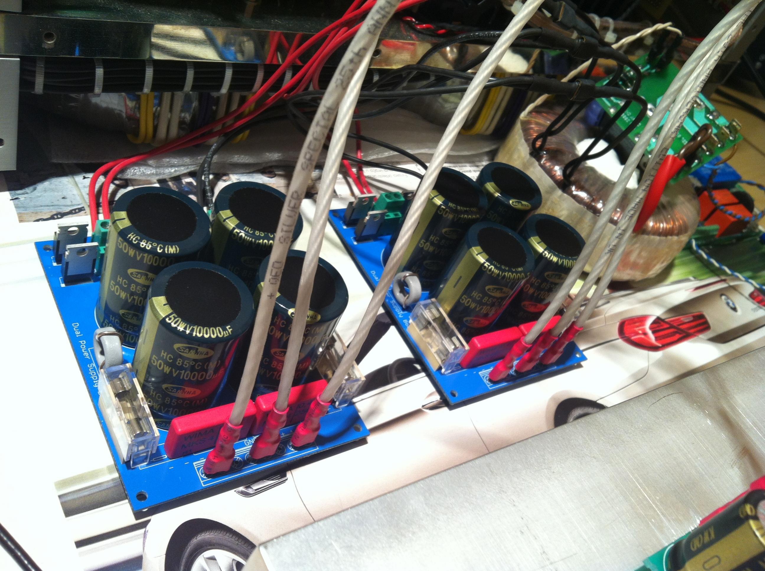

Samwhas were so cheap (1 €/pcs) that I couldn't resist them. Will place them away from sink as you recommend. For comparison purposes I'll assemble two PSUs with Nichicons and see how much better they're.

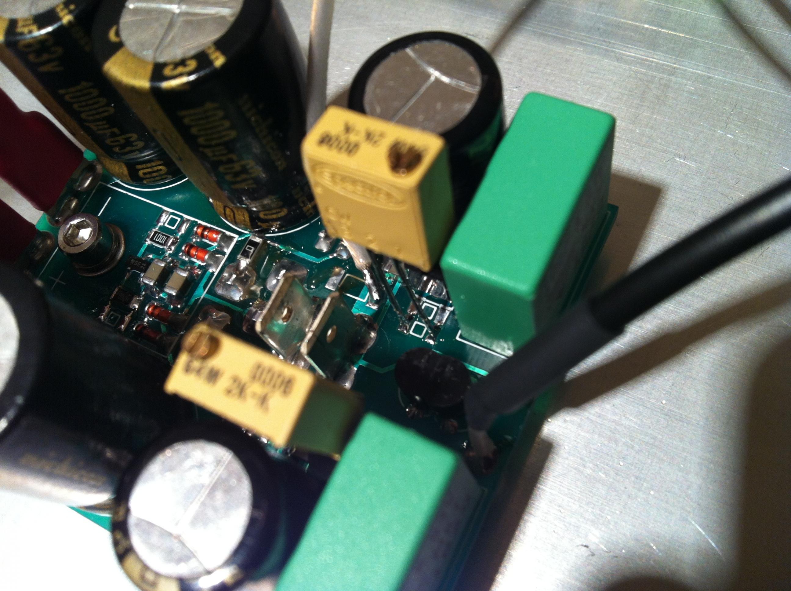

I lazy, Can you take some picture how you deal with trimmpod tunning (how you solder it an so small area..)

First solder cca. 15 mm pins onto SMD pads than trimmers to pins, when trimmed to correct output DC offset/VAS bias, cut and unsolder the pins. Measure the value and calculate which two values of standard resistors in parallel are close as possible to the correct value. In my case 1,2 k and 39 k in parallel gives 1,641 k and that delta is only 10 ohms away from desired 1,631 measured value. 😉
