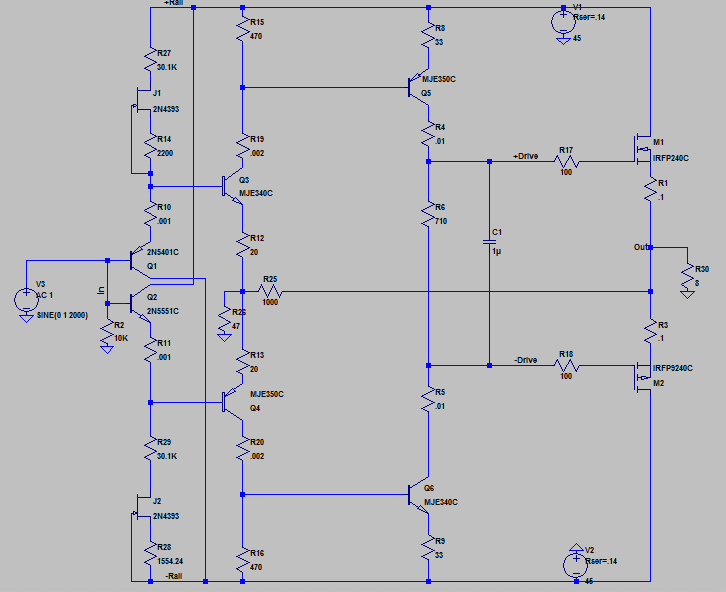

Thought I'd post this slightly modified version of the VSSA for some feedback. If you think this should go in a separate thread, let me know.

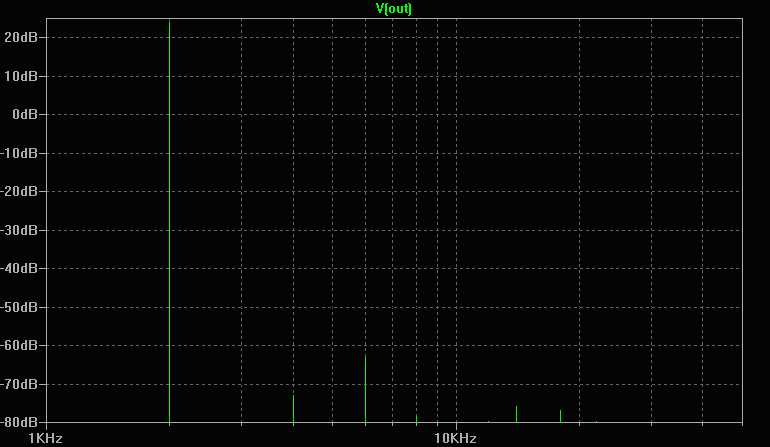

Instead of the AC coupled VSSA, the addition of a couple of small transistors on the front end allows the current feedback to come to a single node. Offset adjustment is done via one of the current sources. Here's the schematic and a 2KHz spectrum. It seems to have very similar performance to the VSSA on square wave reproduction too.
CCS are set to about .5mA and the output bias is set to around 200mA.

All SSA projects intentionally avoided diamond buffer in the input stage. The reason is mainly subjective. As you can see the results are similar so why bother with two extra transistors, as these are two extra variables for instability in the equation. I extensively tested diamod buffer, also listened the same amp with and without it, before started SSA thread and to MHO it sounds worse then SSA only.
But if you like to advance with the project you can start new thread and bring the design to PCB.
Regards Andrej 😉

Looking at the schema of vssa I honestly doubt(ed) that it would come even close to its mom soundwise, especially with those electrolytics in the feedback node. But damn, it did! Not just sonics, but the offset, it's fixed and rock steady at 110mV, no different from turn on to right now, no trimming. Man I like this, Fantastic! Finally the last boss in the game has been defeated. 😀
Also the different current injection node is something that tempted me so much that I had to give it a shot just to see that it actually works. It went very well. Got paid in full. Learned something new. :cloud9:
The amp is nothing less than a beautiful gift, simple, transparent, like an earth globe made of glass. Thanks again LC. We are indeed lucky to have you around.
shaan
I built the one in the first post.
Some changes: No miller cap, bd139/140 vas, 2x1N4148 for bias, 22ohm vas degeneration, no zobel, no parallel small feedback cap, 10uF input cap(nonpolar electro), 10K current injectors and, ahem, +-15V PS.
