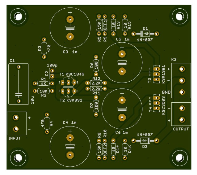

VSSA as preamp/driver
I have started a build of the earliest VSSA that deletes the OPS and deletes the bias spreader. The application is to have a driver for testing out other OPS configurations. Something for the bench for now and possibly for a final design eventually. With the parts I have selected, I can crank the voltage up higher than most conventional preamplifiers if needed.
I have parts on hand so if I burn a part there is no harm done.
Thanks, LC, for this circuit.

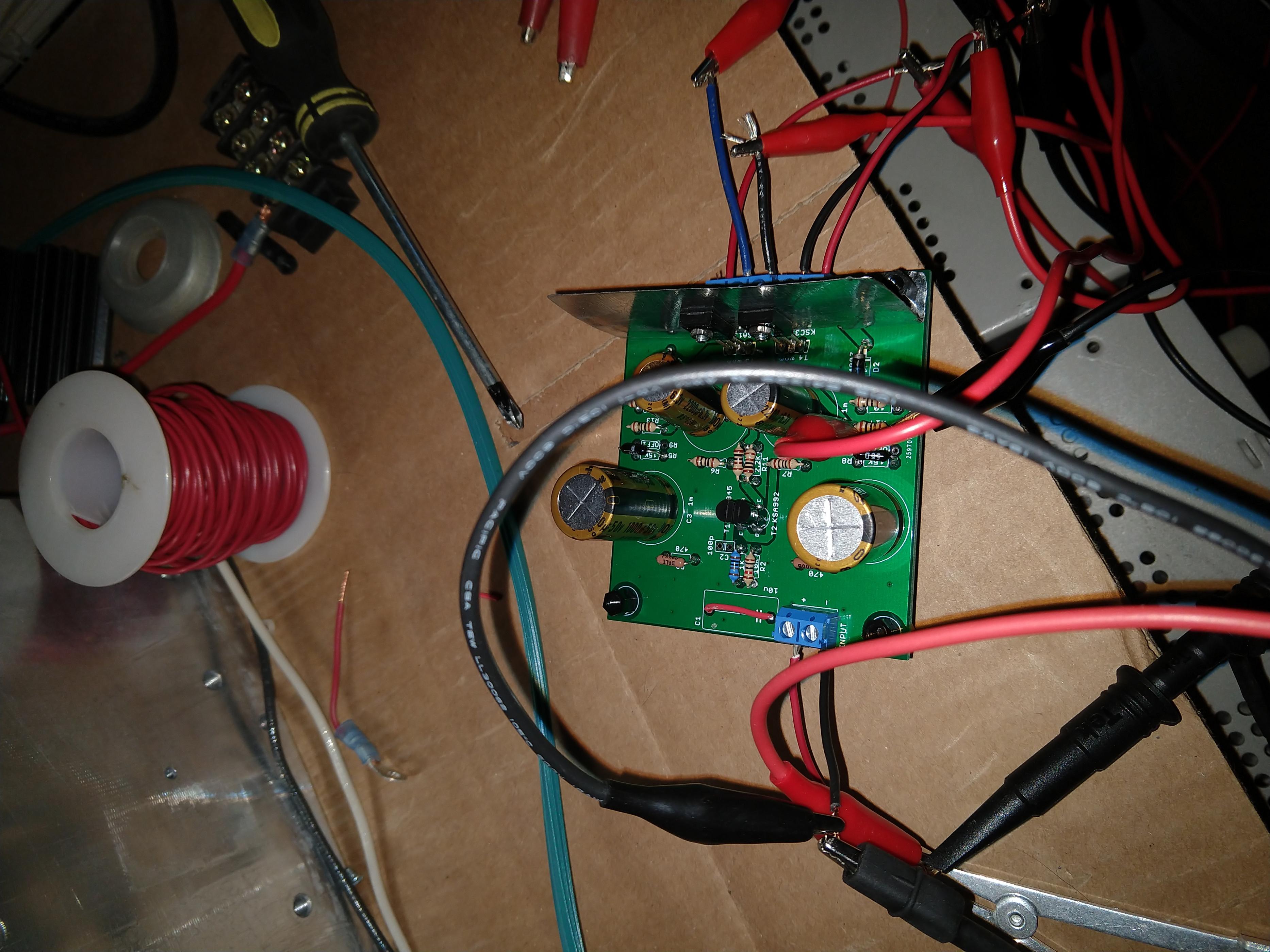

Built PCB
Finally have all the parts, matched transistors, no matching of resistors.
+ / - 35V rails. 3mV DC output offset. 2.2mA bias front end. 10mA bias second stage.
Output impedance 55-ish ohms.
Better than 60v p-p before clipping.
Bandwidth is insane. -3dB 14.3 MHz with a peak 10-ish MHz. Phase is quite wonky out in the MHz space.
Good enough to use as a driver for various OPS experiments.
Front end devices are 2SA970BK/2SC2240BL
Output devices are KSA1381E/KSC3503E.

Good front-end for transient transfer, no frequency peaking, no ringing, compensate for phase margin to be at least 90 deg at 0 dB to be stable.Good enough to use as a driver for various OPS experiments.
To put this kind of amp in high-end realm, OLG should be 100 dB or more, by maintaining speed and stability, and that is a challenge probably unreachable with such simple circuit.
