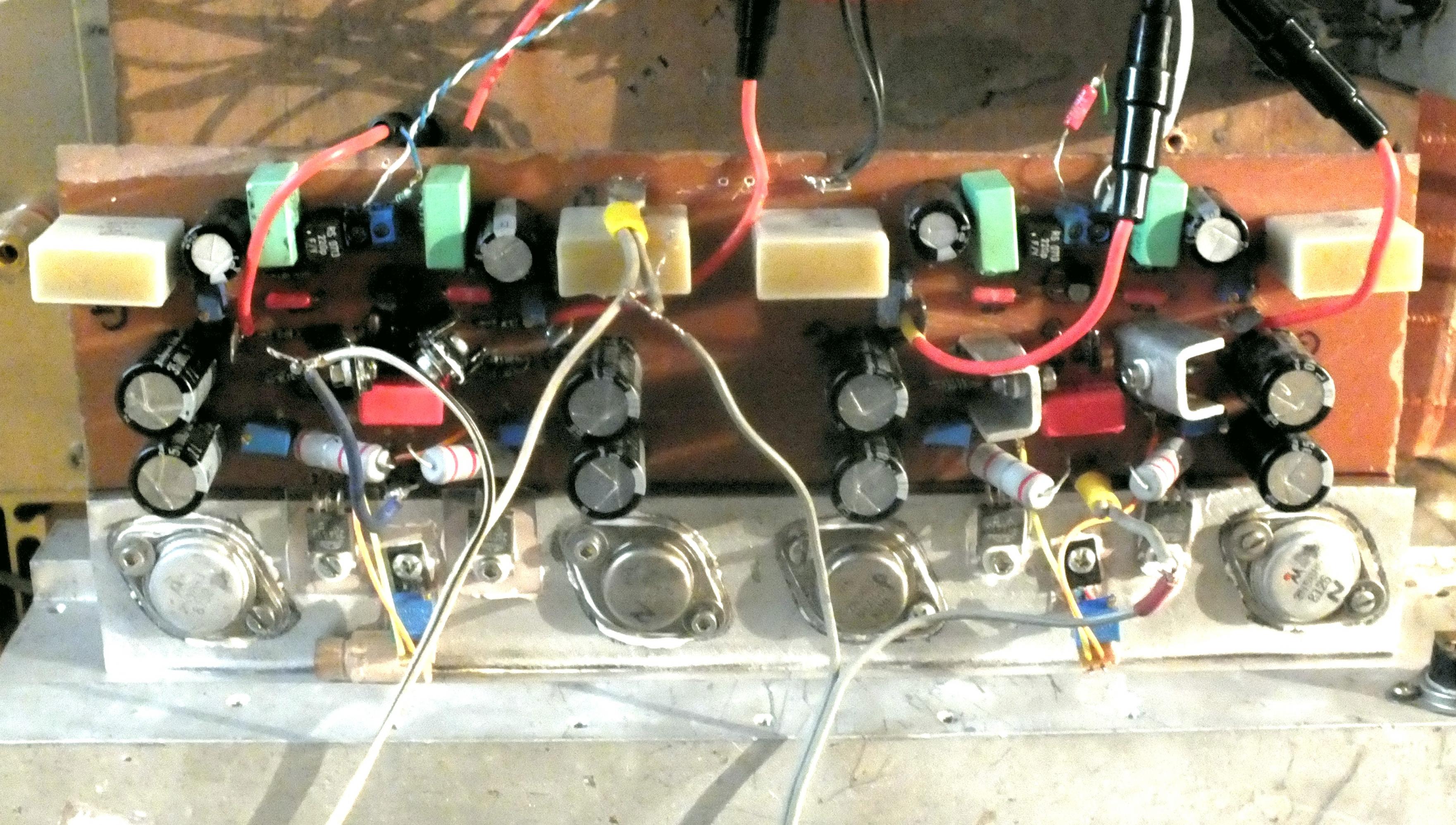

There are two boards VSSA MosFet Amplifier V1.4 as well, as there is power supply smps 1200A180
Prompt is compatible to use and you can implement soft-start it?

specify how to pins and a connector SMPS 1200A180, you need to connect the + and - output protection board ?!
Very simple task:
- SMPS1200, J4, Pin_9, connect to -pad of both DC sense modules
- SMPS1200, J4, Pin_10, connect to +pad of both DC sense modules

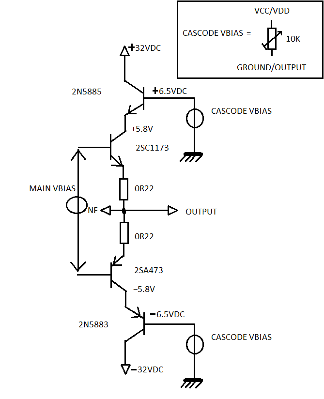

Guys,
When you are bored, you should really try the "Cascoded output" version of the VSSA. I did an all-BJT Cascoded version of this wonderful little amp and it sounds more open and transparent than the original BJT-VSSA. 😎
My goal is then make a V-FET Cascoded VSSA in order to have a fast, dynamic and transparent amp. 😉
Then, maybe and "all cascoded" amp...
M.

So you will have only about +/- 25.5 Volts available for the output to swing to even though the supply is at +/- 32 V!
Below about 35 watts into 8 ohms I guess.
I am still in the phase of study and experiment but I have not confirmed yet what is the power behavior with the scope. Anyway, It doesn't worry me because:
1) The goal is to have a better sounding amp.
2) I have sensitive speakers so there is still plenty of power.
3) I have ready to go power supplies with +/-42VDC, +/-60VDC and +/-72VDC, waiting for some action. 😎 The bigger one will have 3 cascoded VFETs pairs per channel, if all goes well...
M.

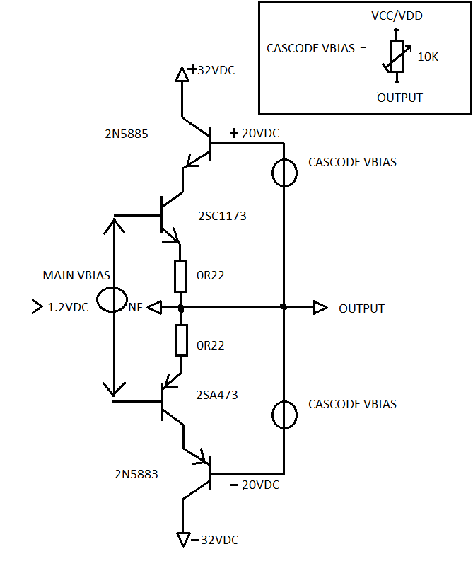

Quick update. Many experiments as time allowed and many transistors that went to semiconductor heaven.
I got it wrong at first. The lower BJT is the one that makes the voltage swing and the upper "cascoded" BJT provides the current gain, apparently...anyway, I am making experiments with incremental Vbias for the base of the "cascoded": now +/-20VDC and 0.6 lower for the collector of the lower unit. If everything goes OK, I will continue to increase the Vbias until the "cascoded" BJT stops working and/or the amp becomes unstable...I guess around +/-25VDC or even more, depending on the transistor chosen.
It sounds wonderfully dynamic, extended, open and detailed to me, but I can be biased 😀
If anyone thinks about a clever way to bias it or other, just post.
This is a very recommended experiment.
