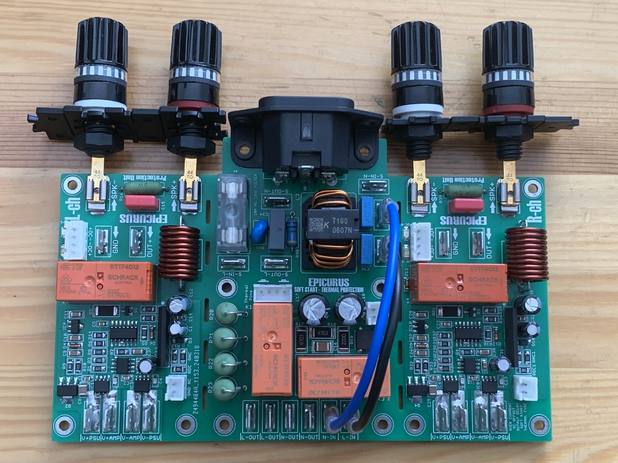

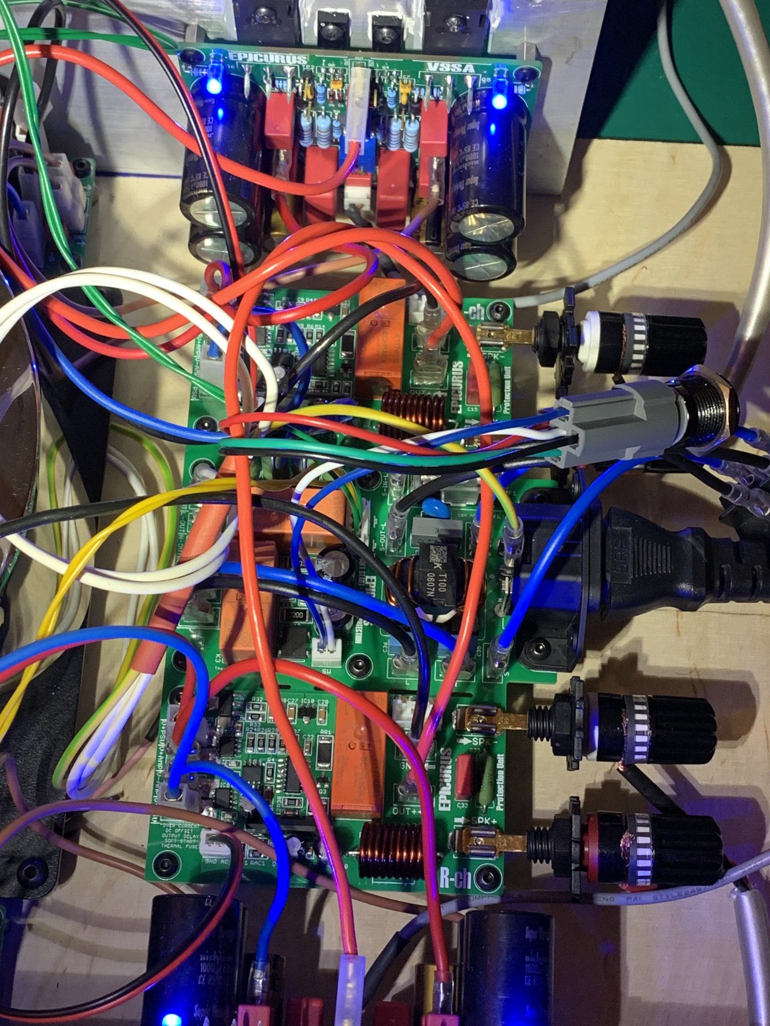

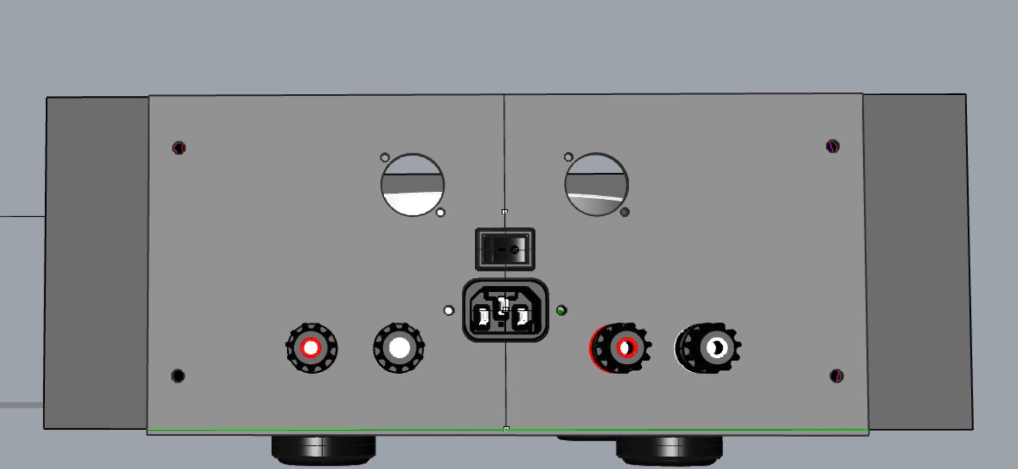

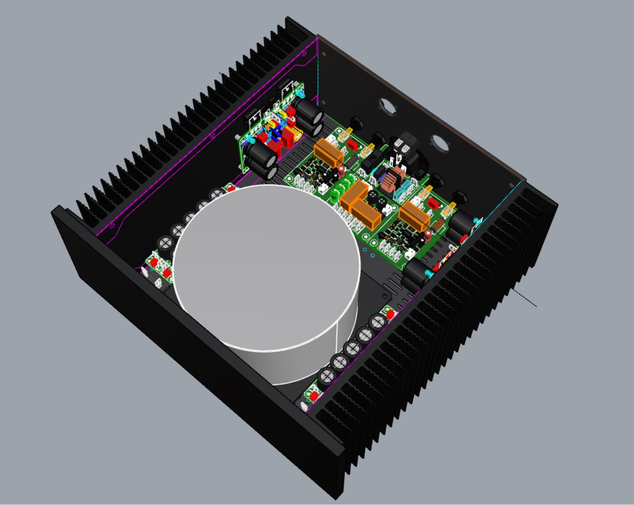

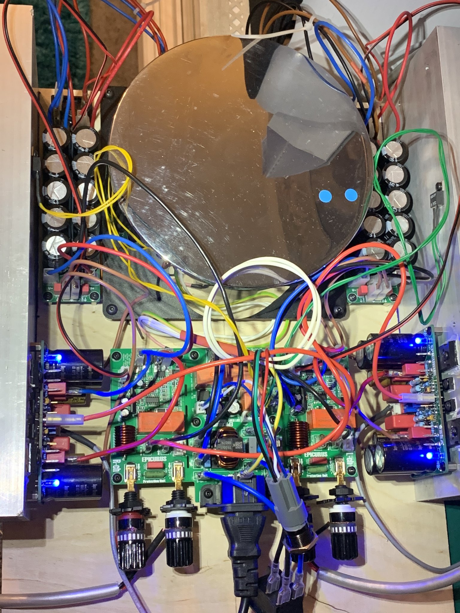

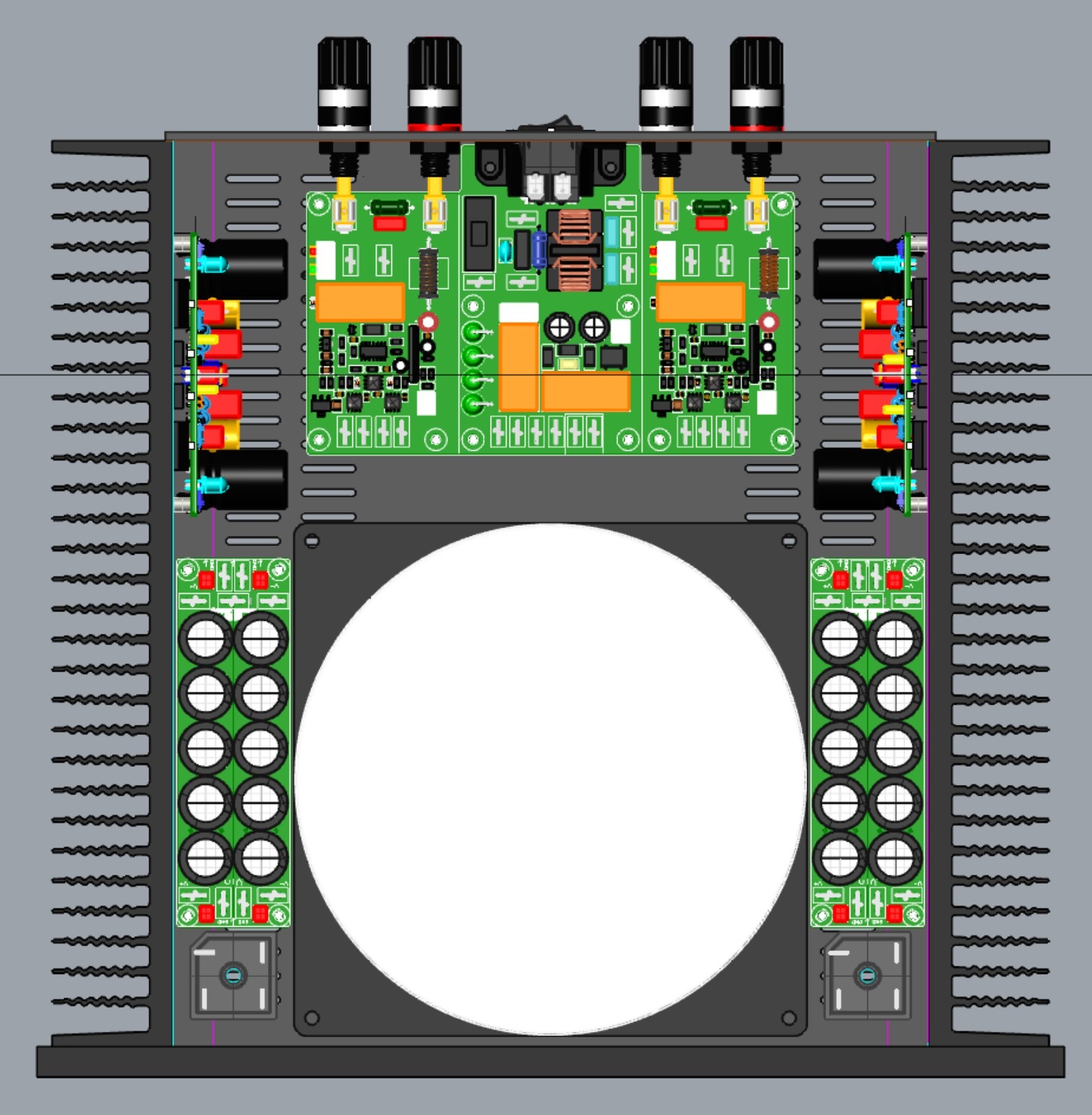

I have finished my VSSA amp prototype. It works very stable and warm...
VAS bias:120mV Output Bias 182mA offset 0.65mV
*500VA 4x30VAC transformer
*5X4700uf each rail total: 94000uf
*ECX10N20 and 10P20 Lateral mosfets
*Over current protection
*DC offset protection
*Speaker on/off delay
*Thermal protection
*Soft start
*AC main filter with varistor and fuse
