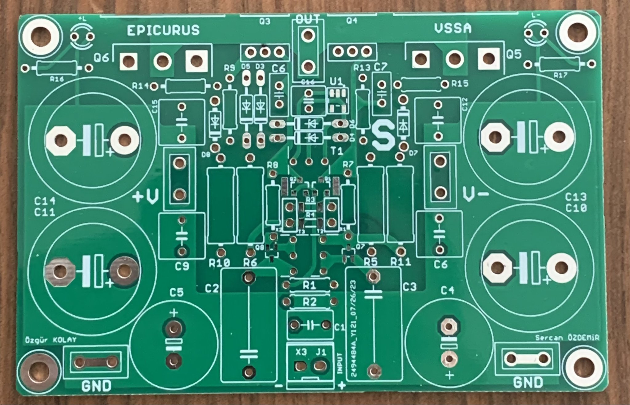

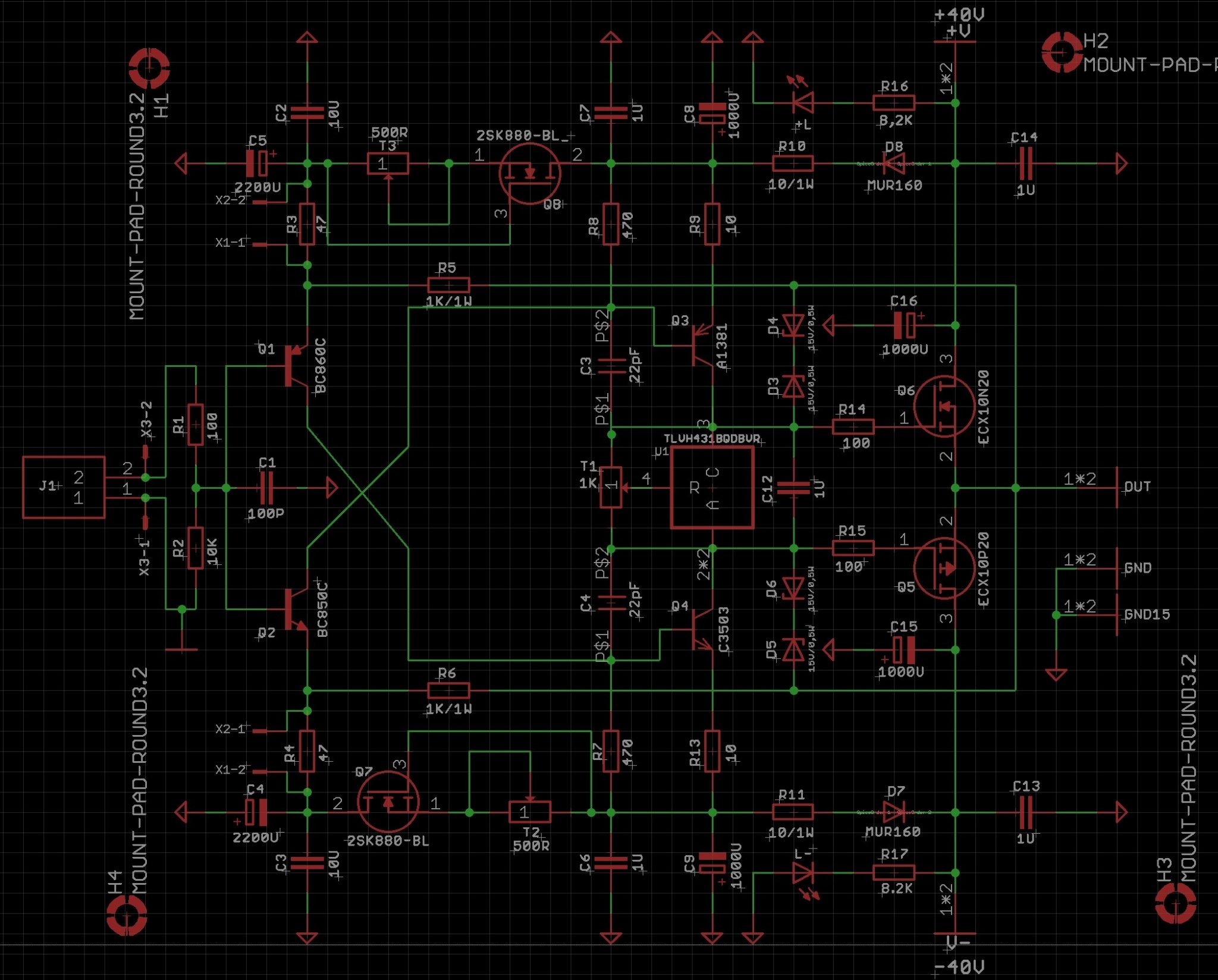

there are 192ma bias on amplifier, I think more bias can make more distortion on amplifier.ever trier class A bias of this anp?

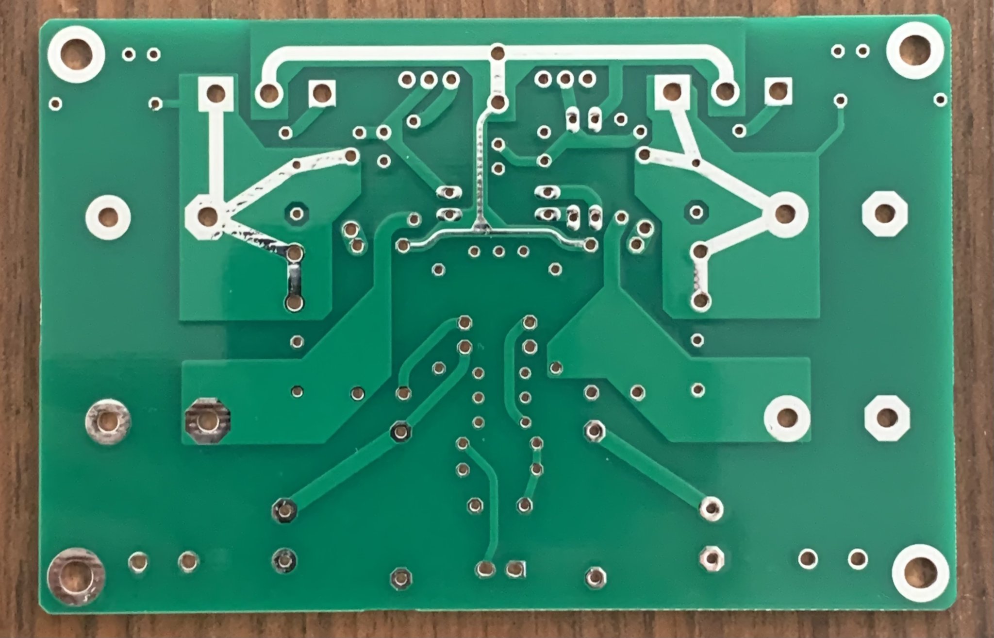

I revise it. on pcb toowhats wrong with the pads on the back of the pcb for C3 and C4? the Q8 pad looks black

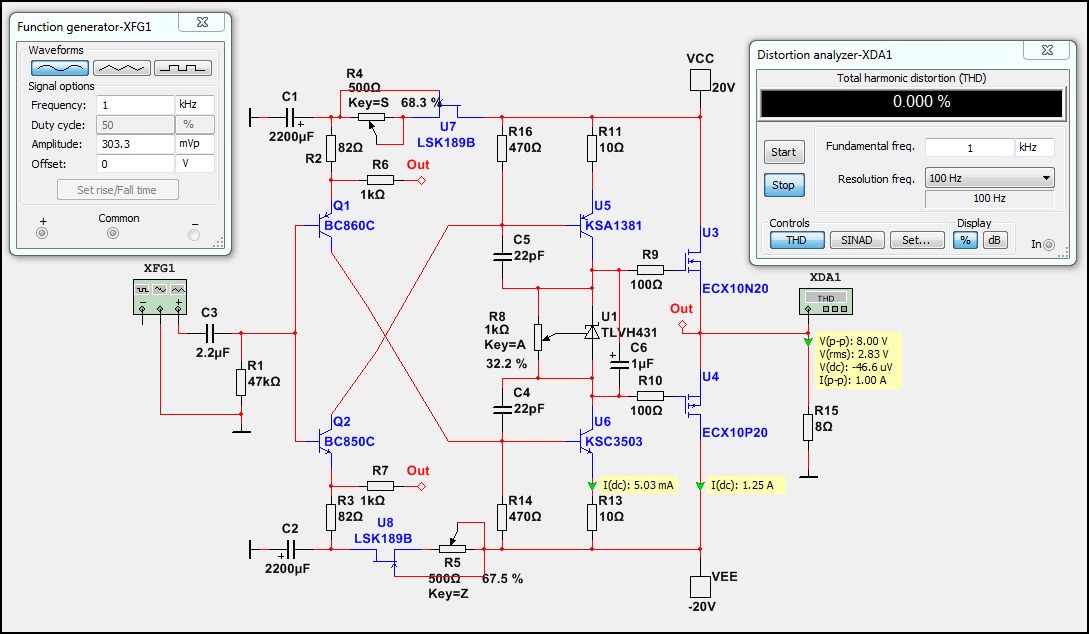

My simulation shows that more bias gives less distortion.there are 192ma bias on amplifier, I think more bias can make more distortion on amplifier.
I have used 200mA. THD 0.00060%
At 250mA the distortion is only half from that. THD 0.00027%
This is tested with 1 Watt into 8 Ohm.
I guess with Class A bias this amplifier has really low distortion.
But Class A with +/-40 Volt is not to recommend.
My testing is with +/-20 Volt. For this Class A is possible without to much heating.
Should not be very hot. Make sure there is no oscillation.It needs to really big heatsink
It happened to me with the PeeCeeBee which has a similar topology.
Did you equip the output with a Zobel network?
You cannot hear HF oscillations: you need an oscilloscope.I checked and i listen to my amp
it looks like a production\fabrication problem. also; the pads have very little soldering area.
It is drawed on eagle cadsoft and it works good. I dont have any solder problem. Signal and low current size could be little but high current and onboard caps have a big solder pad… if you use good flux you can solder top and bottom. But i will care and revise second time printed pcb thanks

This is a SPICE test with VSSA as Class A amp.
The voltage supply is set to +/-20 Volt.
The bias is 1.25 Ampere.
The gain is reduced to 13.2. Set by R6/R2 and R7/R3.
Result at 1 Watt level using same circuit for both cases.
Bias .... THD
0.200A 0.000591% Class AB
1.250A 0.000085% Class A
This is the circuit I used:
Correction for the best: R8 pot should be 2 kOhm.
