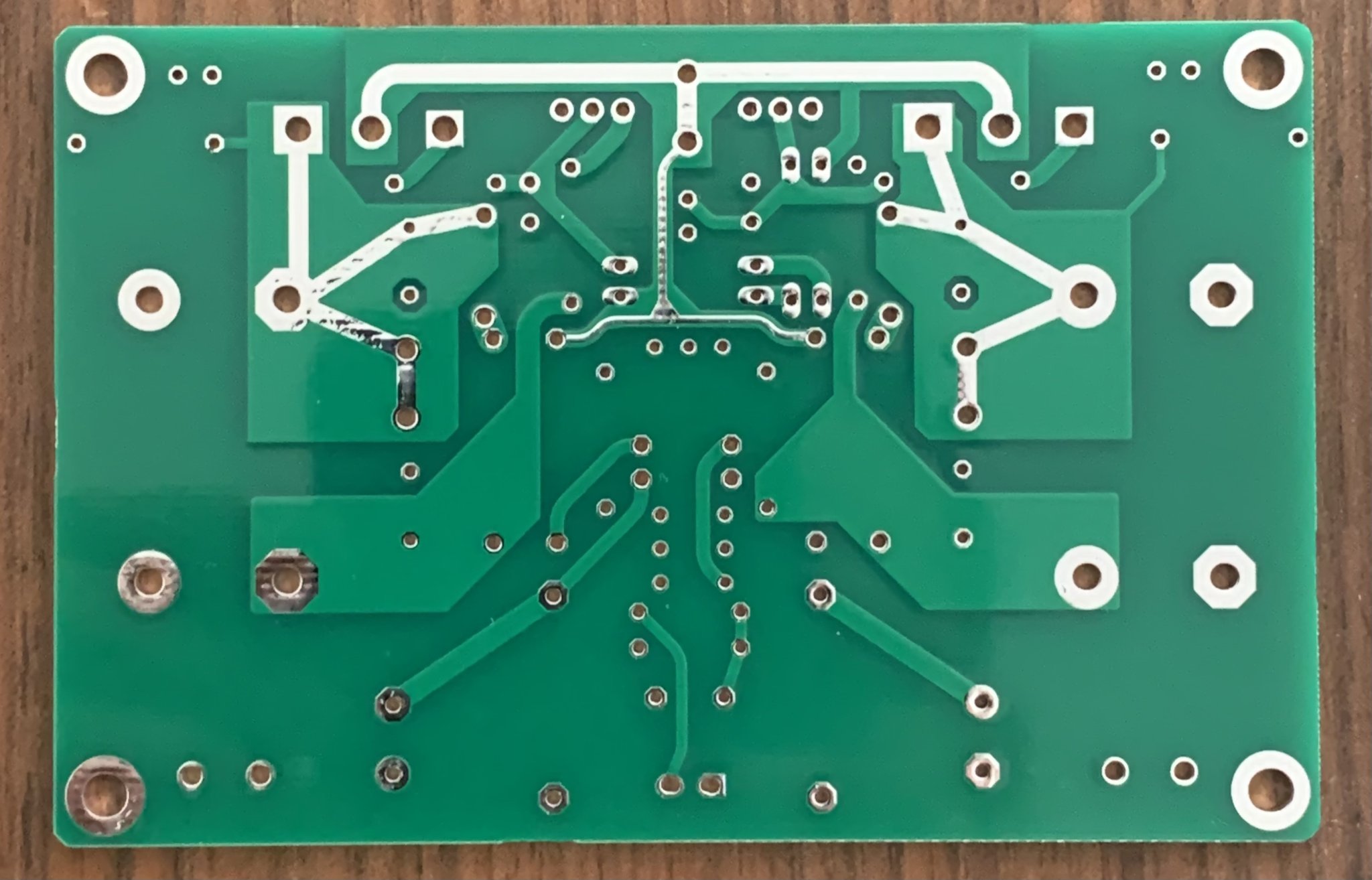

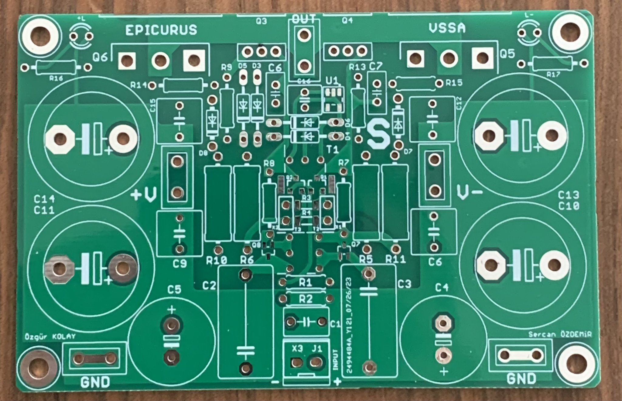

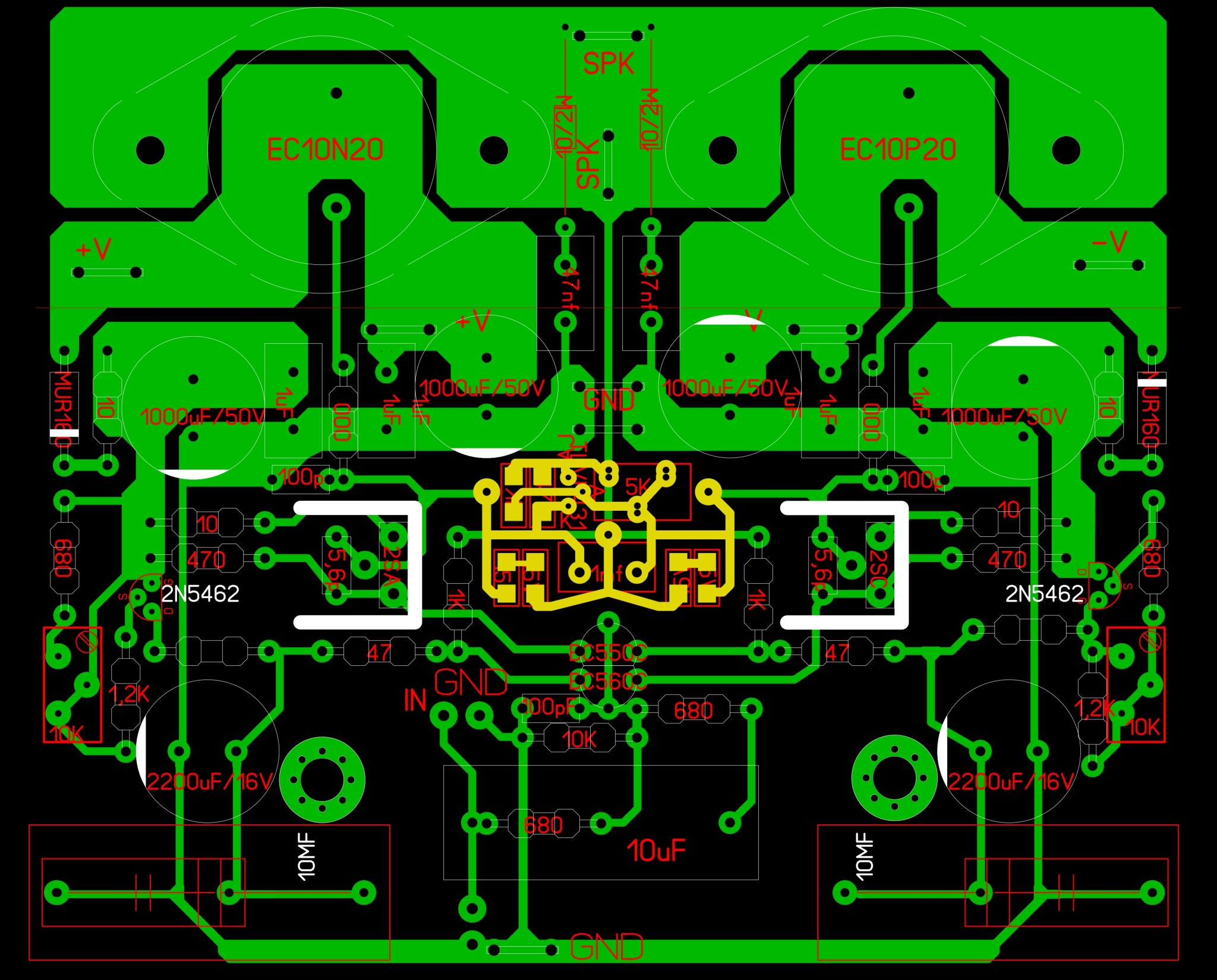

VSSA Lateral Mosfet Amplifier (lazycat) with EXICON
VSSA AMPLIFIER WITH EXICON LATERAL MOSFET
PCB is available

I really try to learn about measurements. I bought somethings for its. But definitely I can say about that amp, it is really warm detailed and airy sound. Especially the fact that it is as quiet as an ant impresses me a lot. there arent hum etc on speakers. If you wonder spec you can look @lazycat vssa amp project on diyaudio. Because this amp has already cloned his project with new components.

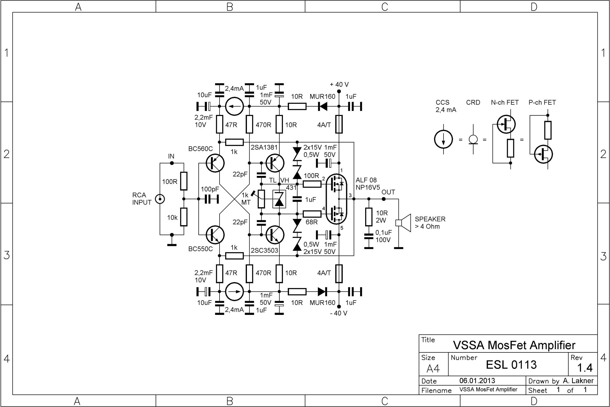

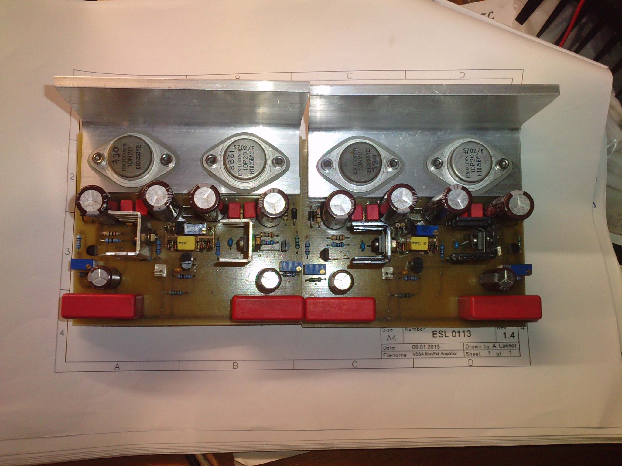

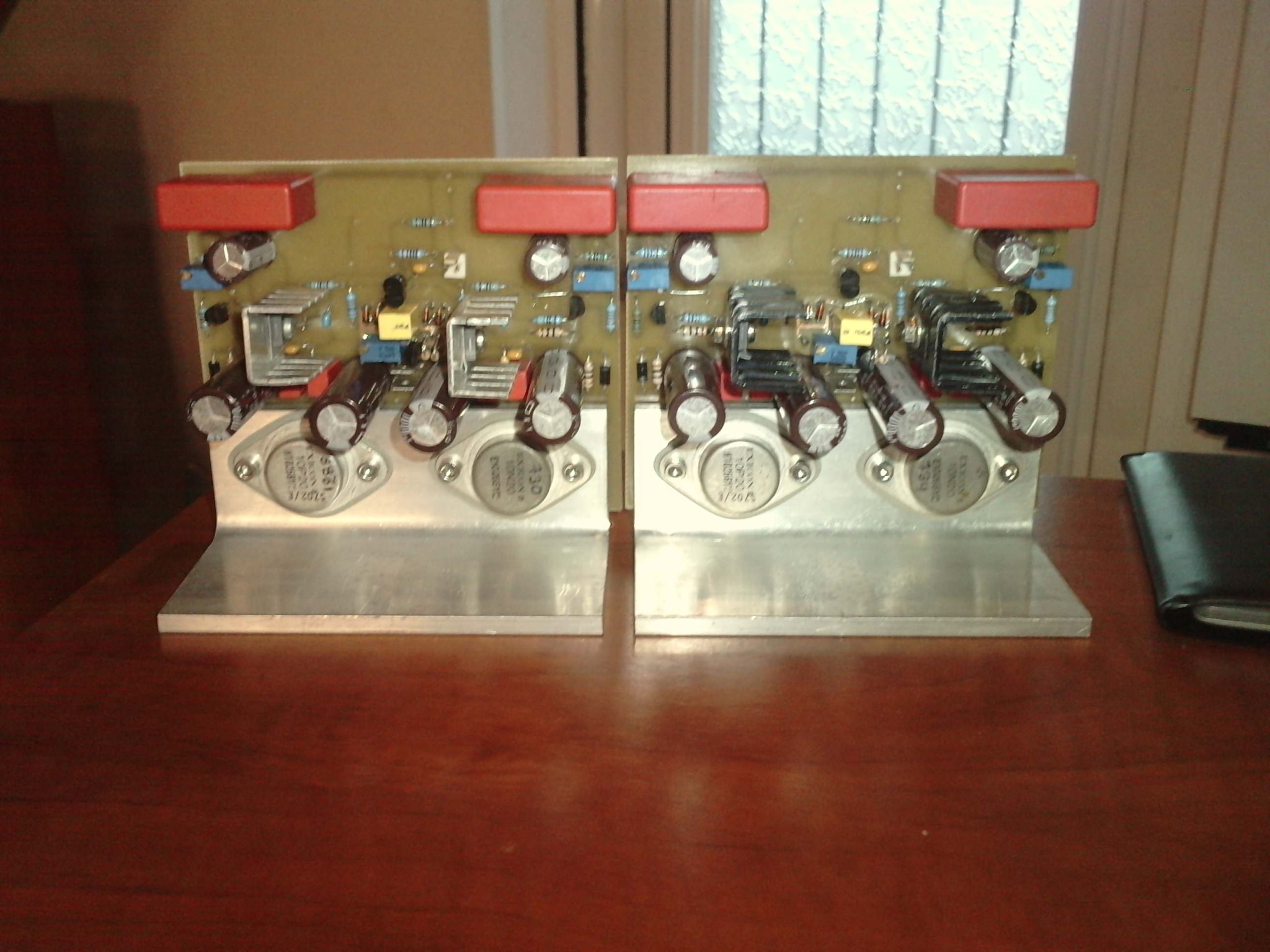

Yeah there are several VSSA versions available on the forum….I did my version too many years ago at about the same time as Lazycat…
I was just highlighting that not only Lazycat offered a “VSSA » type amplifier (replaced later on by his First One). You can also look at TSSA from Sonnya. XRK also presented his VSSA version too for example.
